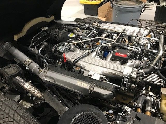

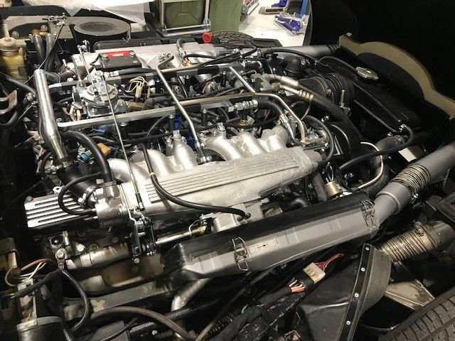

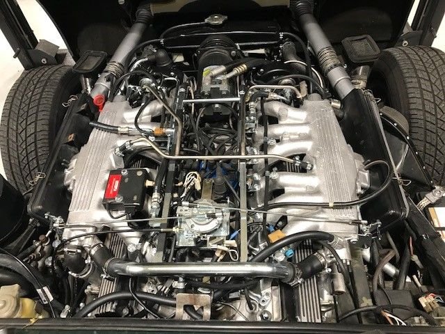

I planned the same project. But I backed i down to installing EFI on the original rebuilt 5.3 engine. I have a new 6.0 v12 intended for a XJ40. But I found that there are a few changes to the timing chain cover casting as well as a different oil pan. I got as far as finding a E-type oil pan, the 6.0 induction system, and the right ECU but then backed down. The 5.3 had already modified to a 9:1 compression ratio, and the 1988 XJS induction, ECU and harness fit nicely into the XKE. So the 6.0 parts went back on the pallet rack and I'm enjoying my as-it-should-have-been 5.3 EFI XKE.
