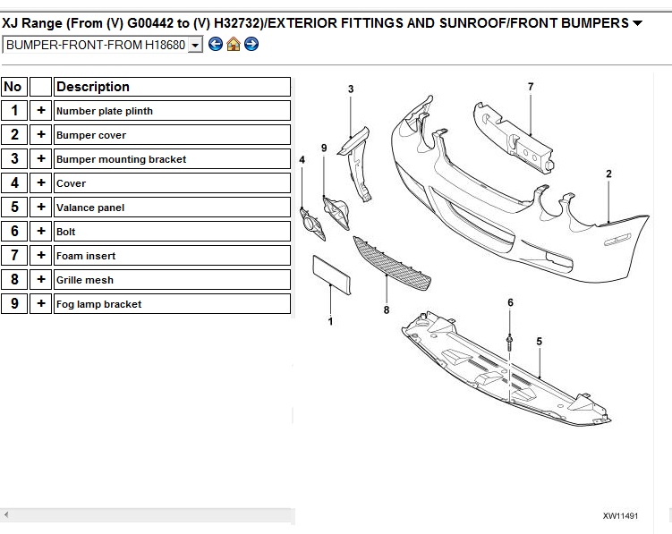

I don't even know what this part is, but it is under the main grill, either side of the AC intake, and inside of the lower light set. The left side decided to go missing one day and I need to replace it. It seems to be a gray translucent plastic (car not here at the moment) and would appreciate an American English part description, and possible sources, if there are any available.
Old Feb 23, 2013 | 03:59 AM
There's a change of Front Bumper assembly at VIN H18680
To H18679:
From H18680:
If you can identify the item number on the diagrams, I'll get the Part Number for you.
Attached Thumbnails 2004 XJRS front spoiler parts-x351-front-bumper-early.jpg   2004 XJRS front spoiler parts-x351-front-bumper-late.jpg
Old Feb 24, 2013 | 08:41 AM
pearlfisher's Avatar
Posts: 83
From: Houston, Texas
Default Possible part identification
Thank you for the excellent reply and the swiftness too.
From looking at the expanded view, it looks like Cover #5, which as far as I can tell is a snap on part.
Old Feb 24, 2013 | 09:30 AM
Posts: 83
The Vin on this is G189xx
Old Feb 24, 2013 | 11:06 AM
Yes - that looks to be the Cover (item 5).
There's a change of Part Number for these Covers within the early Front Bumper listing and your VIN is going to make it C2C4657:
There's no clips listed in the Parts Manual so it should be a snap on part.
