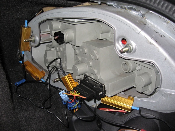

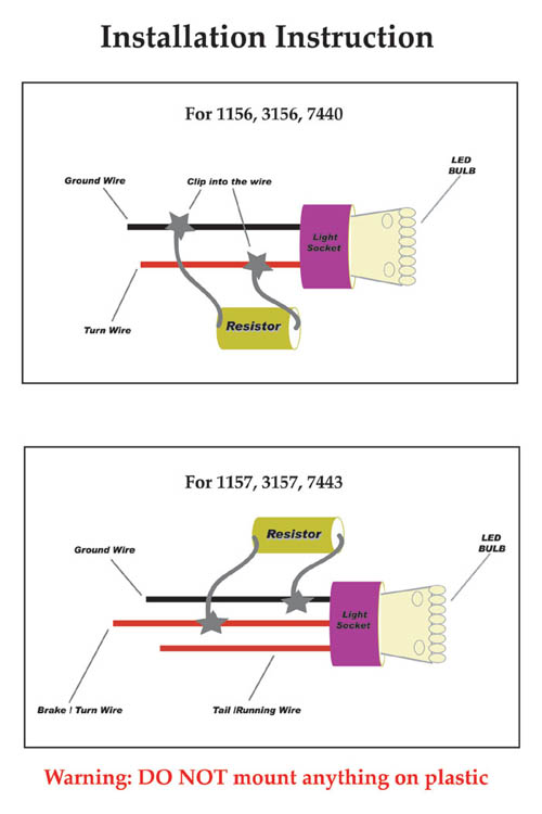

Resistors
I mentioned the need to install a load resistor above, and when you replace your old filament bulb with an LED, well all of a sudden, the more efficient LED doesn't draw as much voltage as the previous bulb did, and the computer thinks the filament bulb is broken, resulting in the pass thru of voltage. To combat this, a load resistor takes the place of a filament bulb, and to be honest, I don't know which size works best, but I know I have both 6 ohm and 10 ohm resistors, and both work equally well.
To install them, you simply put one end of the resistor on the bulb's "hot" wire, and the other goes to the common ground. Which end of the resistor doesn't matter, so you can't screw that up.
Only bad thing about the resistors is they heat up significantly, and they heat up fast! I can only guesstimate on the temps these things get up to, and I want to say over 150 degrees Fahrenheit or more, which means burn-baby-burn. I got a small blister from trying to move one while it was being charged, and then it also is at a temperature which will melt the plastic, so be careful where you install them. In my case, I used double sided tape, which actually hasn't 'melted' on me, and secured them to metal housings adjacent to the cover plate. See this pic below.
So far, over 4 weeks of use has resulted in no signs of plastic deformation of the cover plate. For the actual resistor diagram that I used for my rear tail lamp housing w/ turn signal, see this thread here that I completed quite a while ago.

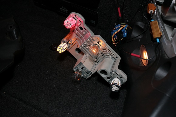

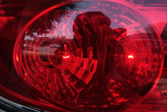

Here is a pic of the original filament bulbs next to the LED (Bulb F). Camera exposure was the same, you can see the difference.

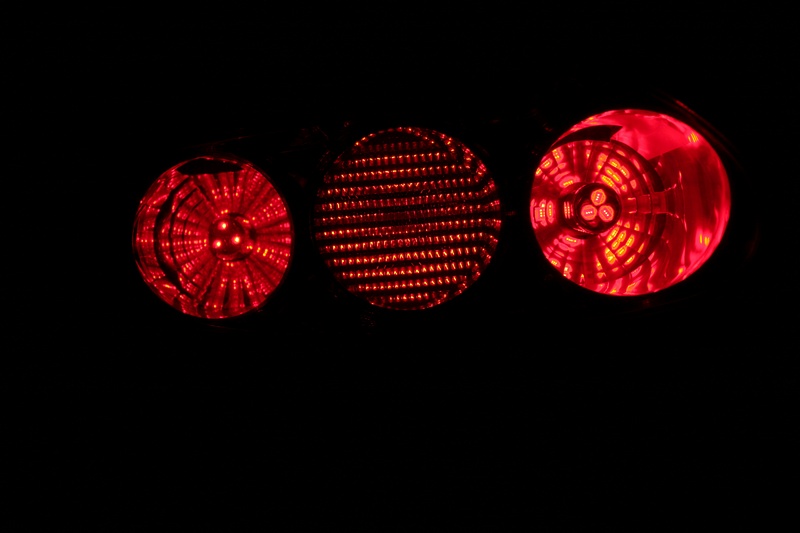

Here is a pic with the marker lights on - no brake applied. Right LED, Left filament bulb.
Since I had a lot of the 1156 bulbs left over, I used the really bright SMT (Bulb B below) in the rear fog location. This bulb is not monitored by the car, therefore, no resistor is needed to use this bulb replacement.
Here is the car with the brake applied and both left and right LEDs (Bulb F) installed.

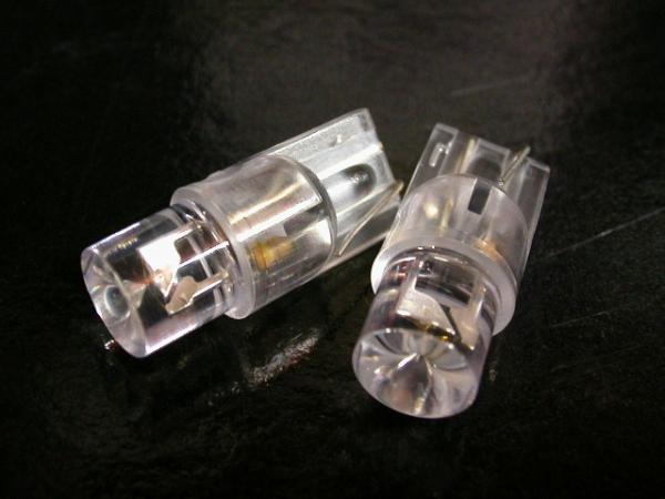

Types/Styles of LED Bulbs Tested
So, you want to know which styles are out there, just type in LED 1156 or 1157 on ebay, and you'll come up with pages of LEDs for your automotive needs. It has been written in many locations, that the color of LED you should install, should match the color of the lens. That means if you want a brake bulb in the red lens, you should get RED Led output bulbs. The turn signals, should obviously be AMBER, even though the lenses are clear. So you want to know which ones worked the best for my car? Well, let's look at what I tested out, shall we? In this table, I will summarize the advantages and disadvantages, and then give either an EX, Good, Poor rating for both uses as a Turn Signal or Brake Light Replacement.
__________________________________________________ ___________________________________________
Bulb A - Luxeon
Click for Larger Pic
These were by far the most expensive bulbs that I tested, and one of the first ones that I purchased and installed. Light output on these were among the highest, but unfortunately, it consisted of one single LED bulb, and that bulb overheated within 15 seconds at full intensity, resulting in auto-dimming to protect itself. It also did absolutely nothing in the reflector in either the turn signal location or brake lamps.
Turn Signal: Poor Brake: Poor
Bulb B - SMT Sides & 3 Front
By far, this bulb is one the most useful design. It has a lot of side lighting, I would say about 25% more than the 3 SMTs on the end. Fills out the reflector very well, but needs more LEDs on the end, and a little longer to make it a perfect all around performer.
Turn Signal: Excellent Brake: Good
Bulb C - 3 SMTs Front
Click for Large Pic
This bulb doesn't really have a place anywhere, as all of the light output is at the end, and nothing gets to the reflector. Similar in performance as Bulb A, but at least this one didn't overheat when in use.
Bulb D - SMT Sides, 5 LEDs Front
This was the best design that I saw, lots of SMTs on the sides, fairly long enough, and the 5 LEDs in front made it eyecatching to drivers. Only problem was that it did not work in my tail/brake lamp socket?? Both sides did this, and strangely, it did work in another socket (the dedicated indicator tail lamp) which I didn't really need. As such, I gave it good grades for both application, but be warned, it may not work.
Bulb E - Small SMT Sides and Front
These bulbs were the priciest, due to the newest technology in LEDs I presume, at $40 + S&H when I bought them a couple months ago. They are equal in performance as Bulb B, but waaaay more expensive.
Bulb F - 18 LED
I liked the design of these bulbs. The flat diodes on the sides really lit up the reflectors, and were much longer than all of the other bulbs. As such, the entire reflector was illuminated, and with the 3 LEDs on the front, it looked almost equal in output all round. This bulb worked well in all applications.
Turn Signal: Excellent Brake: Excellent
Bulb G - 20 LED w/ Bumps
What looks a lot like Bulb F above, it is clearly not. At first glance, the bulb just adds two additional LEDs on the front, and it just as long as Bulb F, so why the poor ratings? This bulb doesn't have flat diodes on the sides; they're bumpy and the 'diameter' of the bulb now exceeds the maximum that will fit in either the turn, brake or tail lamp indicator bulbs. Booo on this manufacturer for duping me!
Bulb H - 36 LEDs
This bulb design was one of the first ones to be released, put several circular rows of LEDs along the length of the bulb, add some on the end, and cal it good. The light output was pretty good, only problem here was the length of the bulb. It wasn't long enough to illuminate the rear of the reflector, therefore, did not score well with me.
Turn Signal: Untested Brake: Poor
Bulb I - 24 LEDs
Similar to the design of Bulb H above, but this time, most of the LEDs are placed on the end, and some radially firing ones were supposed to fill out the reflector. It failed, miserably.
Bulb J - 45 LEDs
This one is similar to Bulb H, but looks to have an additional row of radially installed LEDs, which should help with the reflector performance. It is shown to be 50mm long, which is almost as long as Bulb F. This turned out to be pretty good, and would be my second choice for the turn signals. Brakes were all-right as well.
Bulb K - Five (5) 5W Cree LEDs w/ a projector-type lens on the end.
This one is a new LED design, and has performed VERY well in brake and turn signal applications. It doesn't look as 'circuit-boardish' through the clear tail lamp lens, so that's a plus. It is one of the most, if not the most expensive bulb, however. $47 for a pair of bulbs containing built-in resistors. I've updated my rear bulbs in the XK8 with these for brake and turns, and they are installed in both my front and rear turns in the XJ8.
Here is a video of both LEDs installed. Now, it matches the 3rd brake light exactly!
LEDs both sides - YouTube

Hey thermo, I have read that you need the larger resistors for the turn signals. Is there really any truth to that, or will the smaller ones work in all applications? I ask, becuase they are easier to find mounting points for.

h2oboy, the size of the resistor is kinda trivial really. There are 2 specs that you need to be interested in. First spec is the resistance of the resistor. For our cars, at a maximum you want a 20 ohm resistor. This will be enough combined with the loading of the LED bulb complex to not trigger the fast flash. The other spec is the wattage rating of the resistor. This is what normally determines the size of the resistor. The resistor is going to pass some amount of current through it. You can calculate the power requirements of the resistor simply by squaring the voltage of your car system (typically 14.4 VDC) and then dividing it by the resistance of the resistor. So, ultimately, you are going to need a resistor with a power rating of 14.4 x 14.4 / 20 ohms, or 10.36 watts (a 10 watt resistor will be just fine). If you use a 10 ohm reisistor, then you simply subsitute in the 10 ohm in place of the 20 and you will need a 20.72 watt resistor. The higher wattage resistor is going to be bigger so it can dissapate all that heat. You can get away with say a 10 ohm 10 watt resistor for a short period of time as the bulb is not energized 100% of the time (actually only about 50% of the time), but the cycling of the heat can lead to premature failure. So, get the larger wattage resistor and save yourself a lot of heartache later on.

^ good advice...don't skimp on the resistor! got it. Perfect thread to put this down. I am even going to link it from my prior post dealing with the resistors themselves. As for my project, I think I put the 10ohm resistor on the lead for the brake lamp. The rest, including turn and parking circuits got the big ones.
