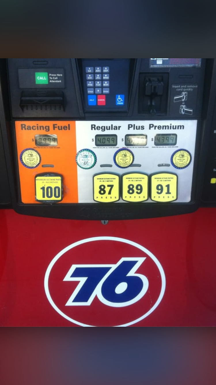

105 octane gas ....
Have you also tried it with ethanol free gas?

I was low on gas after several runs and decided to put some track side 105 in the tank to see if the ecu was pulling any timing on the stock tune. I saw absolutely no difference in 1/4 mile time or speed with the 105 vs standard 93 from a BP.
