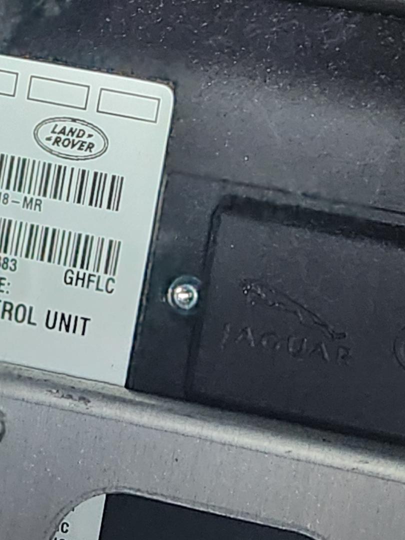

Good afternoon everyone! How do I get this telematics cover off? I have tried an allen 2.5mm but it doesn't do the job. Is it a hex? Let me know... KTG--
. Ideas?

It's a Torx, I think, can't remember the size.

Ah, T10 Torx screw!
