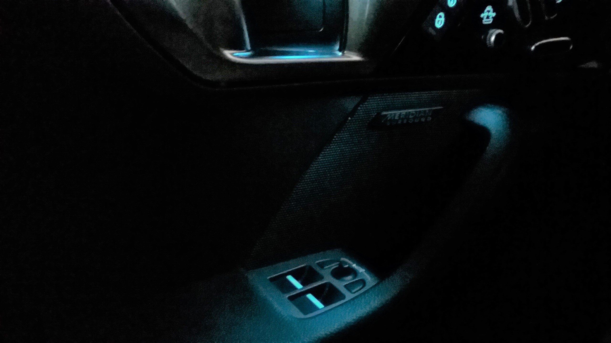

The MY2017 Premium that I bought this past Oct, 2020 started presenting me with low battery charge notice on the day I got it. I thought perhaps since it had sat at the selling dealer for a few months that the car just needed to be driven However, the 150 mile trip home did not change that. Since it is still under warranty, an appt at local JLR dealer revealed a "seeping" battery, now if that was a voltage leak or a liquid leak (??? it's AGM) not sure. Whatever. It was replaced under warranty. and no issues since. I did buy and install the CTek MXS 5.0 connecting it to that main battery in the trunk. I stored it from mid December, 2020 until about March, 2021. Again, no issues. The other 'electrical' issue was the lack of the blue lighting that comes from the LED strip under the interior door handle and one that is under the passenger grab handle. That took a bit of time to get straightened out. The cure in this case (and there have been other cures posted in this F forum) was for the tech to drill down into one of the 'modules' and enable it. There was plenty of discussion here on how an owner could know if that door/pass.handle lighting was supposed to be on the car. Since mine has the LED strips, I felt it was a reasonable assumption that it should have the lighting.. and it's a Premium. I also understand how these cars are made, and that JIT inventory didn't always coincide with assembly. My 69 E was supposed to have a Mercury cell for the clock, but it is one that runs off the car battery. It is what it is. congrats on the car, post a photo for us and have fun!

I've attached a couple of photos from the interior lighting saga.
