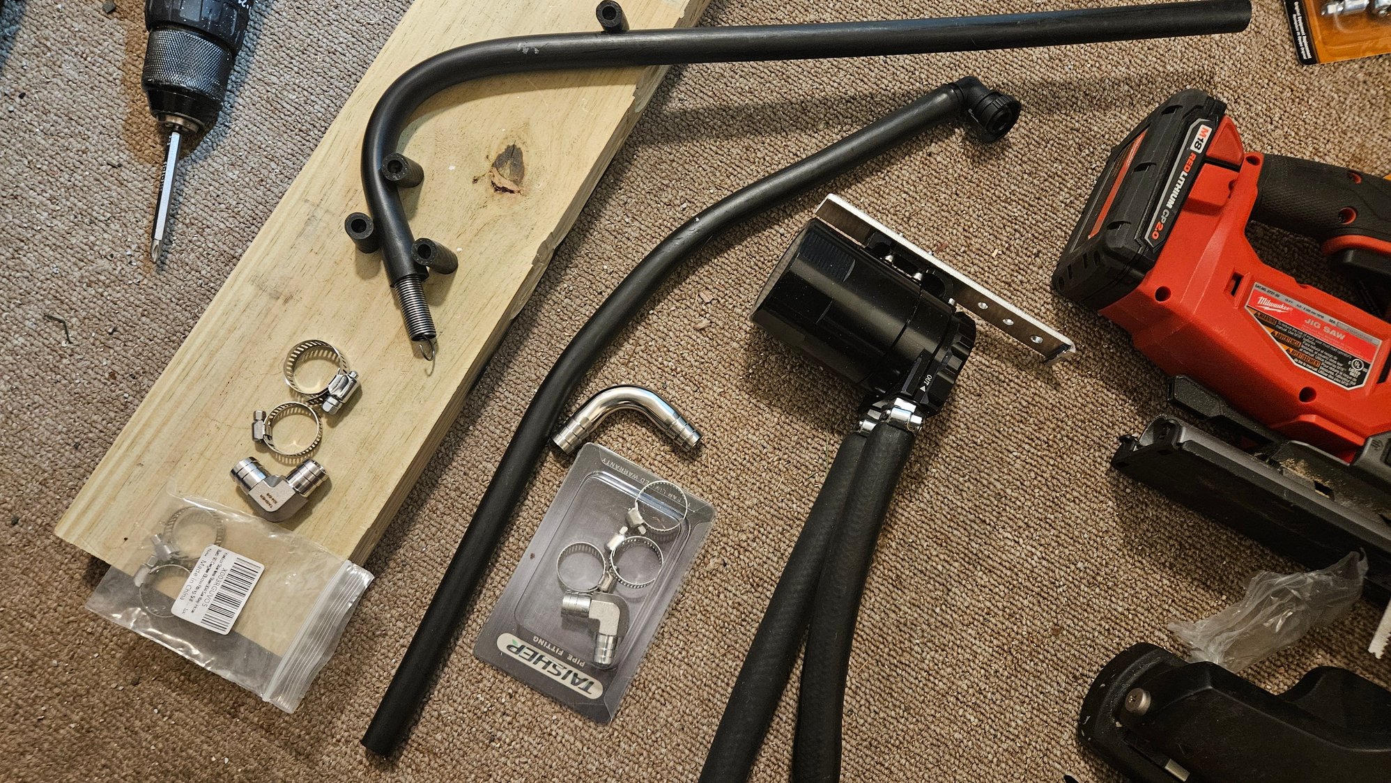

Cool video, it seems commonly accepted that the plastic pipes are good for 50K miles. Mine has only done 32K and keeping inspecting everything under the hood at least twice a month including coolant level.
I'll enquire my Jag specialist next spring to see if they can source and install the metal pipes.

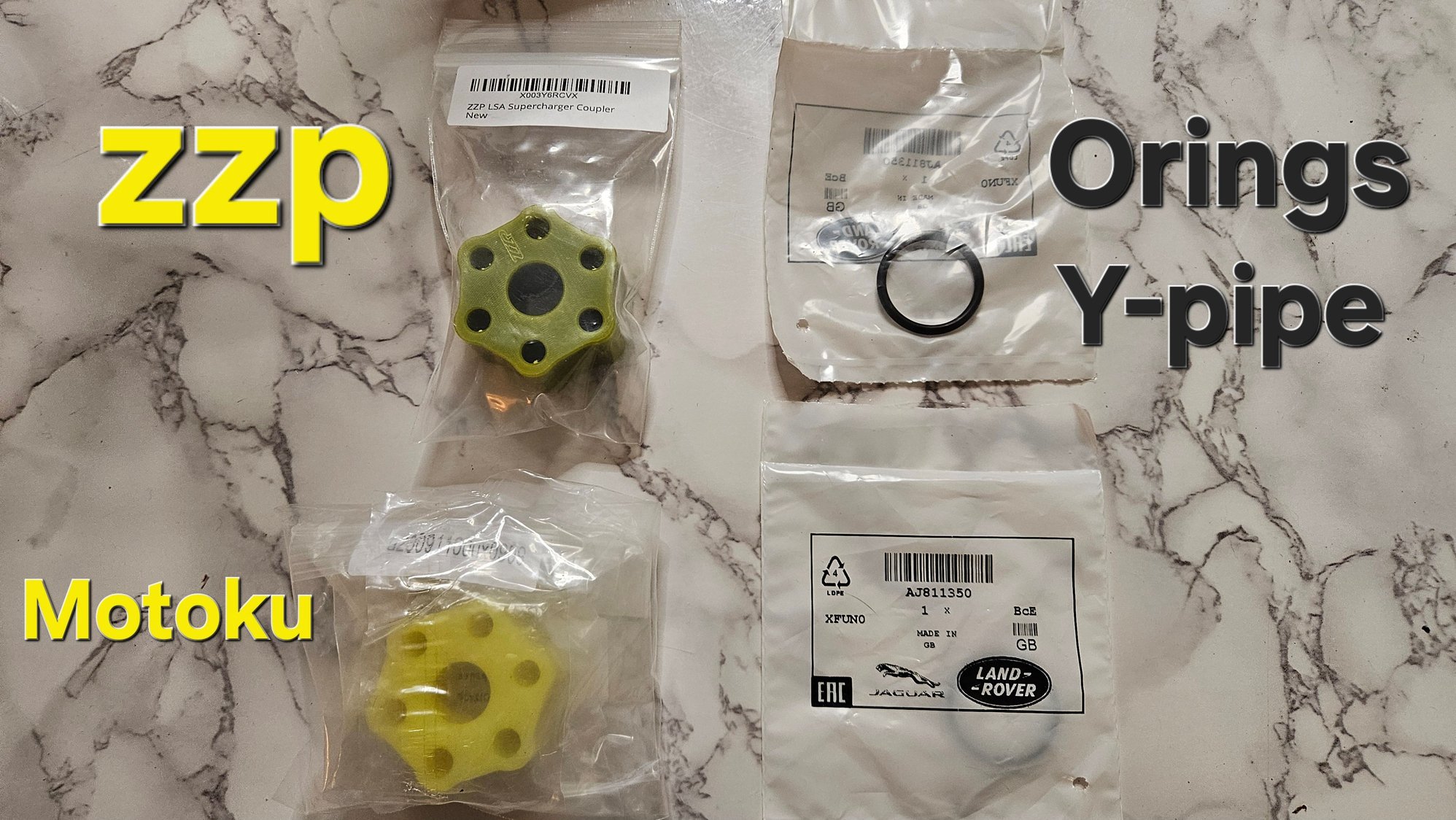

Yes, please do it soon the rear will go with no warning ,the F-TYPE R ,i worked on the owner punched it then found out he was leaking and had it towed to my garage luckily ,i installed it and its been good for a year and a half, while i was there i replace everything including installing a sold coupler his car runs smooth and his engine just purrs

Replacing snout coupler video coming,on my wifes F-type and plastic pipes

That's awesome! I wish JLR specialist garages in the UK would offer these reliability upgrades as an optional service. I know that Wraptor Customs does it but they are a fair distance from me.

Do the pipes all - there is no known "good for" data afaik that is scientific, it is probably a guess - and if you overheat you risk the engine....cheap fix and once and done sort of thing. Doing fluids, filters, plugs and driving with some semblance of mechanical sympathy is the best bet.
I did the pipes, the s/c coupler and fluid and plugs all at once to save on labor (to not repeat the s/c removal...).
