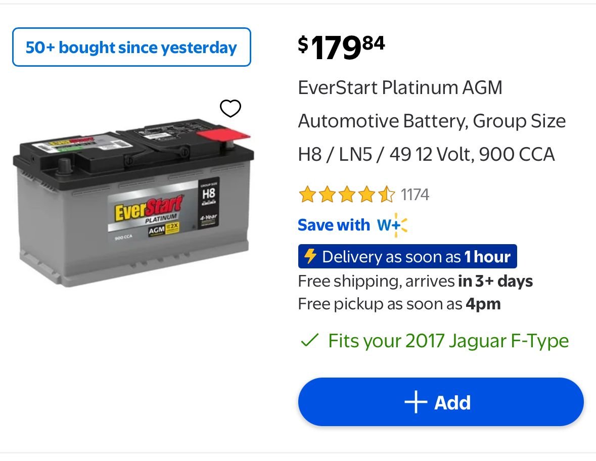

I just replaced mine with one from Walmart at under $200, a direct replacement.

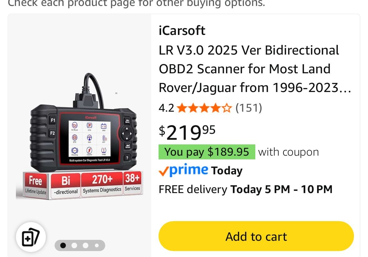

Easy to do, however as another respondent said, you must perform a battery management system update so that the car recognizes a brand new battery. Otherwise it will likely overcharge it and reduce the life.
You need a Jaguar appropriate scan tool like an iCarsoft LR V3.
A dealer will charge you $500 for the battery and another $200 (1hr labor) to install and update the BMS.

When using that odb scanner, have you had issues with exiting out of it correctly?
Old Aug 11, 2025 | 11:34 AM
Simonusa0's Avatar
Joined: Feb 2023
Posts: 71
Likes: 33
From: Farmington Hills, MI
Yes occasionally, but a quick disconnect of the battery for 30 seconds will fix it. always double lock and check that the warning triangle light extinguishes after 15 mins to show the car has gone to sleep.

Thanks for the info on the scan tool. I'll check it out on Amazon.

I replaced the main battery about 18 months ago and then I used my iCarsoft LR V2.0 to attempt to reset the BMS but no go, it failed no matter how many times I tried.
The iCarsoft LR V2.0 definitely has the BMS reset function so my best guess is that the failure was due to the secondary (start/stop system) battery no longer being there as I removed it years ago. Despite this the battery and electrical systems have behaved perfectly ever since, I believe the BMS resets itself after a few drive cycles anyway.
Moral of the story - if you have an early F-Type with the two battery SS system and you have removed or disconnected the secondary battery then it's likely an iCarsoft scanner (and probably any scanner) will not be able to reset the BMS.
