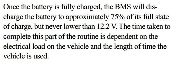

BMS drains the battery from fully charged to some set point (in my case 70%) minutes after staring the car with engine running. So on top of whatever you are working on (ECU, brakes, etc) you have this additional loss of charge.
I will upload a plot when I get a chance. But if I have offended BMS and its enthusiasts, I apologize.

@lizzardo My poor attempt at humor in the current cancel culture!
From the JLR battery tech bulletin:
