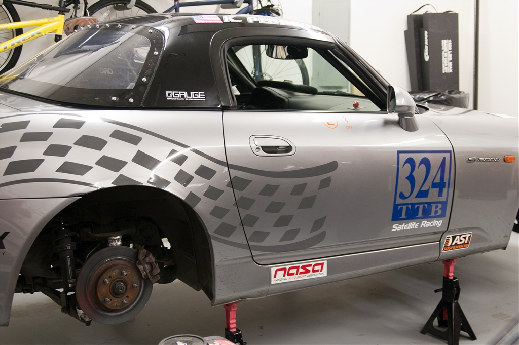

I would recommend against this unless it's a track/race car which sees a higher frequency of maintenance. The reason being is that when you jack up the car, it will put the suspension at full droop. This can allow surface rust to develop on areas of the damper that aren't normally exposed, which can eventually cause increased wear (i.e. those surface rust particles can get lodged when the suspension gets back on the ground).
The reason I mention race/track cars, is that those individuals typically need to have their dampers rebuilt/serviced much more frequently than a street car so it's not much of an issue (and my track/race car lives on jack stands 80% of it's time).

I agree 100%. If I put my car on jack-stands, I do it so the weight is still on the suspension.

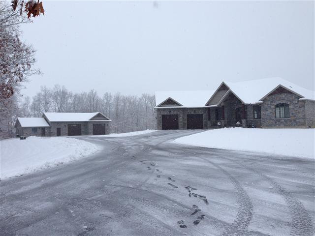

And this is why Bedtime is necessary.....
I need to move.

As I drink my morning cup of coffee gazing through my (open) window at the 70 degree sunny LA November weather, I couldn't help but laugh heartily, like a pirate, at those who are not as fortunate as I.
(just kidding)

This is early, even for us. I'm glad I got the cars away last week.
