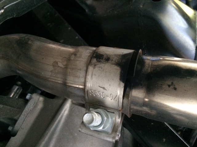

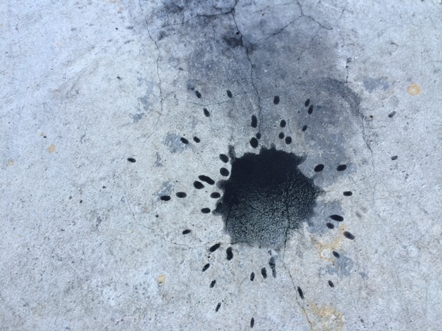

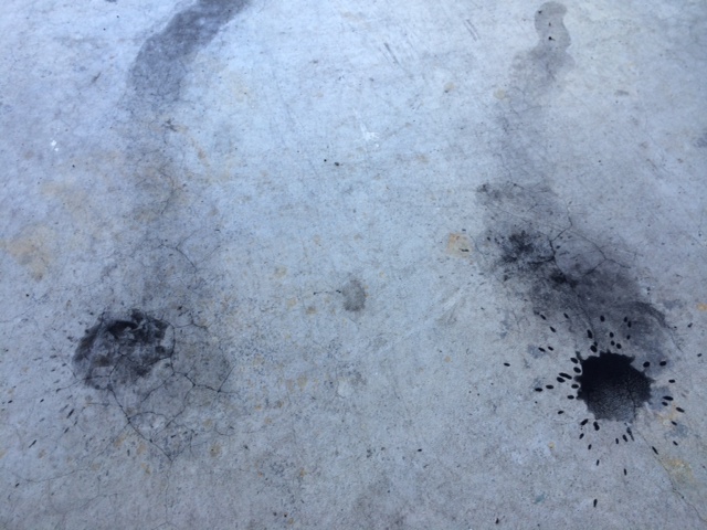

My "R" is leaving black sooty exhaust droplets on my garage floor.
This is not the usual stuff that flies out the tailpipes--I get that. No, these daily start-up drippings come from both inlet pipes (pre-muffler) and pool into a nice black mess. After once again cleaning up the build-up so I don't track it into the house, I tried cinching up the inlet clamps (see pic). Both were already super-tight. I drop the Jag off at my dealer to take a peek. After looking it over, they tell me that they can't touch it due to warranty concerns. What? No reclamping? No heat-resistant sealant? No minor weld in a pinch? Nope. Nada. So I called Jaguar USA. They check around and call me back. "Sorry, but this is normal. The drippings you are seeing are just occurring at the lowest point in the exhaust." They end up telling me the same thing about invalidating my warranty and suggest a drip pan.
I've had my share of vehicles, as have many of you, but I haven't seen one of them pulling this trick. My garage floor is certainly no shining example of Mr. Clean, but come on. Really, Jaguar?
What do y'all think? Any of you have this happening?

I would just use a high temperature exhaust/header sealant like 907GF Severe high temperature. Find someone with a lift and pull the two sections apart and reseal.
Walt
Thanks, Walt. A high-temp sealant was the resolution I proposed to the dealer.

You don't want to plug that. It's designed to run off the moisture in the exhaust system. It could cause the exhaust to rust/corrode if you don't allow it to run off.

Makes sense. The tips are angled up so the water has to go somewhere. It would be bad if the water just pooled inside the exhaust.

--Mulmur, just to clarify, those sooty droplets I described are not coming out of the tailpipes; they are dripping from the clamped connections of both inlet pipes just prior to entering the muffler.
--omgomg, I agree with your statement about being "purposely engineered," concluding now that this is exactly what Jaguar intended. Every factory power-added application I've had (supercharger or turbo) has run rich. Of course, as you say, it's also part of those sweet exhaust pops and crackles.
--Torrid, I've come 180 on this to your way of thinking. Though there is water (and rust) in any exhaust system, Jaguar has purposely designed these inlet clamps to release excessive water. (Perhaps a way to avoid excessive moisture from entering/interfering with the Active Exhaust bypass valves?)
