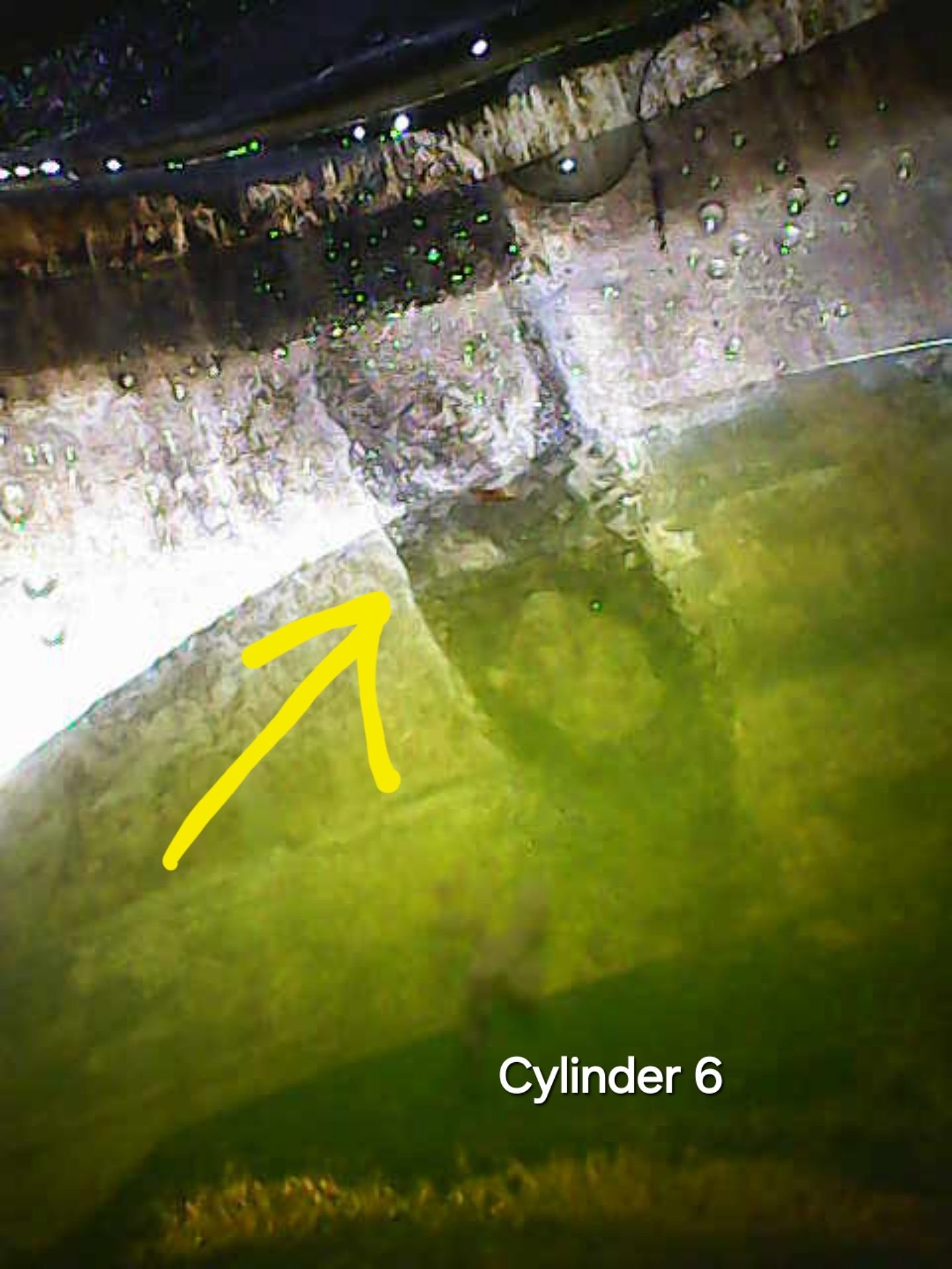

For everyone that is going to ask, yes, it is 100% blown. Low cylinder compression and the coup de grace is the attached video of coolant leaking into the cylinder after pressurizing the system.

Personally, the bigger question is why did the headgasket fail? That's not a documented frequent failure on the AJ126, unless the car loss coolant and overheated. Would you have any addition context prior to the failure?
In any case, it's just a situation of troubleshooting. It's too soon to tell what the issue is until you start tearing it apart. As with anything, there's no real easy answer here and you'll have to figure out time vs $$ for your case.
If a replacement engine was super cheap <$3k and abundantly available with good reputation, then I think an engine R/R could be considered. But at >7K plus, I would do whatever I can do figure out the issue and see what's salvagable. It could literally be just a HG R/R which would be a couple hundred bucks or something else much worse. Only opening things up can tell you.

Yup. Lost coolant pump and overheated and ran overheated for a bit. Had a coolant hose also fail, which makes me think all the hoses are compromised.

Since it overheated, there is a chance the head or block could be warped, but then again it could be within tolerances that a new HG would be fine.
If you have access to a bore scope, I think that could give you some useful data for a determination in which direction to take. If the engine overheated so badly that there's cylinder wall scoring, then yes, perhaps an engine R/R may save you some time. But if your cylinders are still clean, I would advised atleast removing the head and put a straight edge of the head/block. You may have just lucked out and it's all good, then put on a new HG, probably some timing components depending on mileage, and be on your way. Just food for thought.
