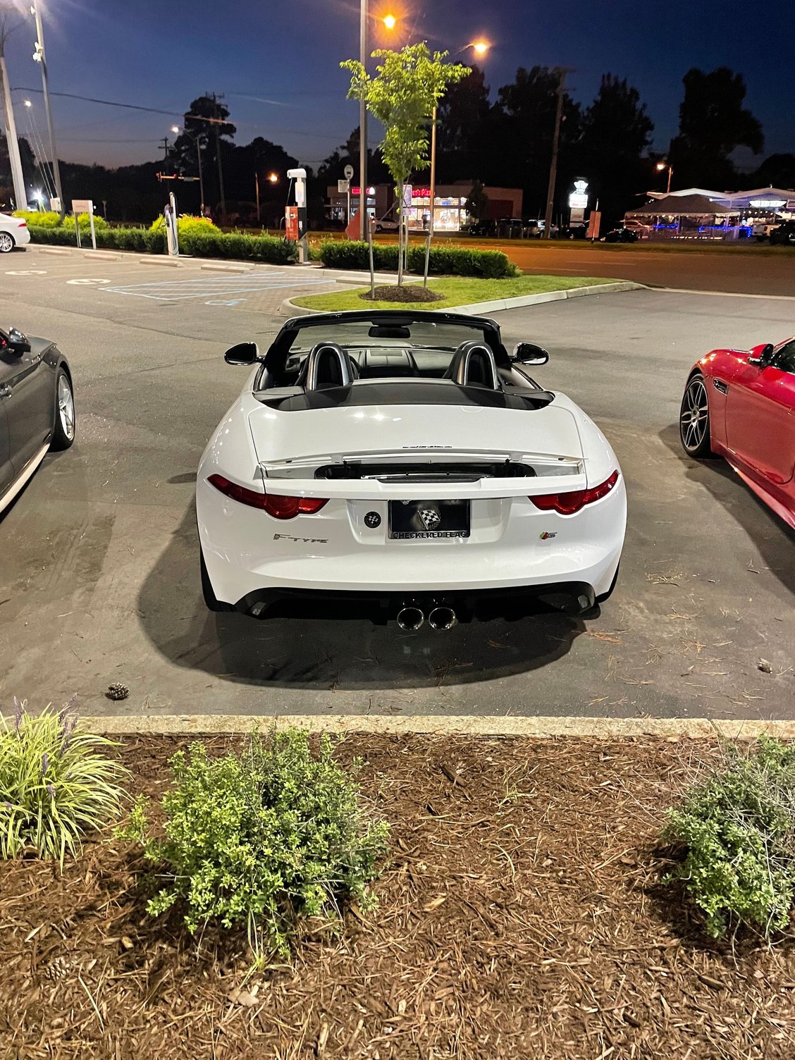

Hey Everyone! I just bought a 2015 Jaguar F-Type-S.
it’s my first jag! It has 34k miles on it. Ans advice or tips for maintenance or things to look out for? I’m picking up the car tomorrow from the dealer
I paid $40k for it
