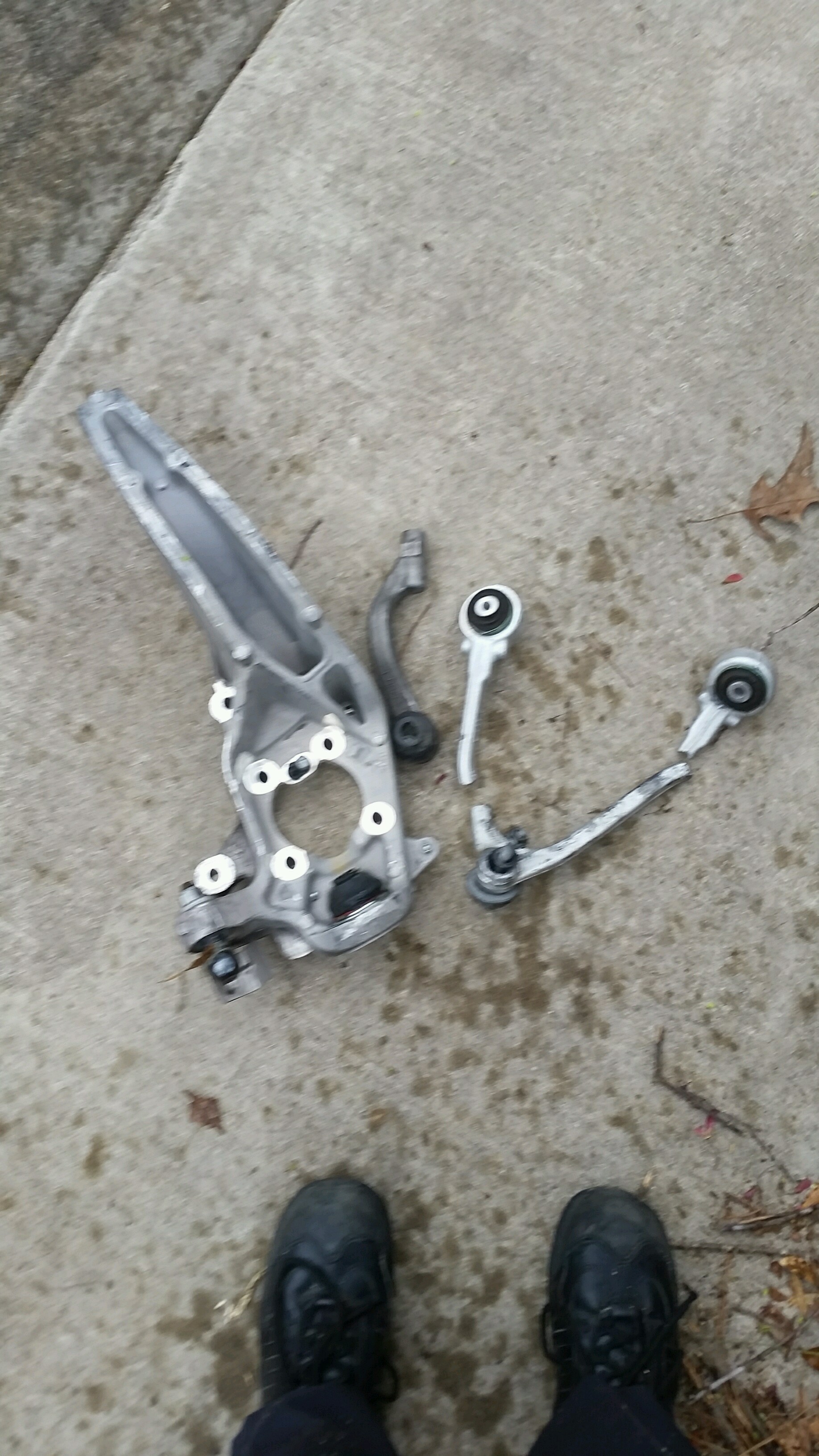

heres a look at the destroyed suspension components
Based on the original photos and this photo of the snapped control arm, looks like this car ended up on a curb.

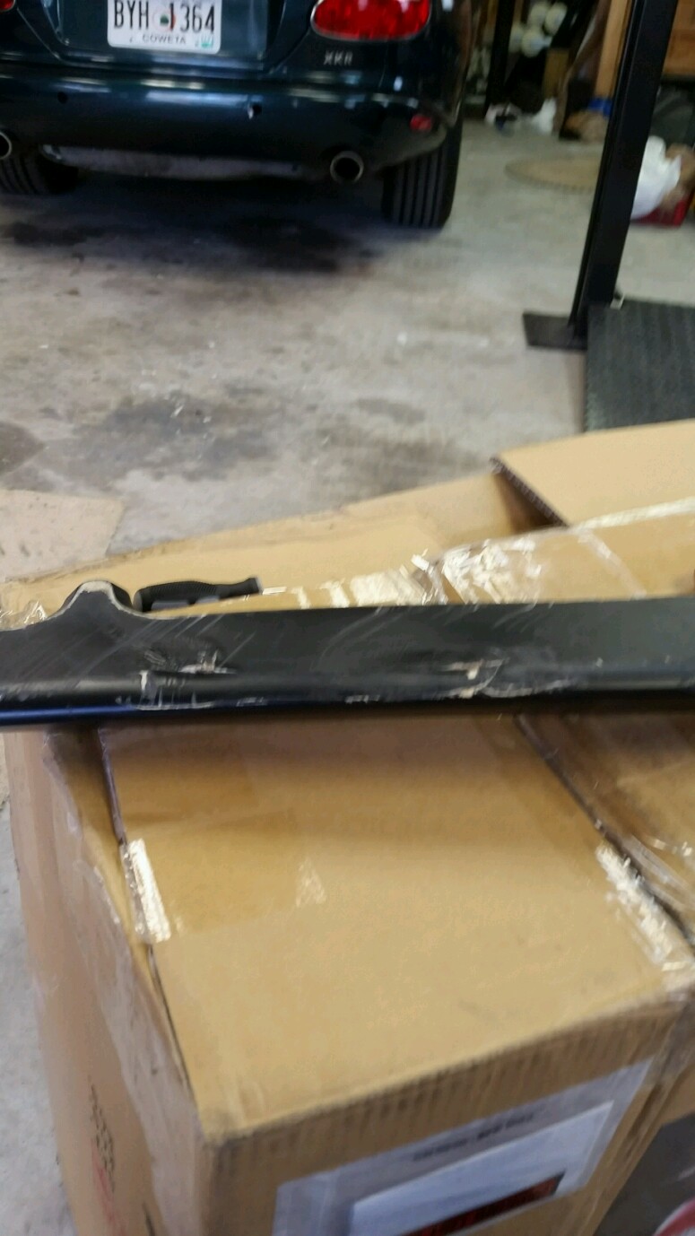

some work I did sunday repaired torn lower rocker moulding with a plastic welder --1 pic is of damage,2 set up,3 used heat gun to reform damage,4 welded rocker .material is abs plastic .different than upper rocker .all I need now is to sand,fill and paint
Attached Thumbnails bought a salvage 2015 v8s-20170305_132105.jpg   bought a salvage 2015 v8s-jaguar-rocker.jpg   bought a salvage 2015 v8s-jag-rocker.jpg   bought a salvage 2015 v8s-f-type-rocker.jpg
