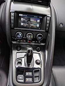

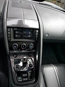

Added the carbon fiber dash panels to my F type R. Bit of a pain fitting the start button and power outlet as the holes needed a little filing to get a good fit. But fairly easy job. Left is the CB ones.

Just be aware that moving the damn power plug on the lower panel is far more difficult than it looks, otherwise this is one of the easiest upgrades you'll ever do.

To remove the power plug first remove the outside switch it just clips on using sliders. Now if u still cant push the whole power socket out (black sleeve, clear sleeve, chrome socket) then you should remove the center chrome sleeve from the middle.
To remove this you can see two square holes inside the chrome sleeve, about 1/2 way down, the clear plastic sleeve locks this into place with 2 notches that fit into these square holes. Use 2 thin, very small flat head screw drivers (like the ones used for watch work) and jam them between the clean plastic sleeve and chrome sleeve where the square holes are on the inside. You can now push the center chrome sleeve out. The Black plastic and clear sleeves will push out easily. Doing this will save u damaging the out black sleeve and its locking clips.
This is how I did mine.
