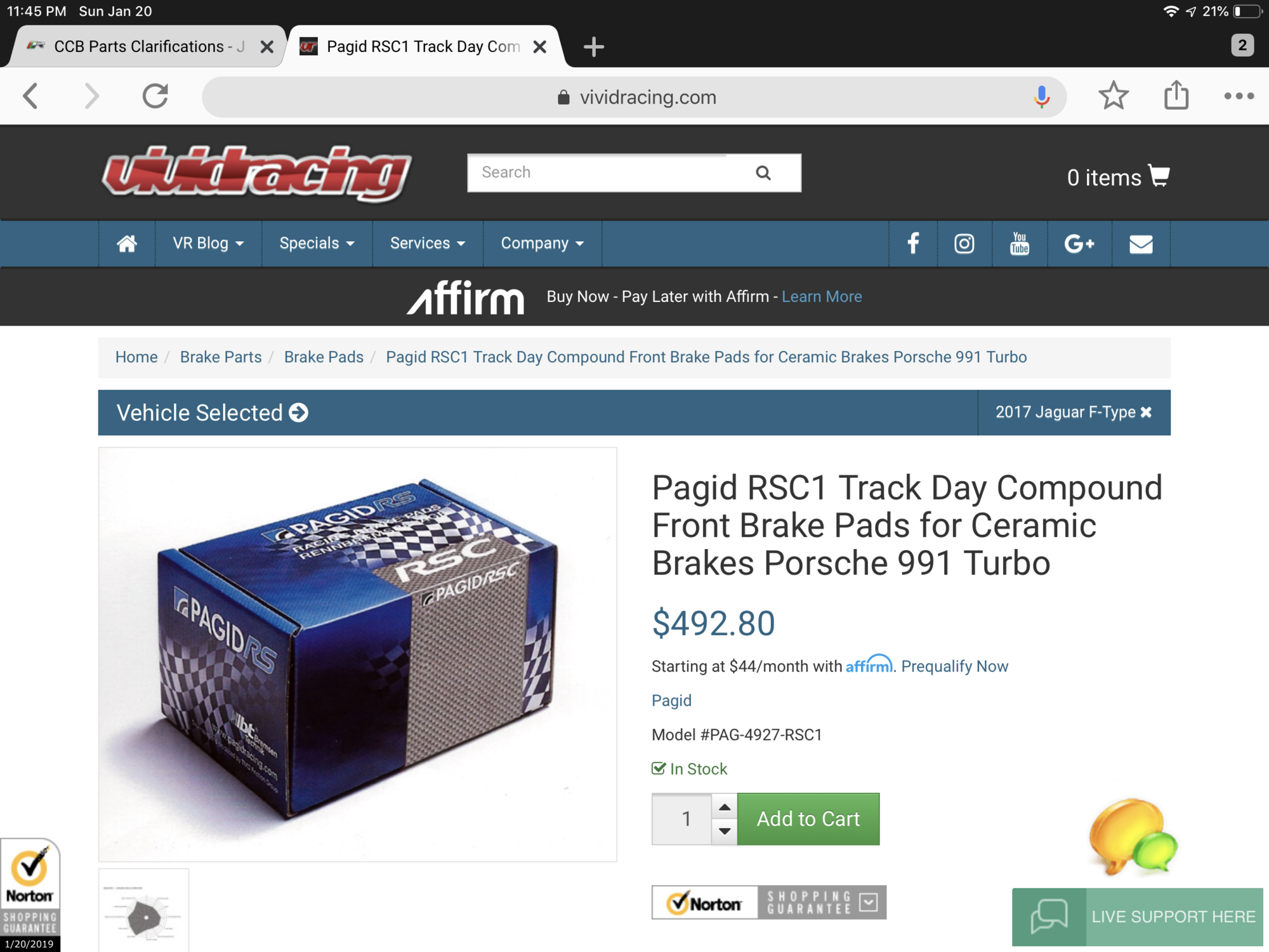

The PAGID RS1’s are $495.00 for the front on the Porsche 911. I would think that is the standard price for them. I like $1,000.00 more than $2,800.00 for sure. I thought I read here that it is a good idea to replace them before they are half way worn. I would have to go back and find that but I recall that as well.
