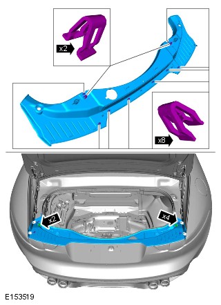

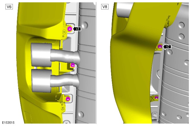

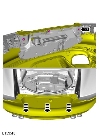

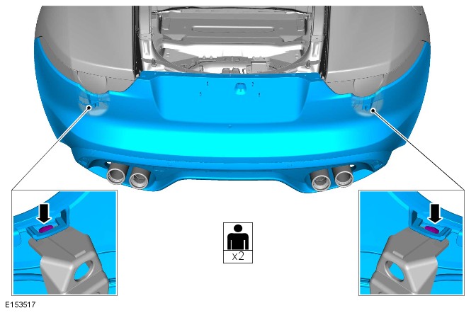

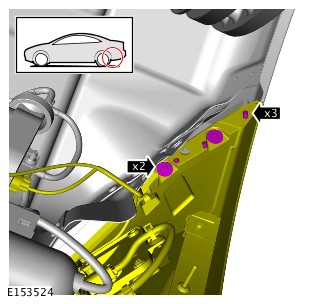

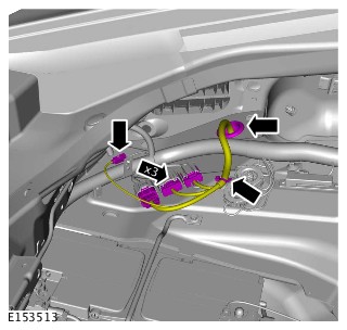

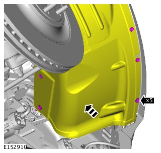

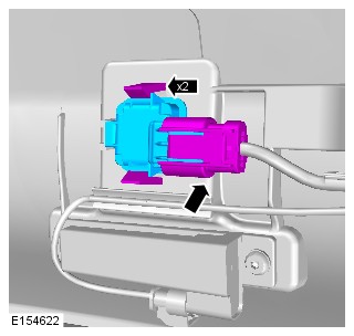

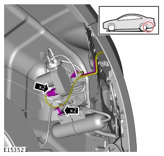

You must remove bumper cover to access camera. no real easy other option to access due to where is located in relation to bumper reinforcement.
REMOVAL
NOTE:Removal steps in this procedure may contain installation details.
  1. WARNING:Make sure to support the vehicle with axle stands.
    Raise and support the vehicle.
  2. NOTE:The procedure must be carried out on both sides.
    Refer to: Wheel and Tire (204-04, Removal and Installation).
  3. NOTE:LH side only.
    Refer to: Loadspace Trim Panel (501-05, Removal and Installation).
  4. NOTE:The step must be carried out on both sides.
  5. NOTES:
    • The step must be carried out on both sides.
    • Make sure that the component is installed to the noted removal position.
    Torque: 4.1Nm
  6. Torque: 4.1Nm
  7. Torque: 4.1Nm
  8. CAUTION:Take extra care not to damage the component.
