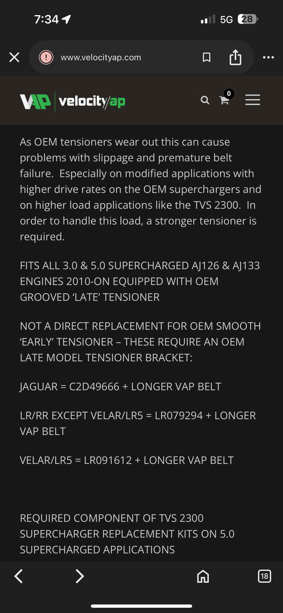

C2D49666 is the newer bracket which also comes with a newer style groove pulley, which is really no use to us at this point because we’re putting on the velocity AP pulley.

Hey everyone,
I’ve been working on upgrading the supercharger belt tensioner setup on my 2015 Jaguar F-Type R (5.0 SC AJ133) and could use some insight from those who may have tackled this before.
I recently ordered a new OEM Jaguar tensioner bracket assembly (which came with a fresh tensioner already bolted on). Out of curiosity, I unbolted the tensioner from the bracket, and noticed that the divots and guides on the back of the new OEM tensioner match my original factory unit exactly.
Here’s where I’m stuck:
When I try mounting the VelocityAP tensioner onto this new bracket, I’m still seeing the same odd angle that looks abnormal — almost like the pulley isn’t sitting flush. It makes me wonder if buying the new bracket assembly was redundant, because I’m getting the same result as before.
I’ve already purchased the longer VelocityAP belt for the upgrade, but before I go any further, I want to make sure this setup is correct. Has anyone else experienced this same issue with the bracket/tensioner angle when using the VelocityAP upgrade? Did you find a workaround or was there something specific about the installation I might be missing?
Any advice, photos, or firsthand experience would be hugely appreciated. I’m hoping VelocityAP can also chime in, but I know a lot of you have been through these upgrades and might have the exact insight I need.
Thanks in advance for the help!
Hi Austin. I would recommend reaching out to us at VAP if you have any questions or problems before ask people here who don't have the answers for you. Before you go to the trouble of producing a whole video about it.
Our supplier made an error on this production run, apparently there is a back section which is very similar to another tensioner they produce and they assembled with the wrong parts. Our shipping department sent out emails to everyone who we shipped a tensioner to this week, notifying them of the issue, and informing them of next steps (we are trying to arrange collection to exchange.) Please check your emails or reach out to shipping@velocityap.com with your order number and Cassandra will facilitate this for you.

After a two week turnaround for the backplate change out due to the earlier manufacturing issue, I finally received my new tensioner pulley.
As soon as it arrived, I compared it against the previous pulley, sizes and mounting plates were virtually identical. Because they matched so closely, I realized the OEM bracket I purchased wasn’t even necessary. I went ahead and installed the pulley using the original longer belt without testing the shorter belt. After the install, it became clear that the shorter belt would have been far too tight and caused more problems than it solved.
That means I ended up buying parts, the OEM bracket and shorter belt, that I’ll now have to return, completely unnecessary in the end.
The good news, once everything was mounted, I drove the car all last night, and it seemed to be stronger and harder than before, with zero belt slippage. After about six weeks of downtime, I’m finally back on the road and couldn’t be happier with the results.
I will continue to do testing from 0 to 120 miles per hour somewhere in Mexico to confirm that everything is working and shifting correctly without any slippage. After I complete these hard pulls and confirm that the car is no longer having the issue I’ve been experiencing in third gear at the very top of the RPMs, I will go ahead and install my transmission tune. I’ve had the tune since the beginning of the year but have been waiting to put it on because I didn’t want to add any upgrades until this issue was resolved. Hopefully, this is the resolution.
So far, I am very satisfied with this new pulley, and I thank Velocity AP for the assistance in correcting the issue.
Hi Austin,
The OEM brackets are not the same, hence why Jaguar themselves don't supply just the tensioner if you are replacing the early, smooth pulley tensioner with the later, grooved style. If you don't want to fit it, that's fine, but I'd expect you to have belt longevity issues. There are some critical dimensions that are different.
