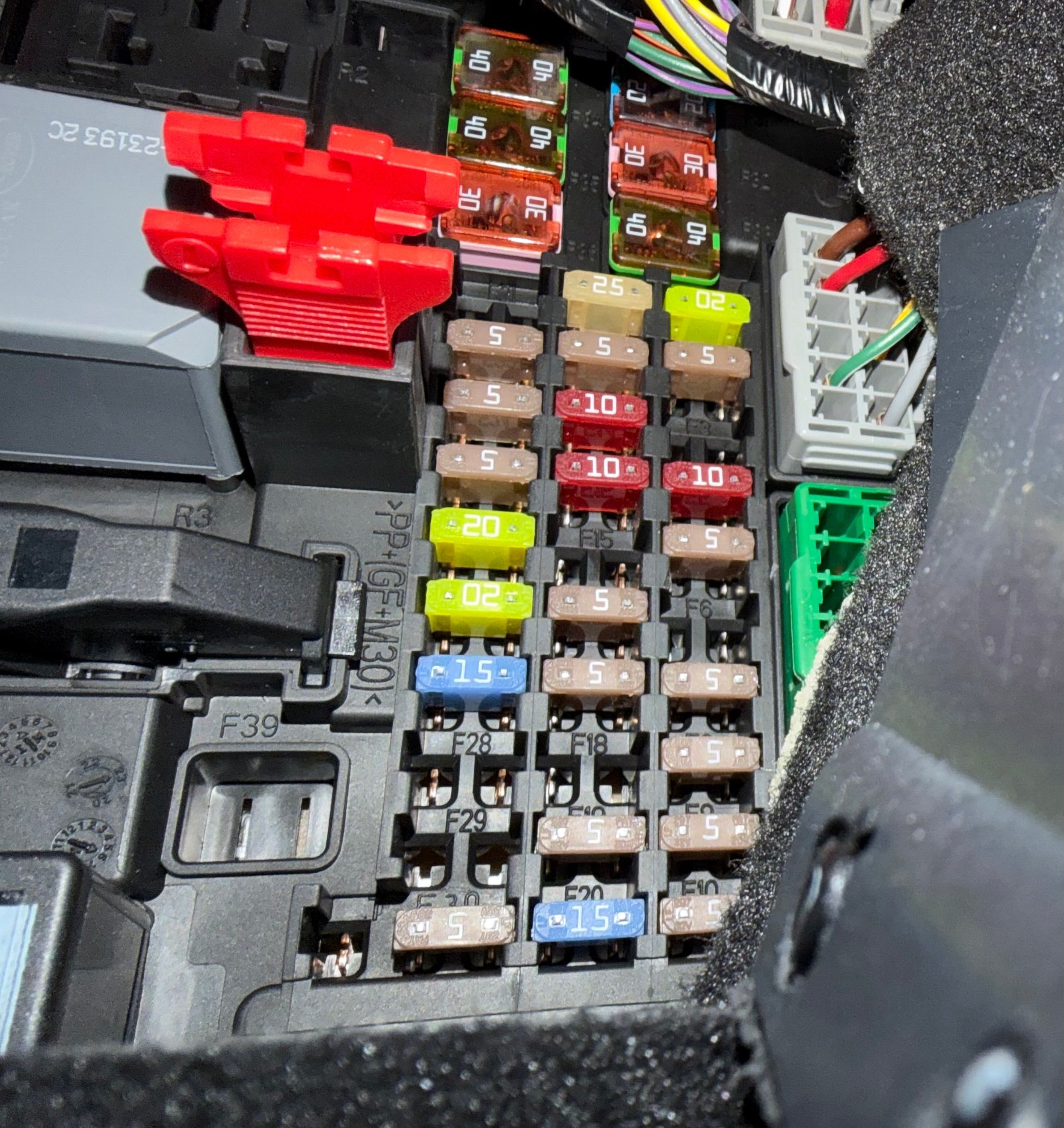

Just bought a VIOFO A119 V3 dashcam and looking for info on which passenger compartment fuses to piggyback onto. Which ones are Battery and which are ACC and which fuse rating to choose? Pic of fuse box attached.

In the passenger fuse box (RHD) I used Fuse No. 3 for constant Battery + and fuse No. 25 for ACC(switchable) - This is 2024 model.
My dash cam is a DriveVision 4k which can be controlled by an App. This allows you to select 'turn off'' when the car is turned off as a default - or not.
It also has an optional rear camera and was quite reasonable at AUD 250.
https://drivevision.com.au/
Not sure if your fuse arrangement will be the same but easily tested with a multimeter and a contortionist licence.

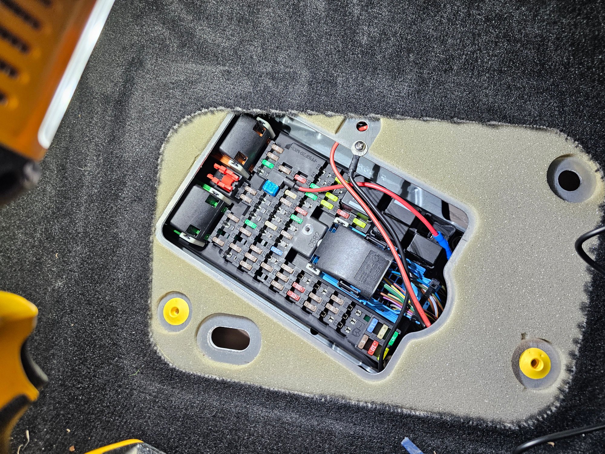

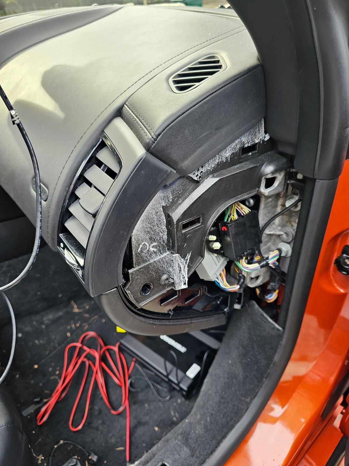

thanks for your replies! Your video was a great help and gave me the confidence to remove the various panels involved. Normally I break this sort of thing. They’ve moved the fuses though! Got it all wired in and working. I’ll watch out for battery drain, the VIOFO cam parking mode has a threshold setting so that it stops drawing power when the voltage drops. Parking mode can also be turned off completely. Now I’ve just got to put it back together!

Many thanks! I know what you mean about the contortionist licence! Your answer really helped as I wasn’t really sure which fuses to use. Got it all working now.

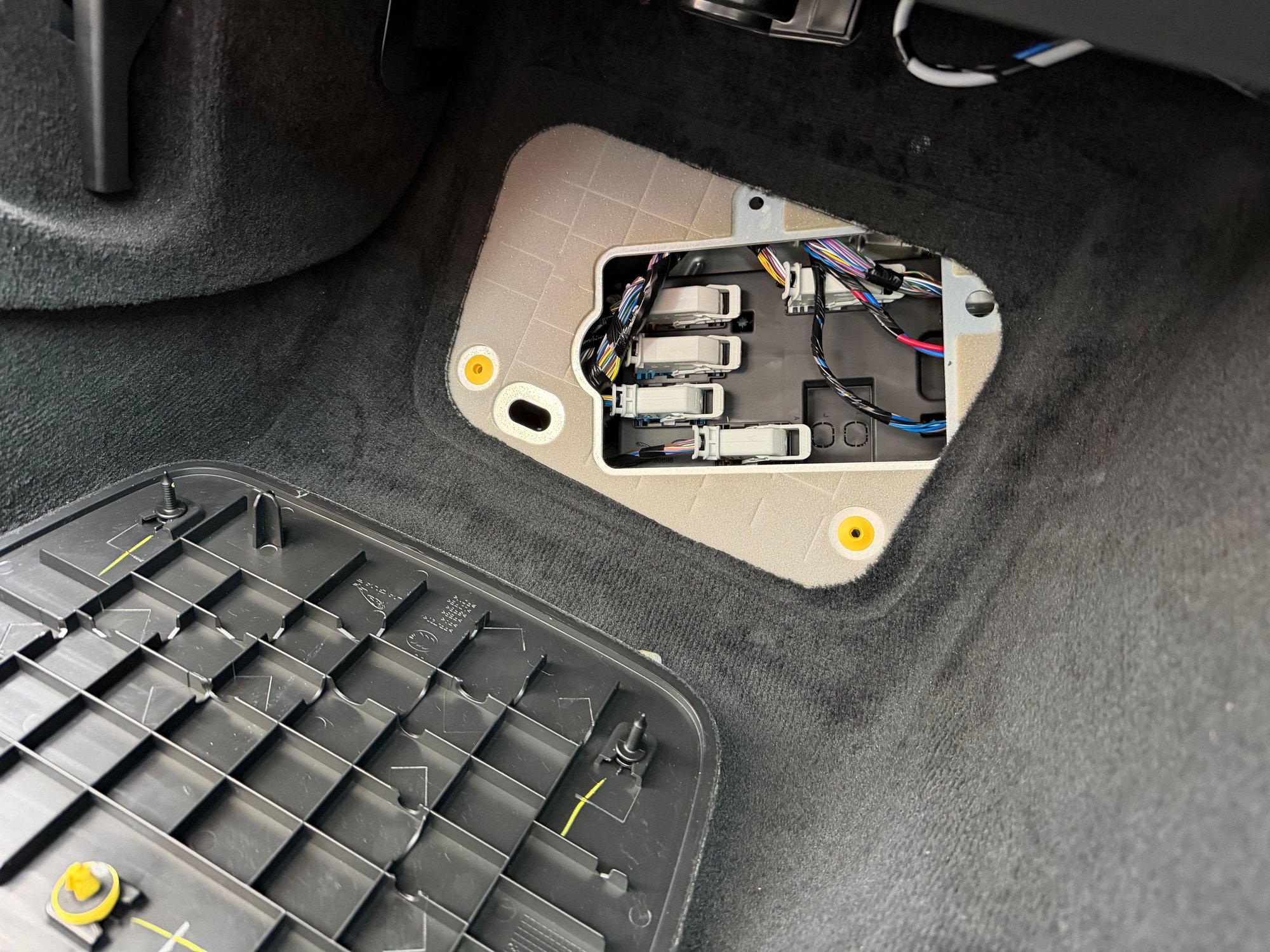

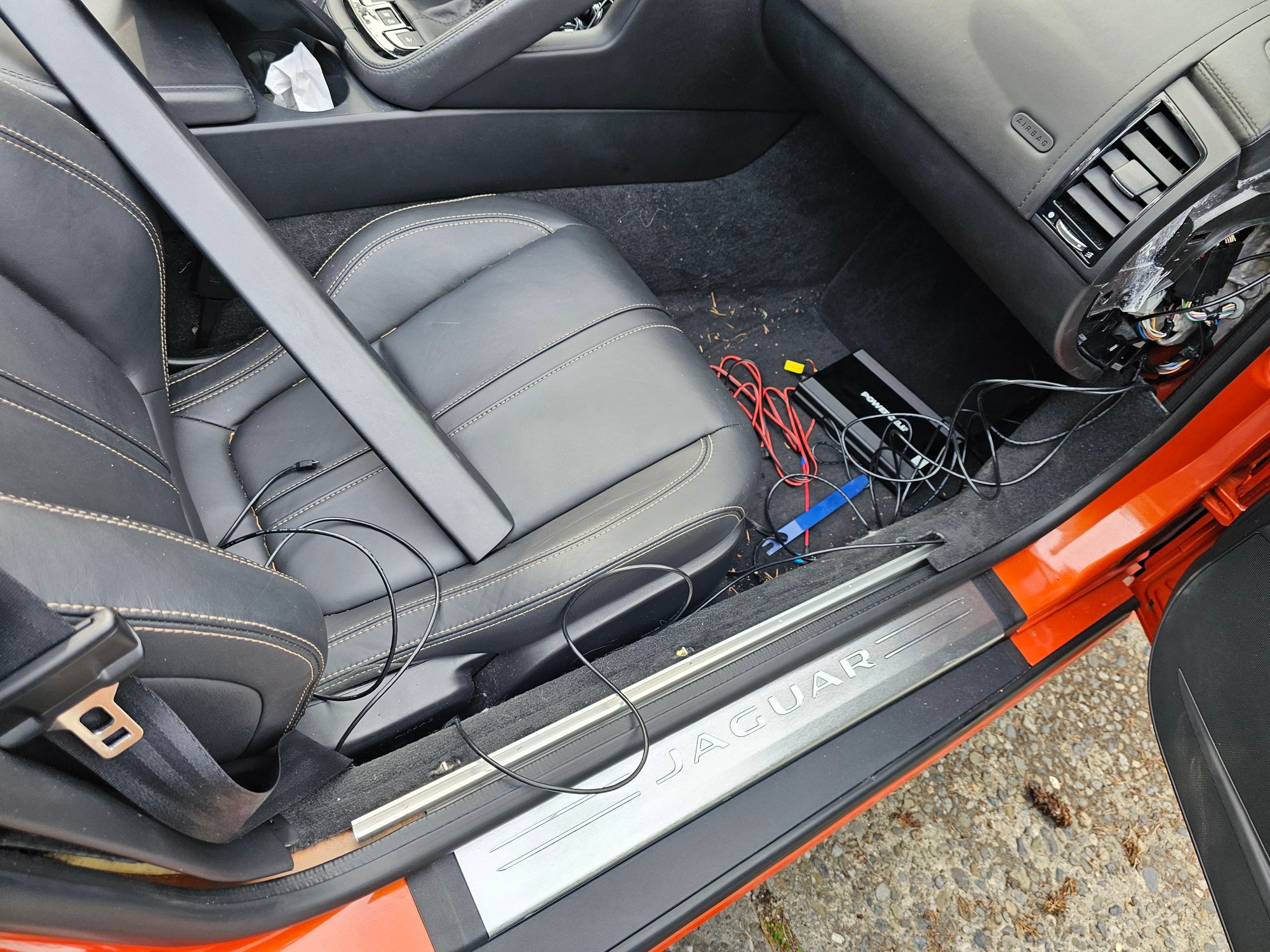

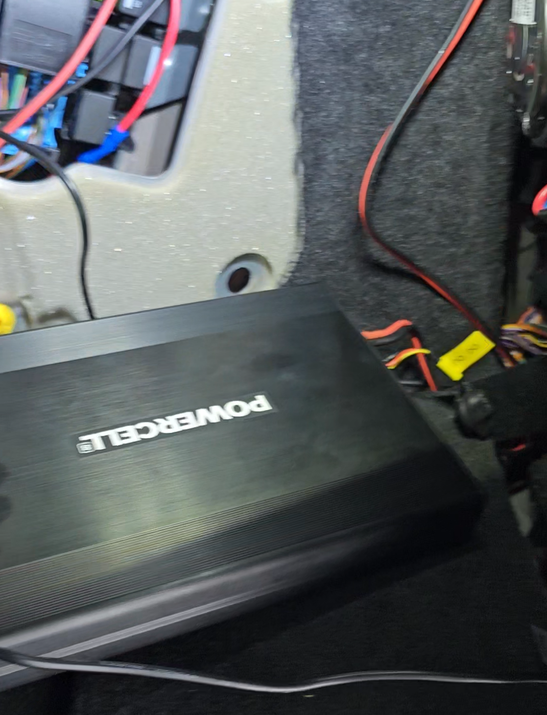

In the passenger footwell, near the door, there is a small pocket.
For Dash cam and security. I wired the camera to the battery. Then tucked the battery into that little pocket.
