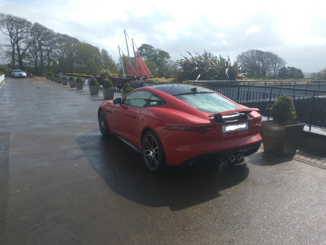

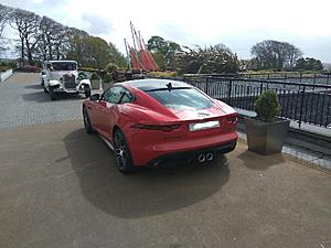

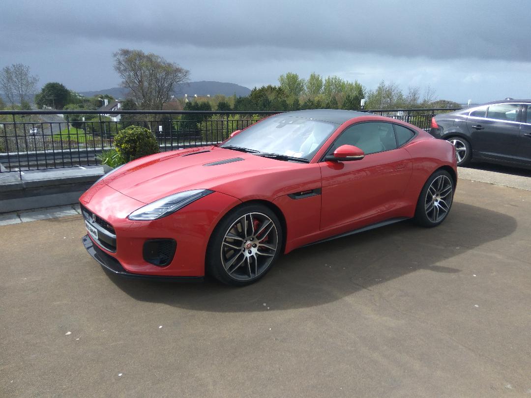

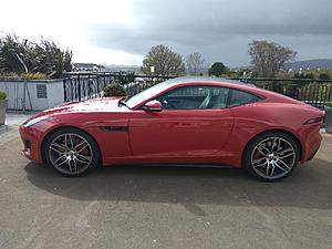

So went for a days drive today in my 2.0 Dynamic, haven't really taken any pics of the car since getting it, terrible wet day, anyway love the car, can't fault it (yet) hope you like,
You may notice the AWD badge under the R Dynamic, reason been i changed all the badges to black and had them ready to swap over when i got the car, it was hard to get all the dynamic badges and i had to buy the rear one from a dealer which came with AWD on it also , so left it on. As you will see also that the new models have side vent badges, i did the side and front in the caldera red with black lettering, the rear black with red lettering, does look good IMO. The rear had the new P300 badge so swapped it for the R Dynamic, P300 sounded like a grade of sandpaper.
One other thing look very closely can anyone spot something different, details to follow.

Different other than the twin pipes?

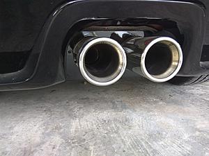

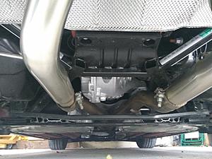

Correct is the twin pipes that obvious I now have a popping and banging f-type, The rear box was just removed and straight pipes 3" out to two 4" tail trims. The fabricator did the pipes that i utilized the same connections so i can put back on the rear box at any time, the exhaust button is no longer used. On startup and idle there is a nice heavy sound, thought i might get a boy racer sound but no, lovely, on option D it does a heavy thumping pop like the V6 through each gear, and crackle on lift off, now it's nothing like the V6, different but good. Then there's Dynamic and paddles, well its unreal,why jaguar didn't do this from the start, through the gears and down shift it's just like a gun banging and pops and crackles. On cruising there is no drone what so ever. Think this is the way forward if someone has a 2.0, this is enough to do. My nearest town is a mile away and my wife could hear it banging and popping when driving through, it makes it a different cat and a big smile, so anyone with a 2.0 get to the shop and get the box of and 2 straight pipes out, there is a bit of precise bending to do to get the 4" tips to fit, first pic it the oem box and the next the 3" just inserted in,the last pics of the pipes look a bit low but that was the picture angle as from the main picture they look ok, also you can see the heat shield from the angle to facing up. Some aftermarket exhaust come wit a plate to cover round the pipes like the Quicksilver system, so i done this also, covers it completly, it was a bitch to do.
