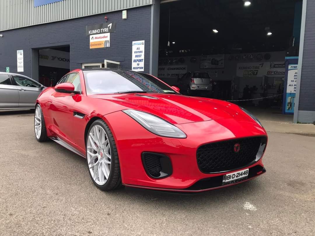

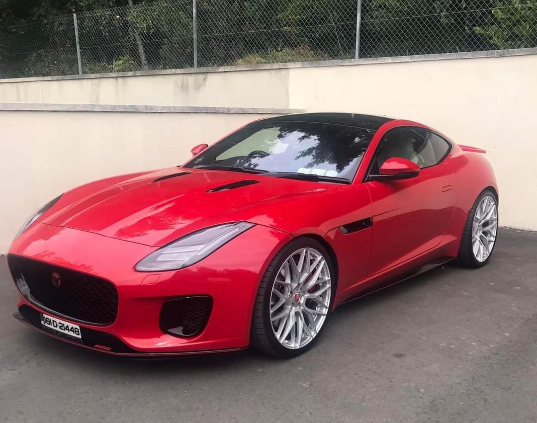

Look at Eibachs, I had the car lowered on 20" now on 21", happy with height and ride, had 15mm spacers all round with the 20s but custom fitment with new wheels

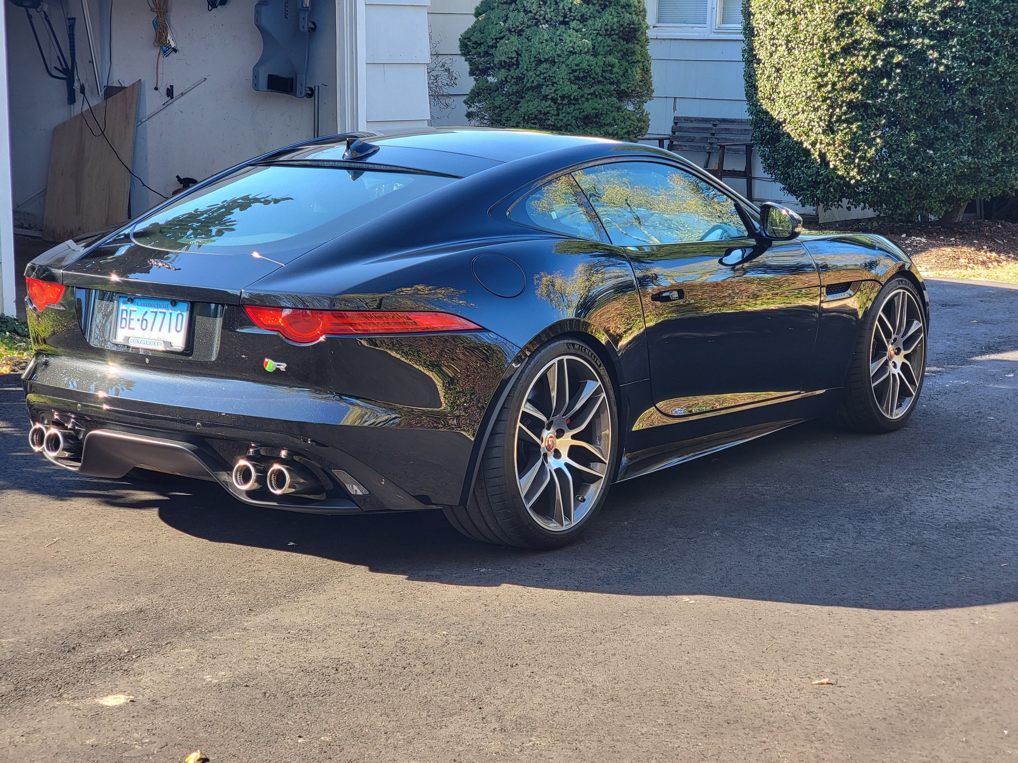

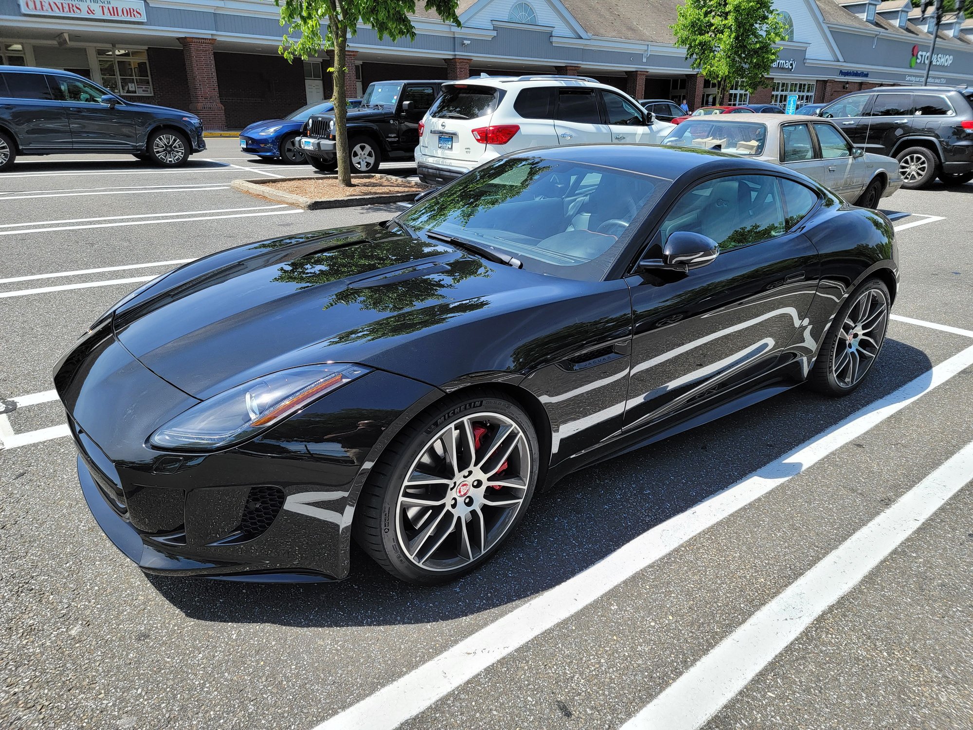

Anyways, to everyone else other than Obi, VAP and H&R springs are both great - I just happened to go with H&R. I think any of the lowering spring offerings for our cars work pretty well, subtle differences between them. None are going to make you run off the road or knock your teeth out. If you're thinking about it, pull the trigger, it's a great mod.
I'll dig up some before/after pics shortly, sorry for the delay, been a super busy week.

Originally Posted by bfrank1972
Wow :facepalm:
Cheers,
Brad

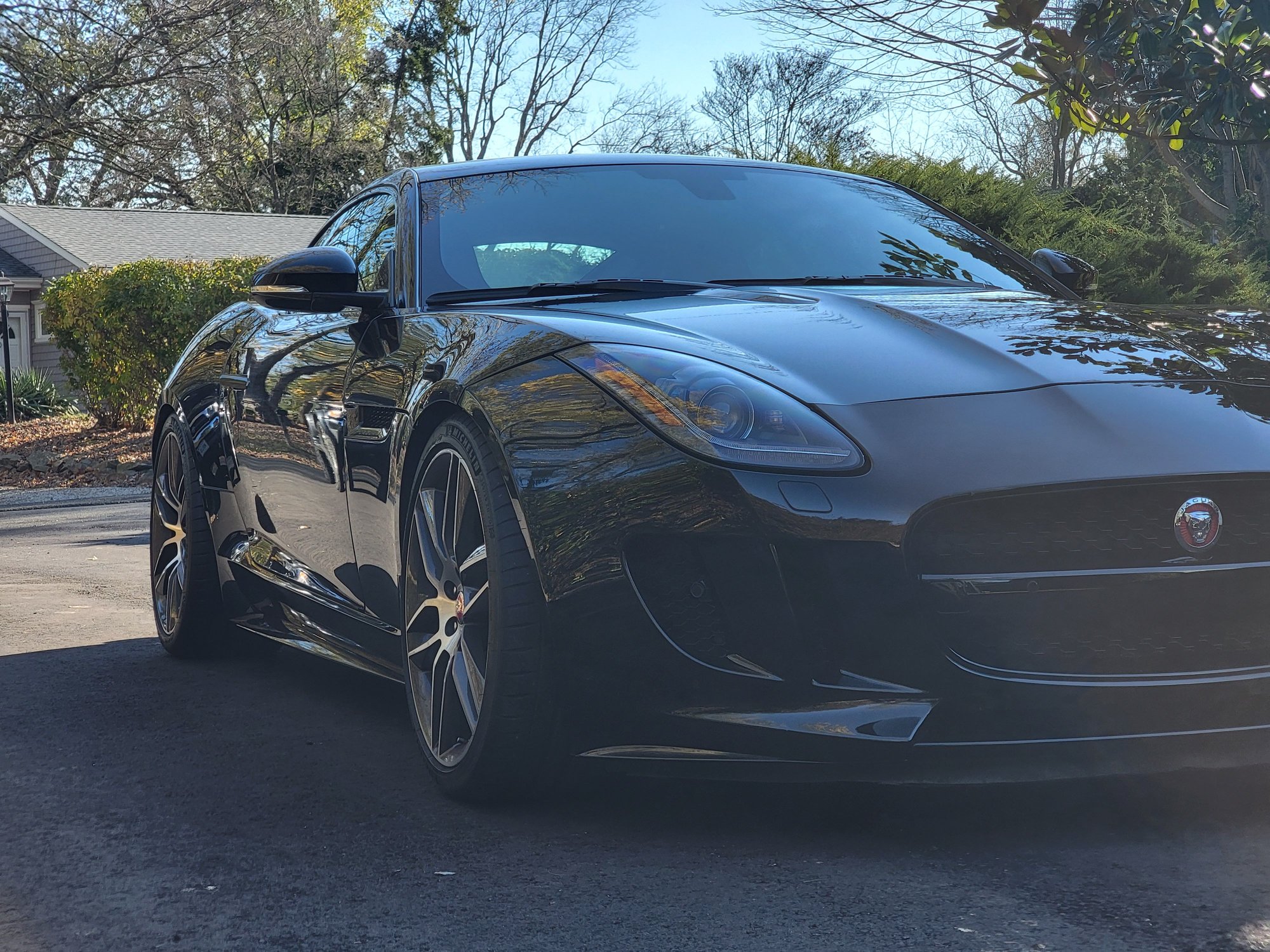

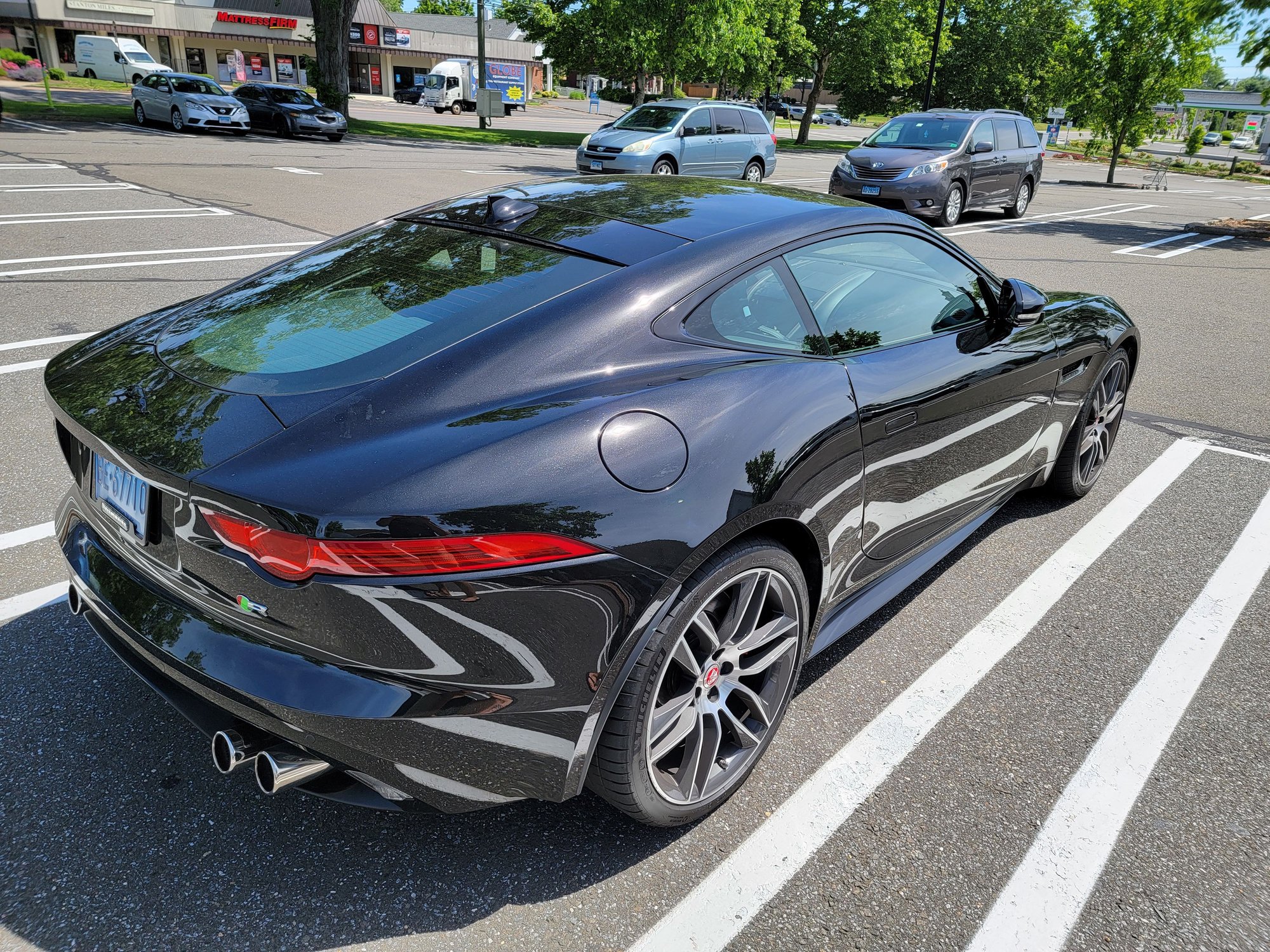

And before:

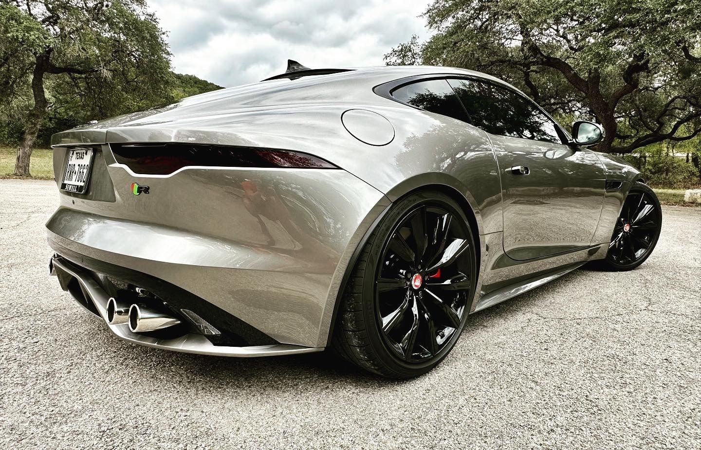

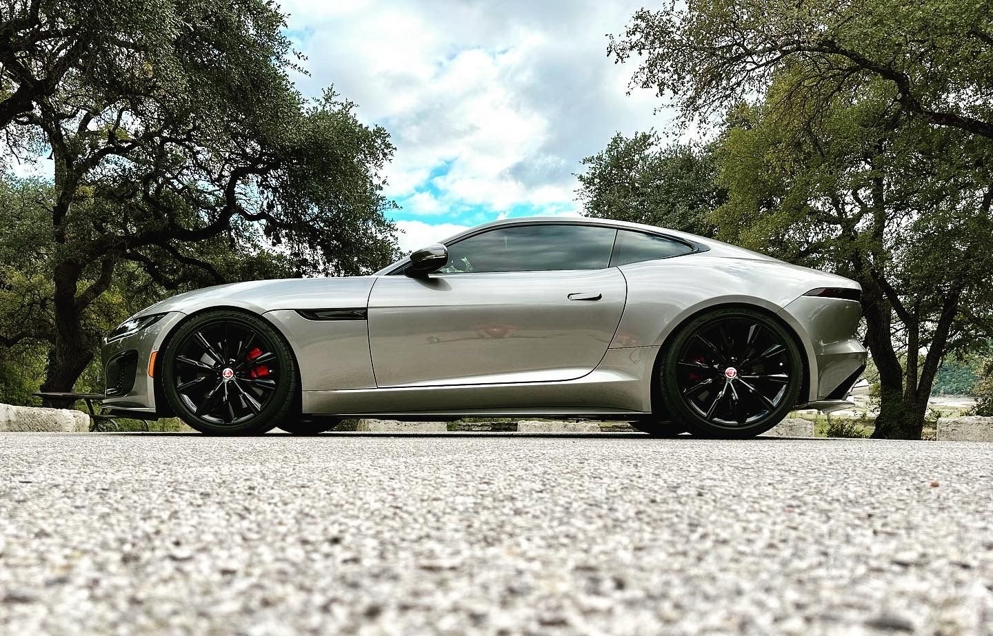

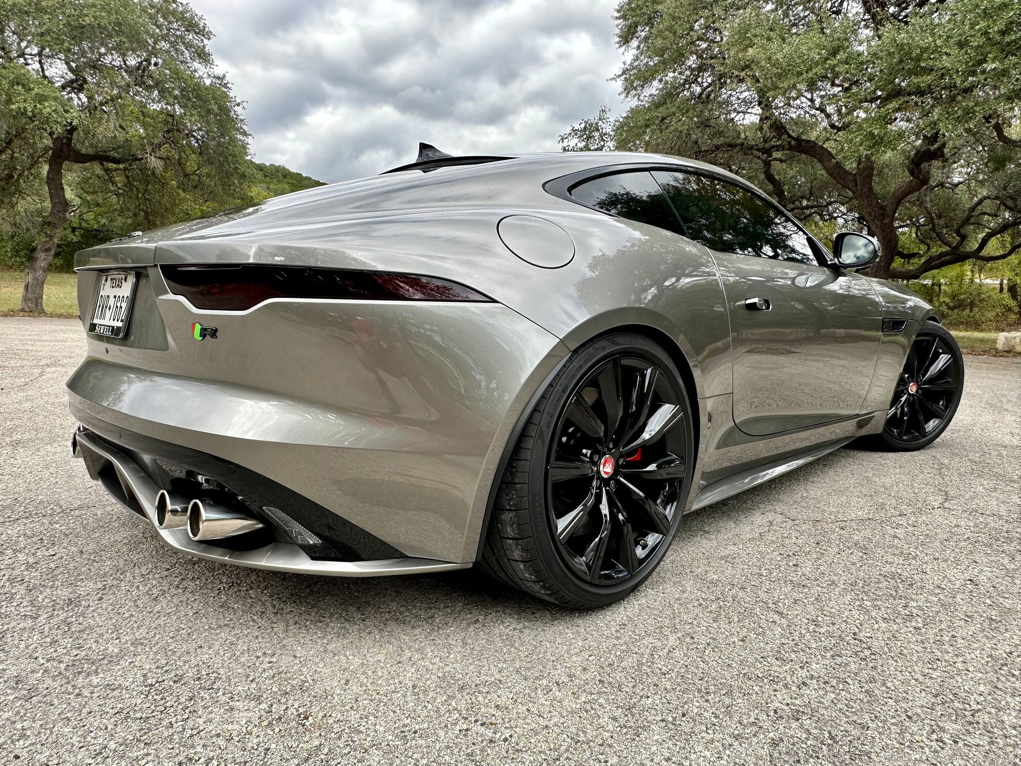

I tried both VAP and KW HAS on my. 2023. The KWs looked better on the newer models because of the slight rake the newer models have. I still have the VAPs for an AWD. I had them on for 2 weeks, so they are for sale.

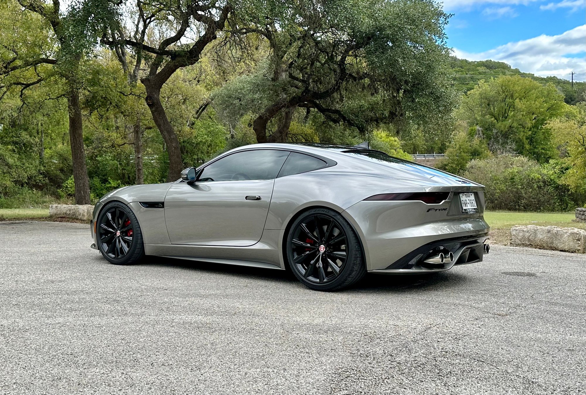

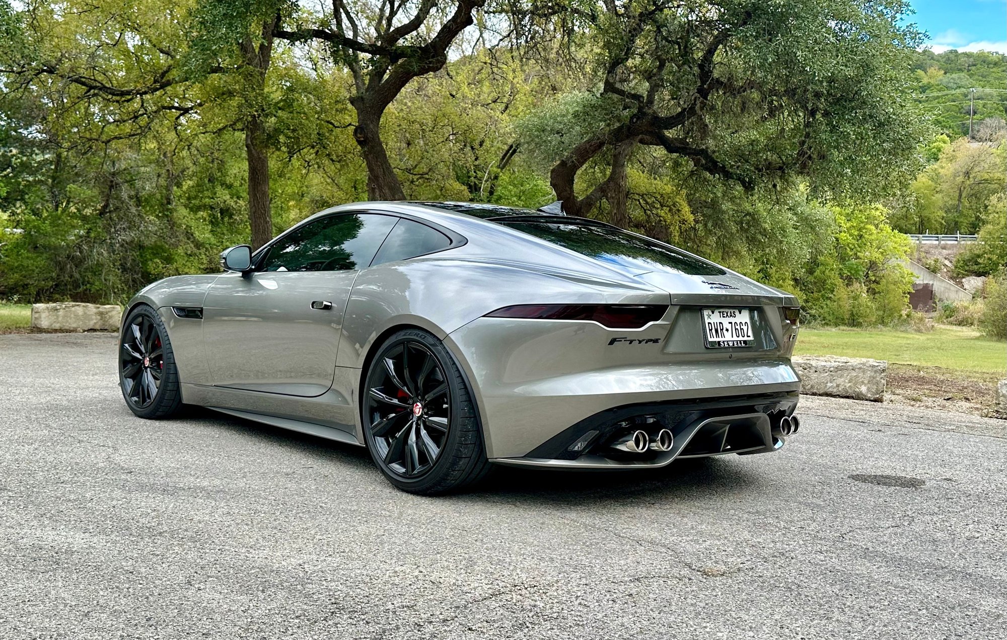

My 2c. I have experience in this matter by first trying the VAP springs, then the H&R Springs, then I installed the KW Variant 3 in my RWD XE 35t. (Tuned to 553HP on Ethanol. I paid $42K for the car new, lol., a bargain considering I'm less than 40HP away from the worlds fastest sedan, the P8 XE. https://www.hotcars.com/fastest-seda...e-nurburgring/ )
Both lowering sets helped with ride height and therefore reduces roll. The VAP's feel a little softer, mine were a Pre-production set from Stuart so they were raised a little for production after my test, and I found testers the lowest.
The Tapered Spring design of the VAP's do give a smoother ride, but the tradeoff is a little disconnection from the road. When compressed they stiffen right up and do their job.
I've used H&R's for decades, always liked 'em. I replaced the VAP's with H&R's, and as expected the ride stiffened up some but was still quite nice. The car rode a little higher, but I was still getting scrapes on driveways and other big humps. I preferred the more connected feel of the stiffer H&R's personally, it is a matter of taste I think.
I should have skipped all that shix and gone straight to the KW Variant 3's, but for the first couple years there were no coilovers made for our cars. I had the coilovers installed by the guys who set up weekend racers for COTA, (soulsped.com) and they really know what they are doing, the drive feel is Angelic.
The KW variant 3's achieved the impossible for me. They raised the car a little over the H&R's so I don't drag anymore, And my cornering improved, even though I have a higher center of gravity. I feel more connected and in control than ever, and the clincher is the Wife says this is the most comfortable feel of Stock vs VAP vs H&R vs KW. Now we know why they cost an arm and a leg, but it is Sooooooooooo worth it, believe me! :-)
