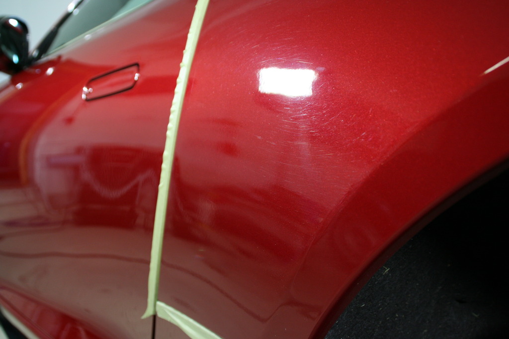

I delivered my F-type to the detailer Sunday evening, and he has just sent me a few pics of the work in progress. The car is just over one year old / 9.000km (I bought it second hand two months ago).
It will be a full detailing job (inside and out), finishing of with different GTechniq coatings on paint, alloys, calipers, exaust, windows/glas etc. He (the detailer) is very interesting in Jaguars, and he wants to spend a bit more time on details than "normal" on this car - so his plan is to be finished on Friday.
As you can see from one of the pics, there were some light swirls to take care of, but they were not deep so it could be done with ease. The good thing is that it means there is a potensial to make it look even better than it did
So this is what I have gotten so far - and I will continue in this thread with more pics as they arrive - if that is ok?

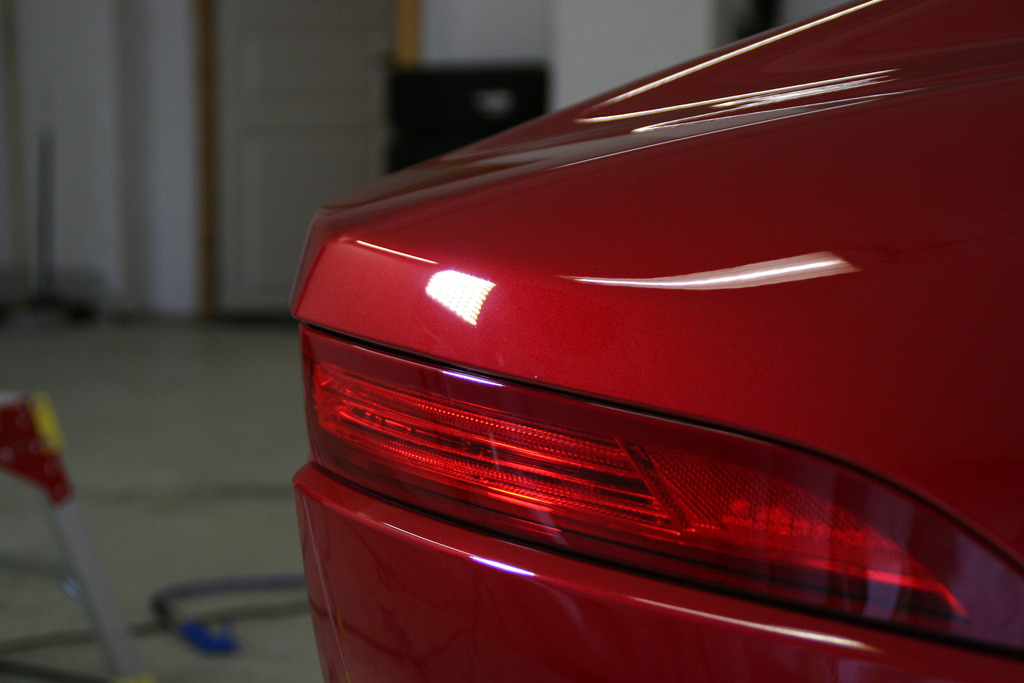

Here comes a few more.

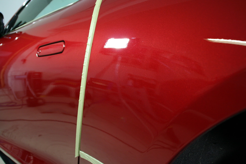

This is a "before and after" polish of the left rear wing (and before additional treatment):
And one of the whole car from that angle...

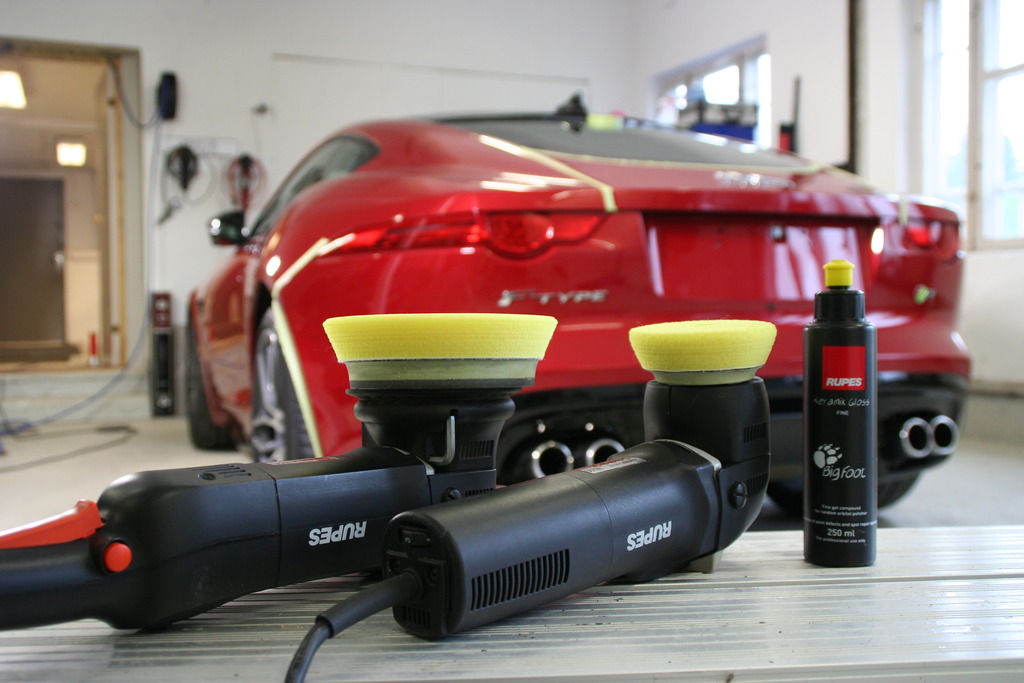

The Tools that have been used so far is Rupes Bigfoot 15 and Rupes Mini polishing maschines with yellow pads and Keramik polish. He first tried a couple of polishes from Menzerna, but on the Jaguars IRR paint, they were rather difficult to dry off afterwards, so the Keramik polish worked better here.
He said the paint is "medium" hard (almost as hard as the paint on my previous VW Touareg), but rather "toughen" and easy to work with. He claims that a good paint sealant will make it a lot more resistant to scratches and swirls, and even minor stone chips.
From my own previous experience with the Touareg that got the same treatment, I can only agree, and I am happy I deceided to do the same here. This time he will use a different GTechniq sealant though, which should be even harder and more durable than the one used on the Touareg (which was GTechniq C1 + EXOv2).
Arne,
This is a great thread, very informative for me. Question. In your first photo, that line across the fender, is that Xpel on the paint? Which side has the protector, and which not? Are the swirls now under the protectant, or the other way around? I don't understand why the protectant line is where it is, unless there in none at all. So that's the line of tape in photo 3, not aXpel edge ?

Arne,
Thank you.
There is no Xpel on the paint anywhere. What the profesional detailer does is to divide all panels into smaller sections with the use of masking tape, and clean and polish each section at a time to keep good control of how much polishing is done and where.
What you see in the first photo is the line where the masking tape that divided two sections were (the tape was removed before taking the photo so that you can easilly see what a differense the polishing job does).
The paint sealant that will be applied later (last part of the prosess a little later this week) will work a little like Xpel, but it is not a film. It is a liquid that when dry will act like a very hard layer/coating on top of the paint. It is also VERY water repellent, and dirt does not get stuck so easilly. You can usually just spray the dirt of with a pressure washer without using any soap (a little depending of what kind of dirt). Bugs and insects are also very easilly removable when washing the car.
There are many different kind of paint sealants, and whey are of different quality. The one he is going to use on my car is a rather new product from GTechniq, and is supposed to be one of the best there is - with long (several years of) durability, if treated correct (which is being carefull of what kind of soap you use when washing the car - try not to use alkaline based soap).

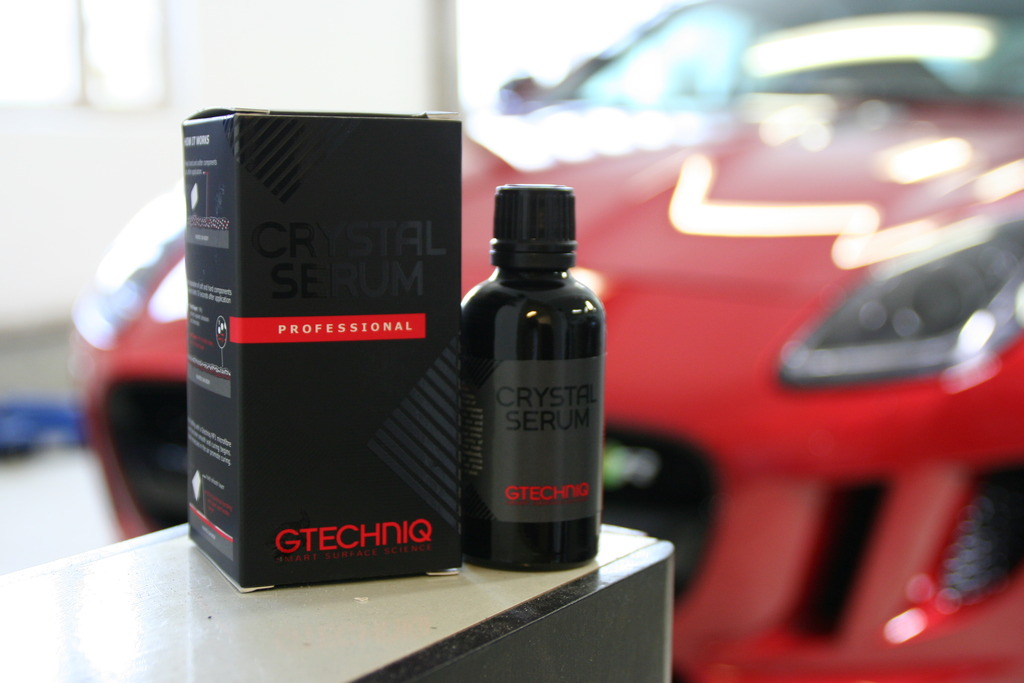

It is very correct that the ExoV2 (top coat) needs to be maintained with some kind of "quick detailer" to keep the water-repellent finish in good shape. But that is an easy job from time to time after a good wash (can be done at the same time as you dry of the car with a micro fiber cloth).
The Crystal Serum coating will last several years though, and even longer if you do the quick detailing once in a while.
The wheels will be removed and coated on all surfaces (except for the surface that goes against the hub). Not shure which coating he will use, but it would not surprice me if it is the same as you used Tel (the C5).
