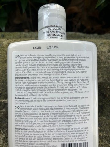

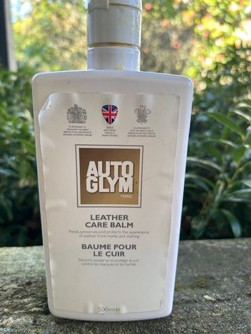

Leather conditioners: the prime thing is this: NO SILICONES. The problem here is that few producers of conditioners with silicones will rarely admit to it! Having tried virtually every conditioner available my favourites are Autoglymn Leather Balm and Lexol, the former being creamy, the latter much less thick. Another excellent conditioner is Leatherique, which is an "oily" conditioner - bad description but... They all work beautifully - apply by hand, massage into the leather and leave it for a couple of hours (or longer...). These conditioners will bring dirt and salts to the surface so the surface will feel sticky - no worries. A bit more of the conditioner on a microfibre cloth to buff the stickiness (and the dirt!) away and the leather will be beautifully clean and soft (especially the premium Windsor leather in the F-Type).

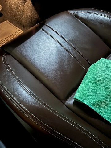

This is Autoglym applied on the F-Type seat (colour: Brogue):
and after being allowed to penetrate, and buffed. (The is a slight surface "shininess" which quickly disappears):

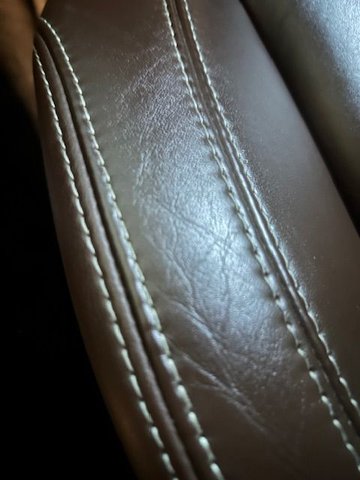

None of these conditioners harms or alters the stitching in any way:

Thanks @sov211 . I have heard of both Autoglymn and Lexol but haven't used either one yet. I will definitely give one of them a try.
