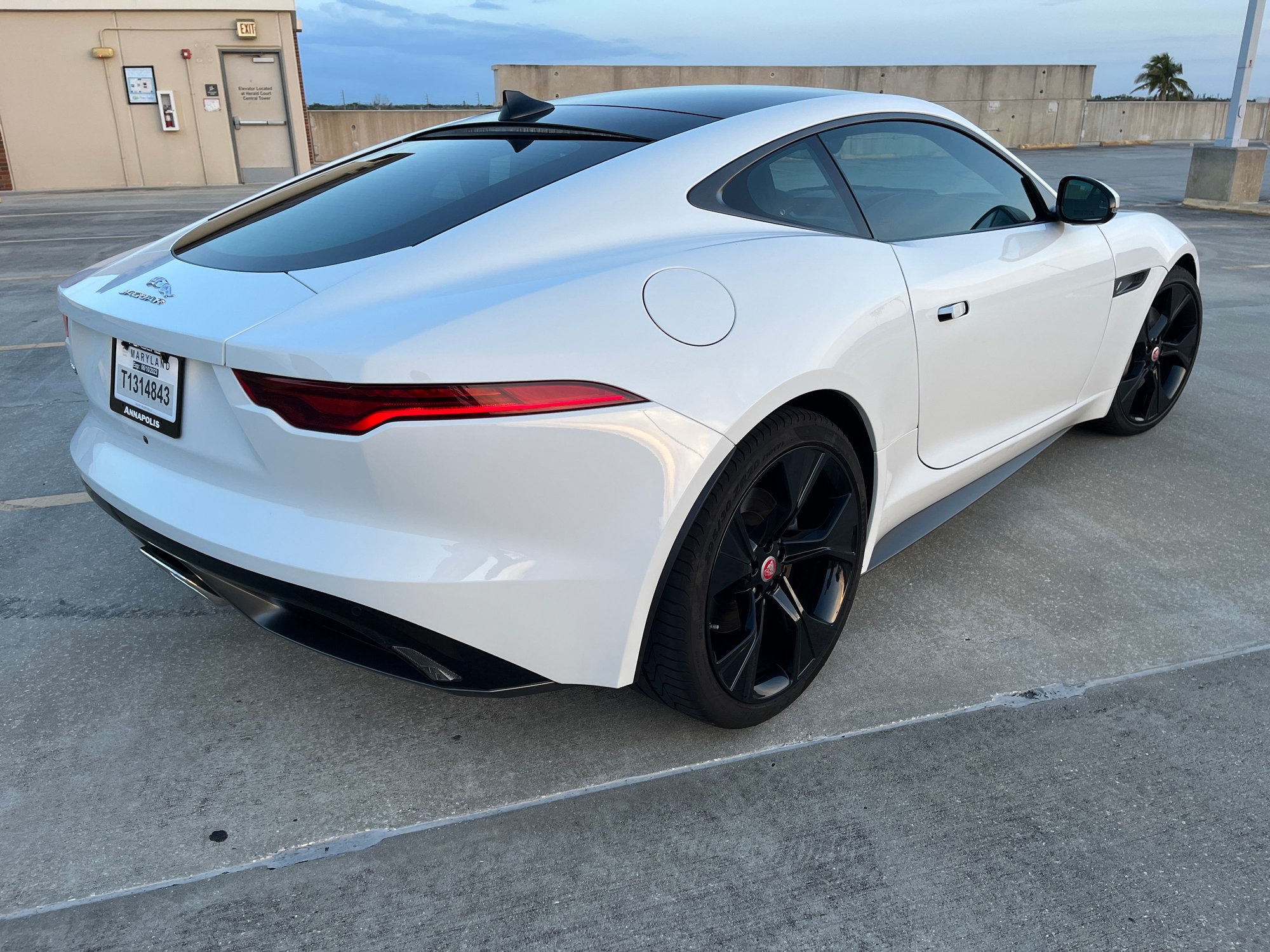

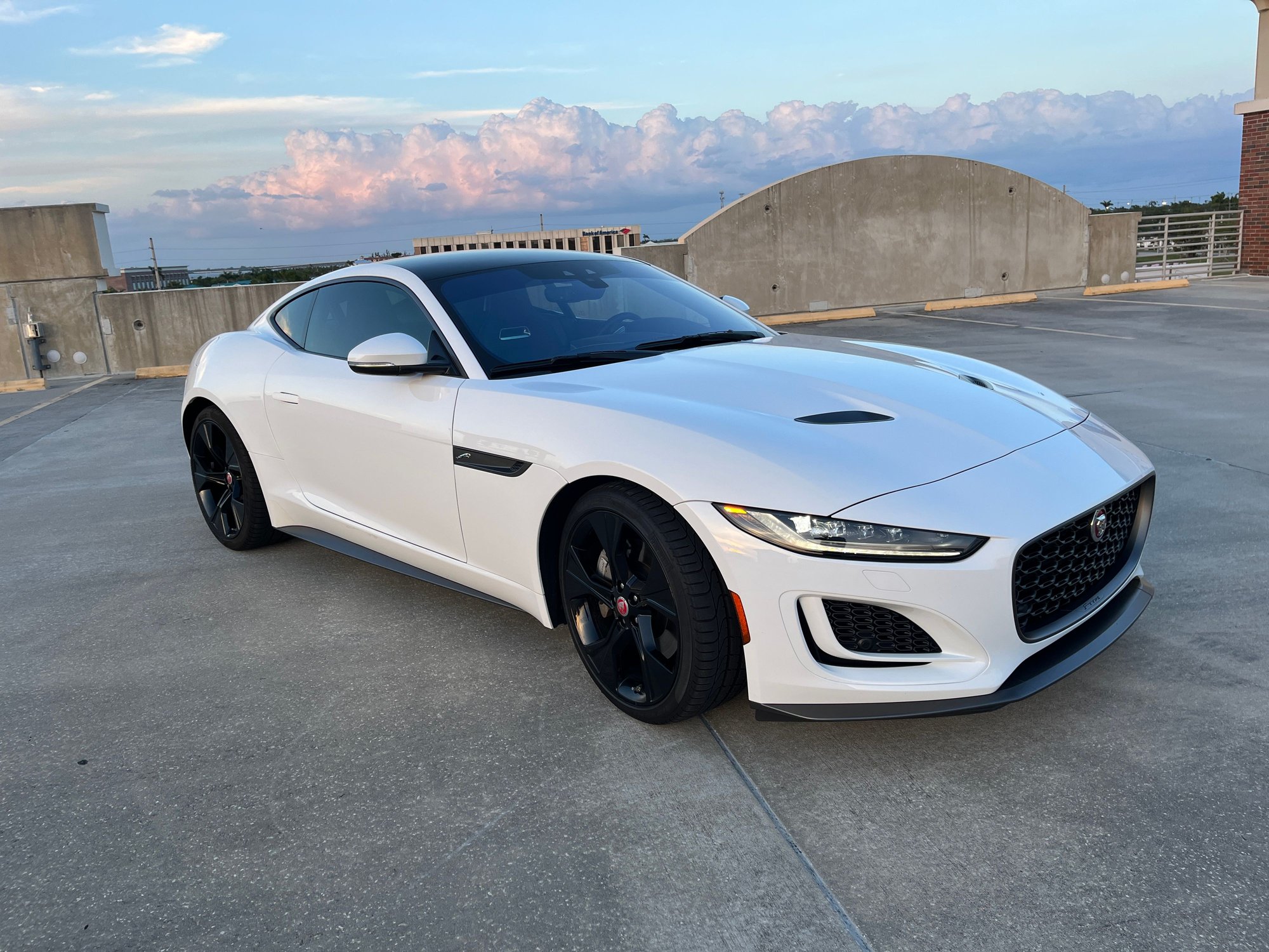

I'm old school, and dislike these black wheels:
Yeah, they're SHINY, but the tire and wheel just disappear into the wheel well - there's no contrast.

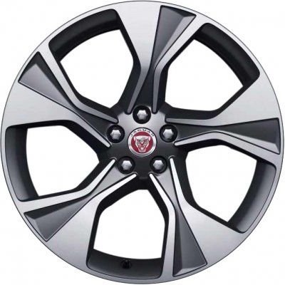

I just now realized the $500.00 upgraded factory wheels are EXACTLY the wheels I desire, only they are solid black:
Instead of grey with a machined surface:
Taking these to get them DIAMOND CUT will give me the desired contrast, with a black, rather than a grey background.
Anyone ever done this?
Do I need a clear epoxy coating over it, and if so, how to make sure that sticks to the rest of the wheel?

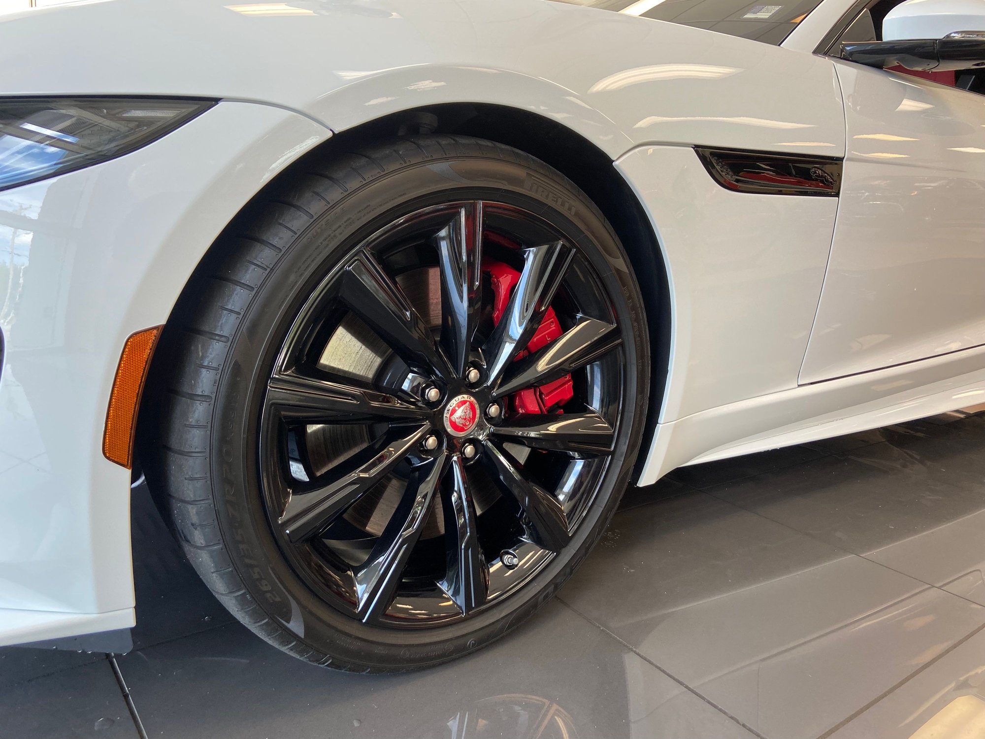

I am also not a fan of black wheels for the same reason, especially if they have wide spokes or a lot of spokes. If they have thin spokes, then the blobbiness is set off by the coloured calipers and silver rotors. I look for graphite (gunmetal) coloured wheels, but I think in the case of your particular wheel style, there is so much acreage in spokes that diamond cut is the only way to go, otherwise they will look like steel wheels painted black. Personally, I would sell them and buy some forged rims which would hugely improve the driving experience, but then that is pretty much my advice with any jaguar OEM wheel.

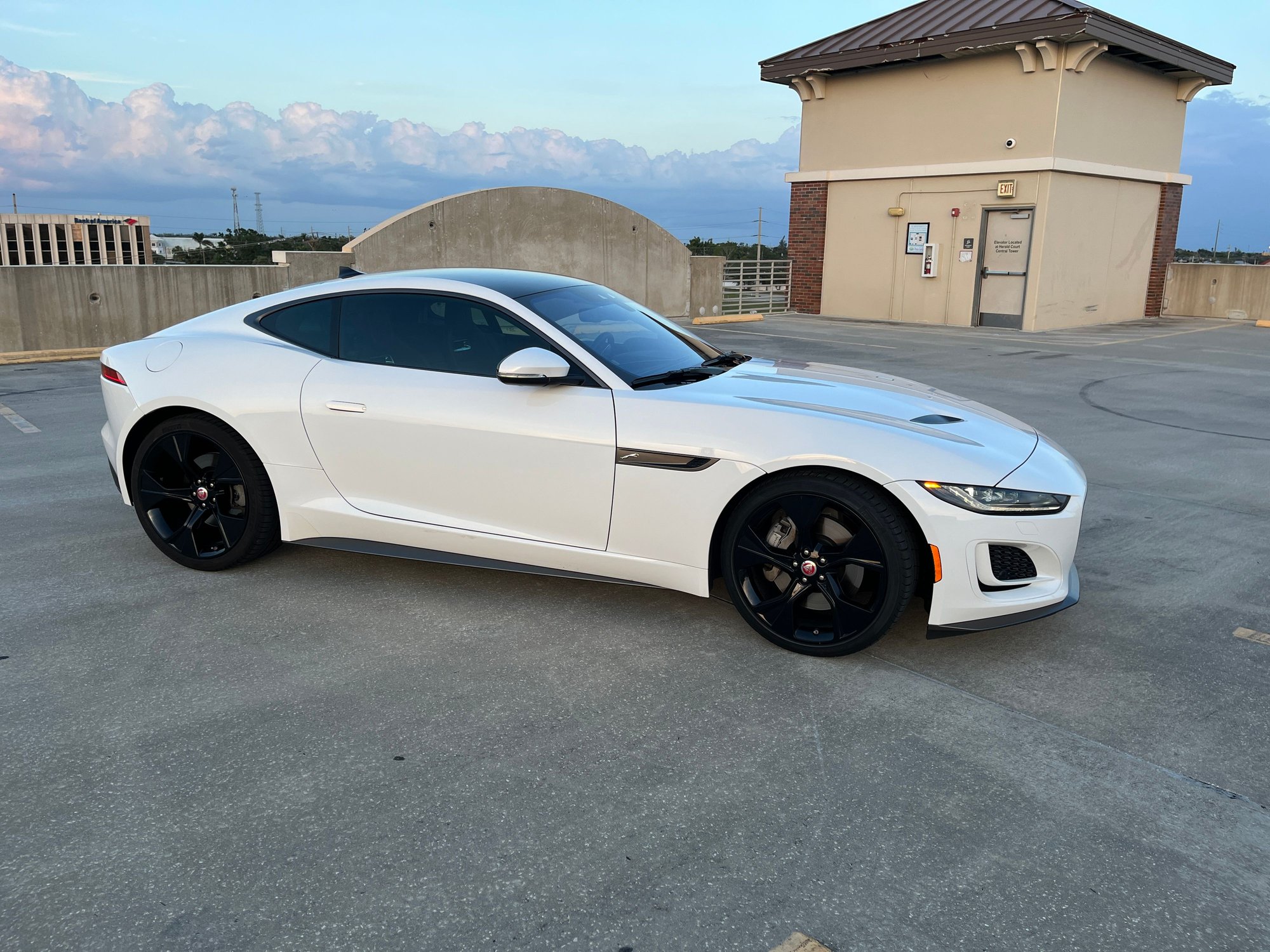

After discussing the problems with runout tolerances on aftermarket wheels vs factory wheels with the guys at my local tire store, I would ONLY do a factory wheel.
ANYBODY WANT TO TRADE OUT THERE ? - (more photos below)
Otherwise its going to be diamond cut & clear.

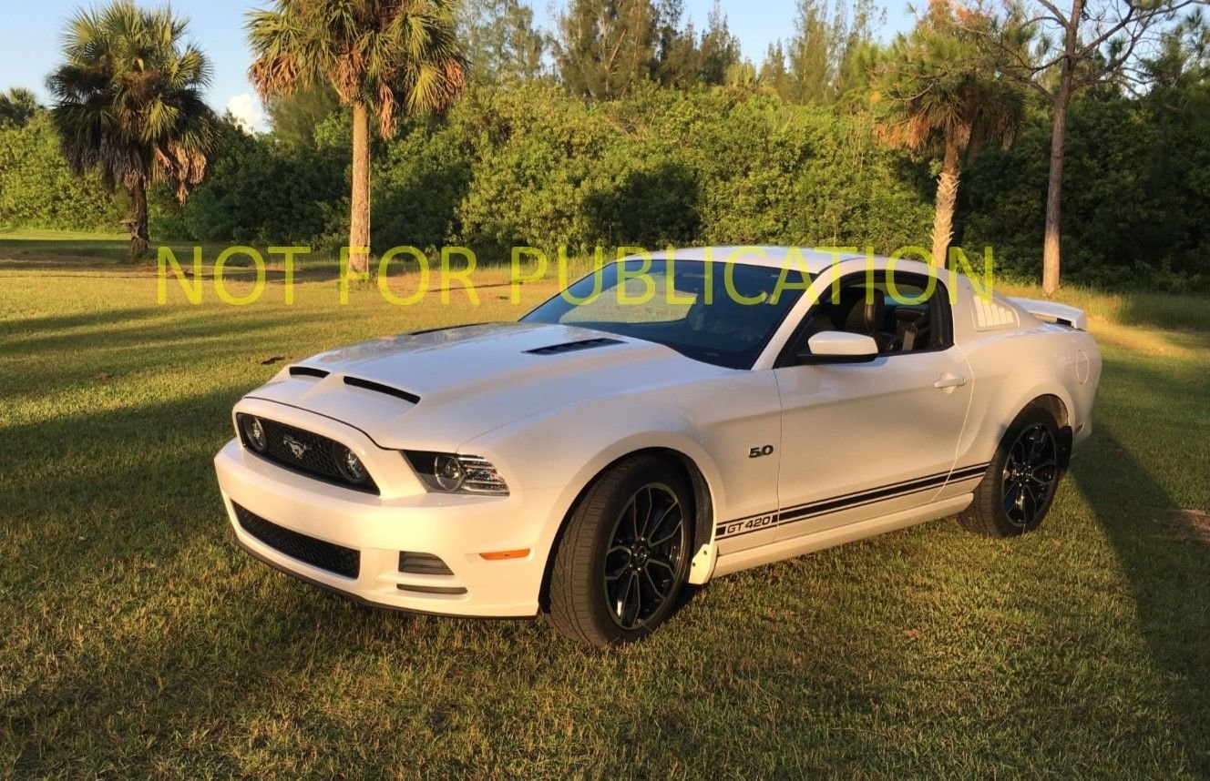

I wouldnt dare contradict the advice that your wheel guys have given re runout tolerances (which I didnt even know was a thing before I googled it), I can only speak from my experience. I have had the forged Vorsteiners on for 4 years, about 25000km (just coming due for new tyres). The car rides far better than it had on OEM 19's which were tremendously heavy, as they are made to the same spec as Land Rover wheels, designed to cope with the worst of Britain's roads. The reduction in weight is very noticeable, particularly in direction changes, with the car being a lot more nimble than it had been. The ride is about the same on 21's as it had been on the OEM 19's, though I also changed tyres from the P Zeros. The ride and handling is often commented on by passengers, and by the service guys. They are always surprised how good it is given the size of the rims.
Personally if I had your car and I wasnt going to get new rims, I would have the inner part of the spoke painted white, and the calipers painted white, or just the calipers. I had the calipers on my mustang painted orange to match the orange fury paint, it looks fantastic and professionally done (cost a grand, colour matched) the brake dust isnt that noticeable.

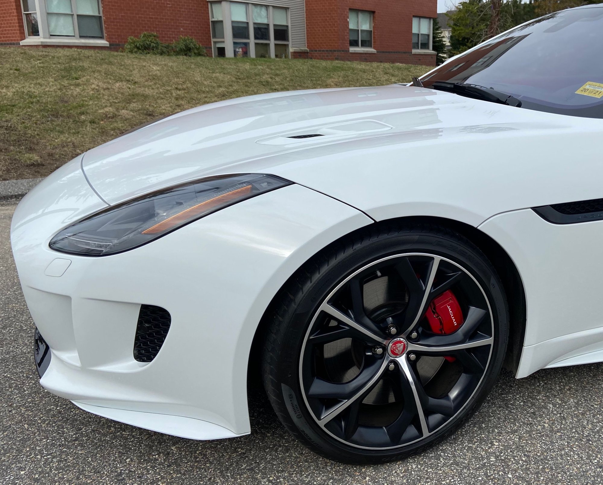

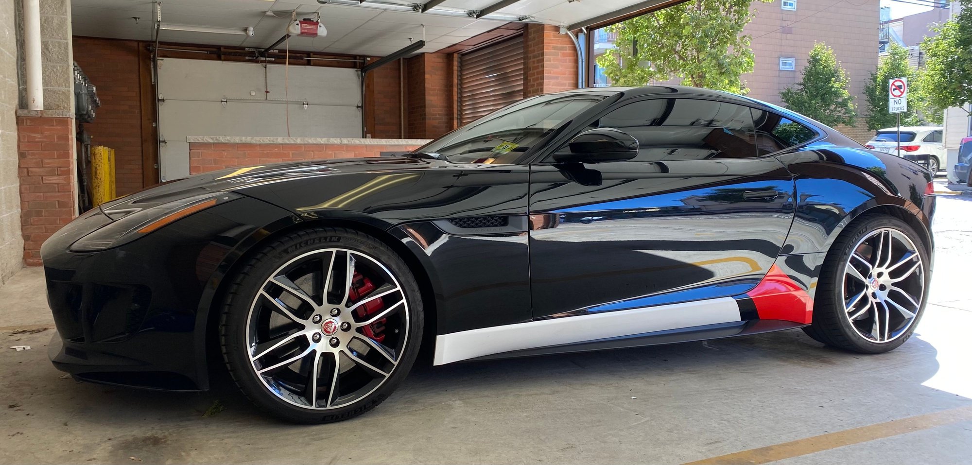

I diamond-cut my factory Gyrodynes. I have a black F with the silver Gyrodynes but wanted the contrast of the 2-tone Gyrodynes, which are diamond cut from the factory. I had to first powerdercoat to get the black before machining to reveal the silver, then clear and curing. Finish has held up for a year now.
yes...the vinyl's been removed

Thanks! I don't know the type of clear used, but it was applied over the entire wheel including the powdercoat as the final step then baked. I suspect your shop would recommend also stripping/ sanding down the factory clear in the other areas, so the whole wheel can be clearcoated and cured. But maybe it's possible to blend new clear to old and not have it flake off over time?
Think yours will come out looking very sharp. Post pics!
