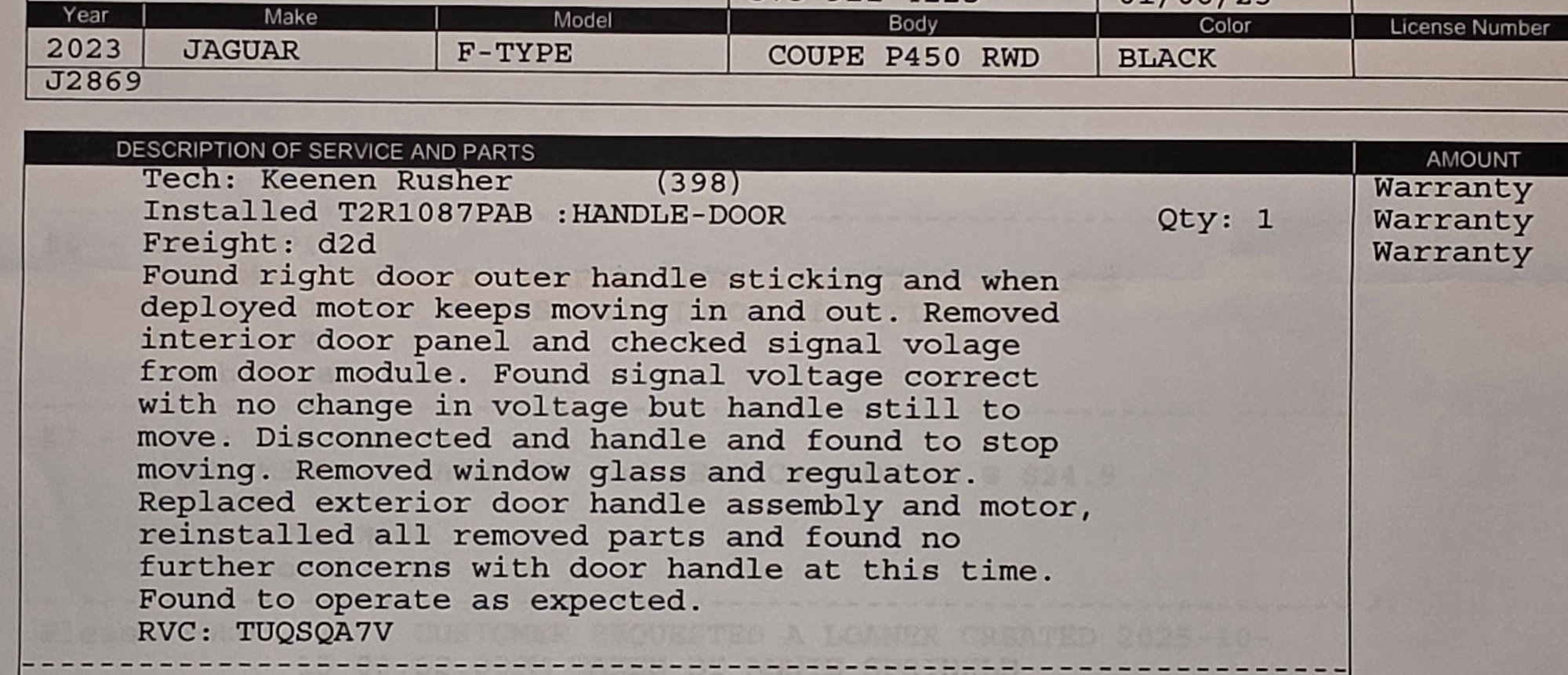

Chiming in as I've had this same symptom on my '23 for the past four months (exterior passenger door handle motor "clicking" and going in and out on its own). This failure only occurred when the vehicle was first approached by a user with a key and a door was opened, as well as immediately following stopping the engine and exiting the vehicle. It would stop when either the vehicle was locked or the key holder stepped away from the vehicle (out of range of the passive entry sensor/system). As my car is still under warranty, I took it to the local JLR dealer and here is what they did to repair the issue. In short they replaced the door handle complete assembly, T2R1087PAB.

Sounds good. Please note that the part number for the door handle assembly is exterior paint color specific AND side specific AND with or without passive entry specific!
