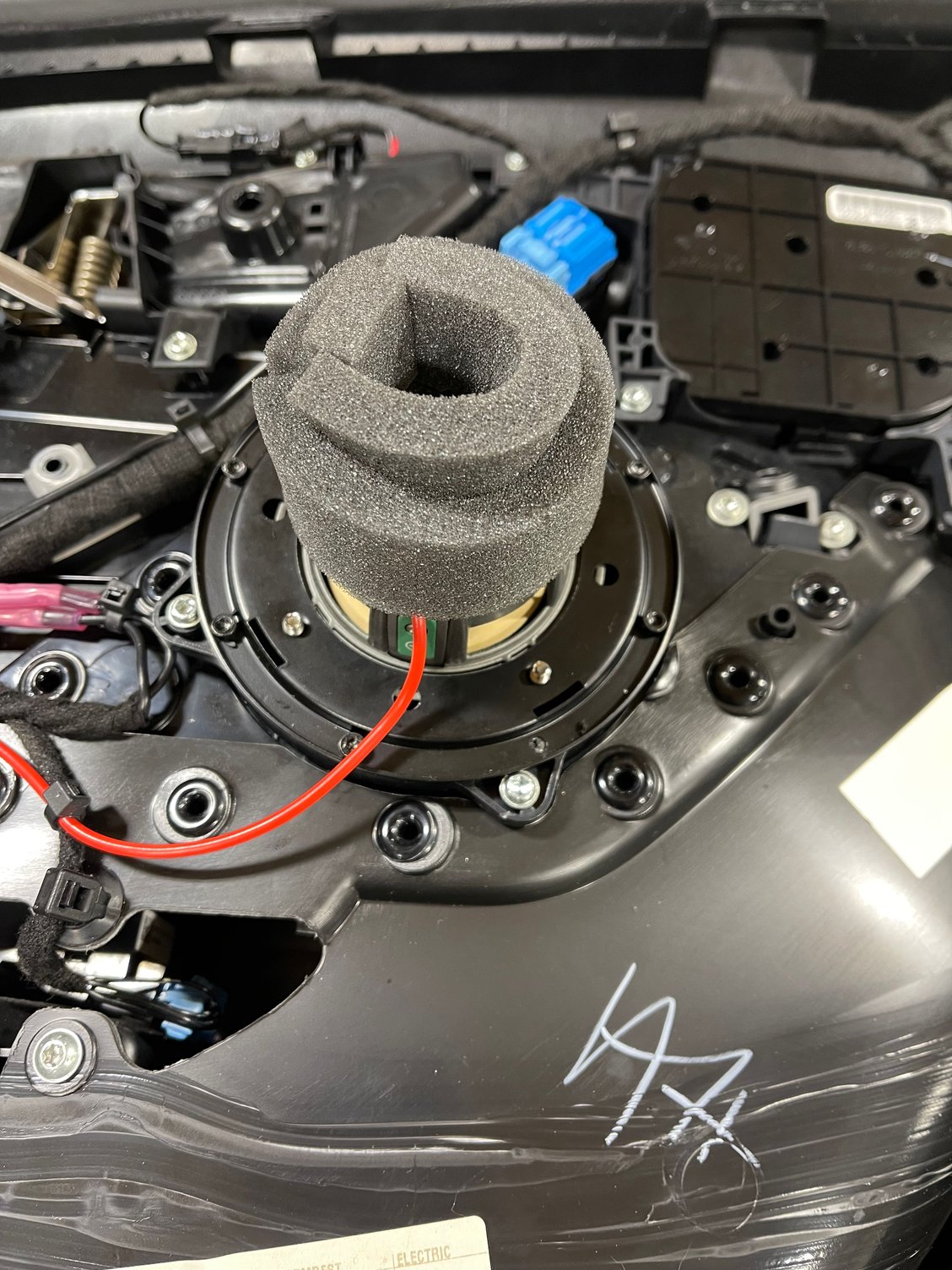

I tried AudioFrog GB25's and they bottomed out on the door. Morel MM3's fit fine.
There's only an 1/8 difference listed in the specs but I mounted them a little differently.
I used the supplied mount with the GB's because they have a smaller diameter and mounted that to the trim panel.
Disregard all the foam, I tried cutting out the back door panel to make room and then sealing it with the foam. Unmitigated disaster.
With the MM3's I just cut the guts out of the existing mid drivers and mount the MM3's to the resulting ring which then went back on the trim panel.
Just be aware that the MM3's are quite wide at their base and the spade connections need to be modified a bit because they will bottom out and break the circuit board they are mounted on.
Ask me how I know.
I cut most of the plastic collar away from the quick disconnects and then secured the circuit board with some butyl tape.
