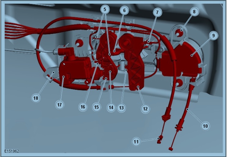

On several other Jaguar models, losing the window travel limits / auto drop memory is one of the first signs of a partially discharged or failing battery.
I'm not familiar with working on the F-Type but I'd be surprised if the window automatic drop and door latch designs differ from all the other recent models. Eliminate the window travel limit setting before going on to possible problems with door latch microswitches.
To reset the window travel limits, sit in the car with the engine running and doors closed. Drop the drivers window fully and hold the button a few seconds until you hear a soft click from inside the door. Raise the window fully and hold the button for a few seconds again until you hear the click. Repeat for the passenger door.
