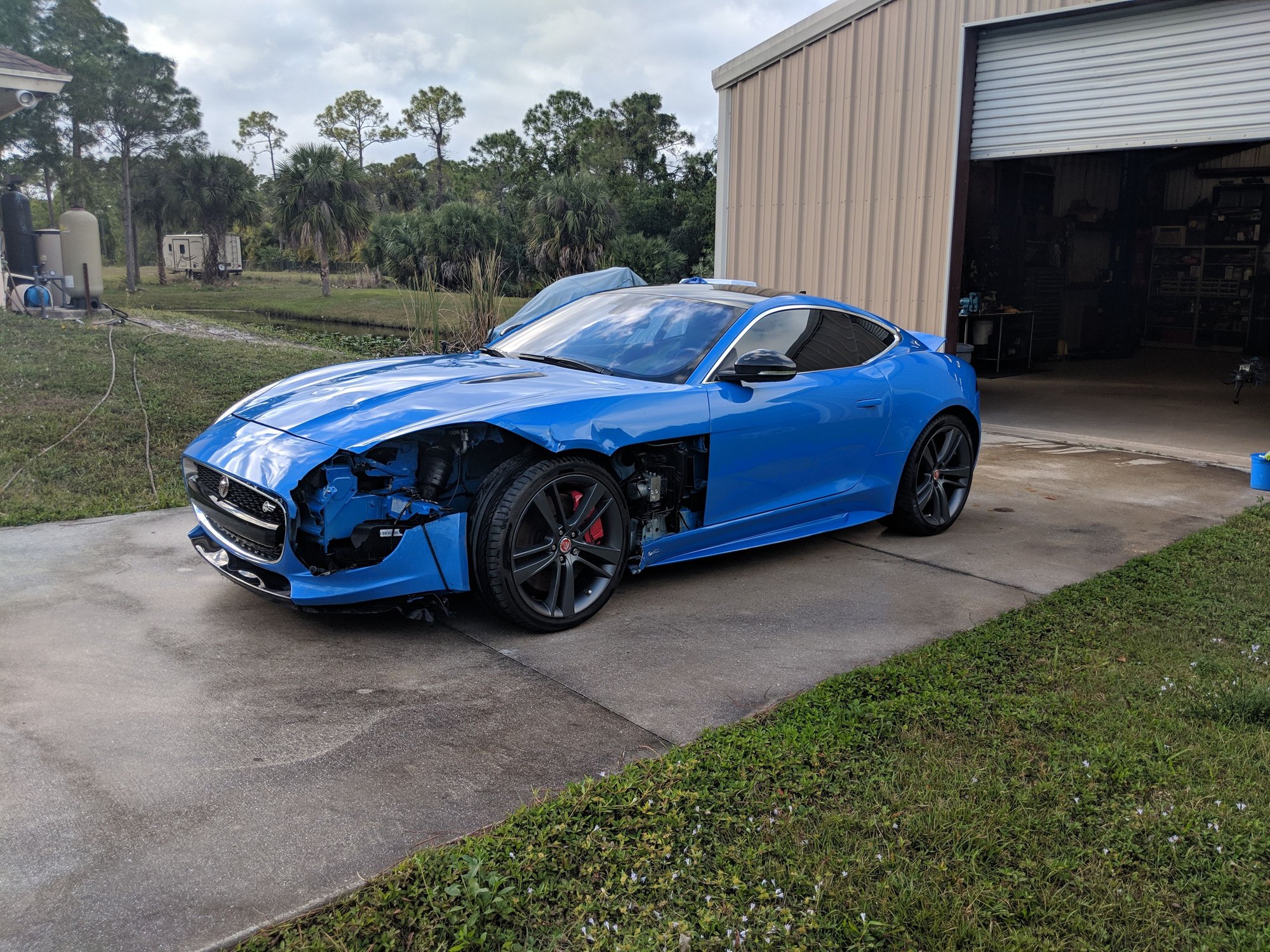

I have a 2017 F Type British Design Edition. I purchased the car with accident damage on the front left (steering wheel airbag, headlight, bumper cover, fender, hood) The car runs and drives, however I have tons of warnings on the dash that the parking brake, dynamic mode, spoiler cleaning mode etc all are intermittent or done work at all. I have cleared the codes but they pop right back up. Im guessing they are all related to the same issue. Does anyone know where I should start looking?
