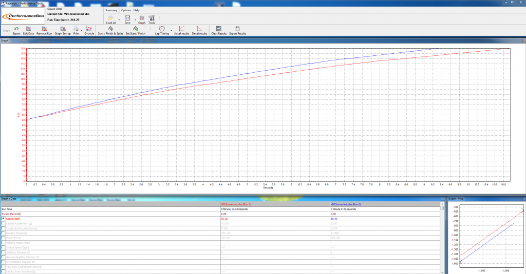

Performance documentation:
As I have previously stated in earlier threads I was interested less in dyno before and after plots and more in real world acceleration testing. I have no idea what 65 LBft improvement means in actuality however I can understand timed speed range tests and their results. Because of that I did not do any dyno testing but focused on acceleration testing.
Specifically my real world testing parameters would focus on 3 acceleration tests:
30-70 MPH, 50-70 MPH, 60-130 MPH
To accurately record these parameters I chose the VBox Sport. A GPS enabled performance data logger used by many performance testers including many of the car magazines. I also chose a little traveled section of highway that would give me a level road and a good testing surface.
Testing was conducted on two evenings at approximately the same time for the before mods data logging and 2 evening for the after mod data logging.
Temperature 75-76 degrees Fahrenheit
Start Height 184.50M End Height 184.87M Difference 0.37M
Convertible top up, windows up, air conditioner off
Dynamic more, Track DCS, Auto shifting
30-70MPH in seconds Before: 3.28, 3.29, 3.37, 3.38, 3.40
After : 3.02, 3.04, 3.05, 3.06, 3.07
Approximately 1/3 of a second faster on average
Note: Hard to get traction at the low end of this post pulley and tune.
50-70MPH in seconds Before: 1.8, 1.8, 1.8,1.83, 1.84
After : 1.7, 1.7, 1.7, 1.71, 1.72
Approximately 1/10 of a second faster on average
60-130MPH in seconds Before: 10.78, 10.88, 10.94, 10.96, 10.97
*After : 9.34, 9.34, 9.35, 9.59, 9.59
Approximately 1.5 seconds faster on average
· The after pulley and tune times are representative of what stock 997TTs are running.

I’ve had 3 good days to run the car. There is no appreciable difference in driving or exhaust note with the pulley and tune other than the increase in torque and earlier onset. I would definitely recommend this modification for how well it transforms the car. It pulls hard!

It seems to me that your gains in time to reach vrs. MPH are reflective of a fair bit of power increase, when you consider that the car is already very fast with the base set up, prior to the modifications.

The car does significantly pull harder. No question there is an increase in HP/TQ. I believe it’s inline within the advertised increases. I did ask about the AFR and leaning issues and Jerry told me he does not change the parameters from stock and with the minimal boost increase from the 1.5 Lb pulley and additional tune the direct fuel injection would not have a problem keeping up the called AFR.
