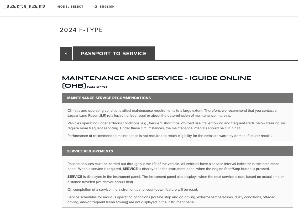

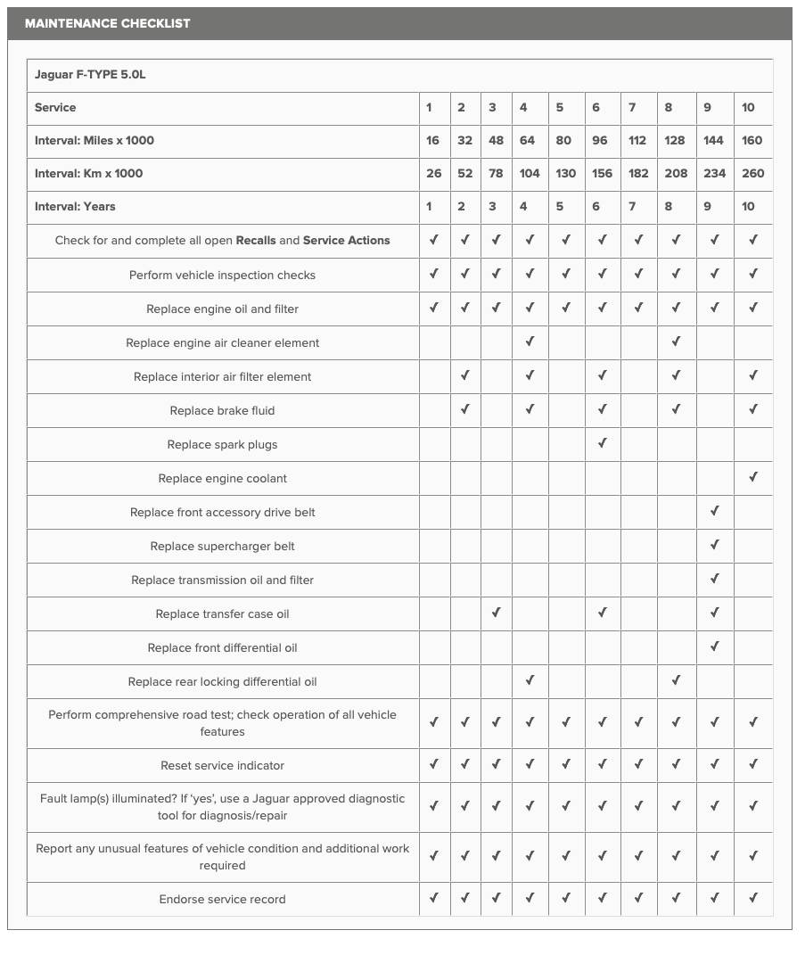

For your interest, I found the official one for my 2024 R today...
1) Go to this URL: https://www.ownerinfo.jaguar.com
2) On that page pump in your VIN
3) From there expand the "PASSPORT TO SERVICE" section
4) From there select "MAINTENANCE AND SERVICE" and it will display
No need for officially logging into TOPIx or anything like that.
Hope this helps...
OF NOTE: I remember people stating on the forum here many times that JLR viewed the oil in the rear diff as lifetime. Based on this clearly that is no longer the case ;-0

Note in the service menu I just posted for my car above there that it talks about replacing the transmission fluid.
