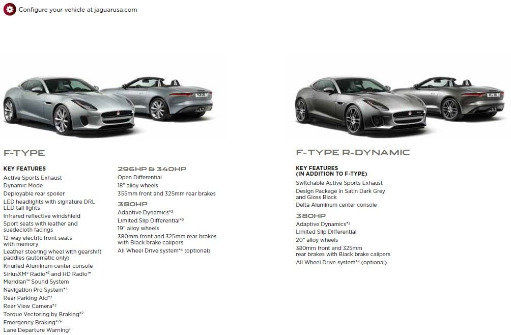

In the US the S model became the R Dynamic in 2018.

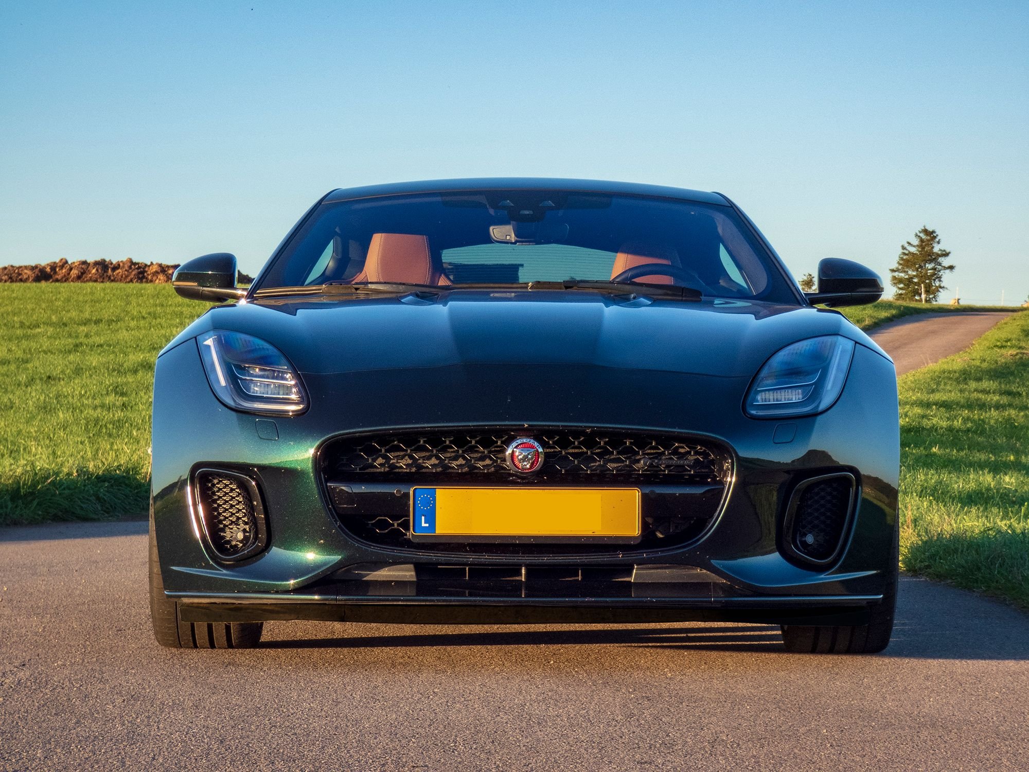

You could also get the 2018 380 hp version without the R-Dynamic package in the US. R-Dynamic is just a trim package which in other parts of the world also could be added to other F-Types and most other Jags. Pretty sure you could also get it on base V6 versions and the four banger F-Types in some markets.
Mine is an R-Dynamic too and I never liked that naming. It's just confusing. I guess Jaguar tried to mimic the BS trim package naming from BMW's M-Sport packages, Audi's S-Line packages or Mercedes's AMG-line packages. M should be for M cars, and R should be for R cars without mixing in some M-Sport or R-Dynamic badges on other cars. Since I ditched the rear R-Dynamic badge the only place it still says R-Dynamic on mine is on the door sills.

Did you remove the R-Dynamic badge in the front grille?

Painted it matte black so it's barely visible. So there is actually an R-Dynamic badge left on the outside of the car but it's so discrete now that I forget it's there.
