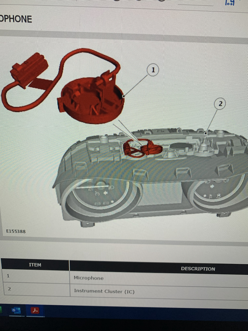

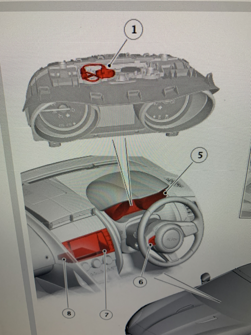

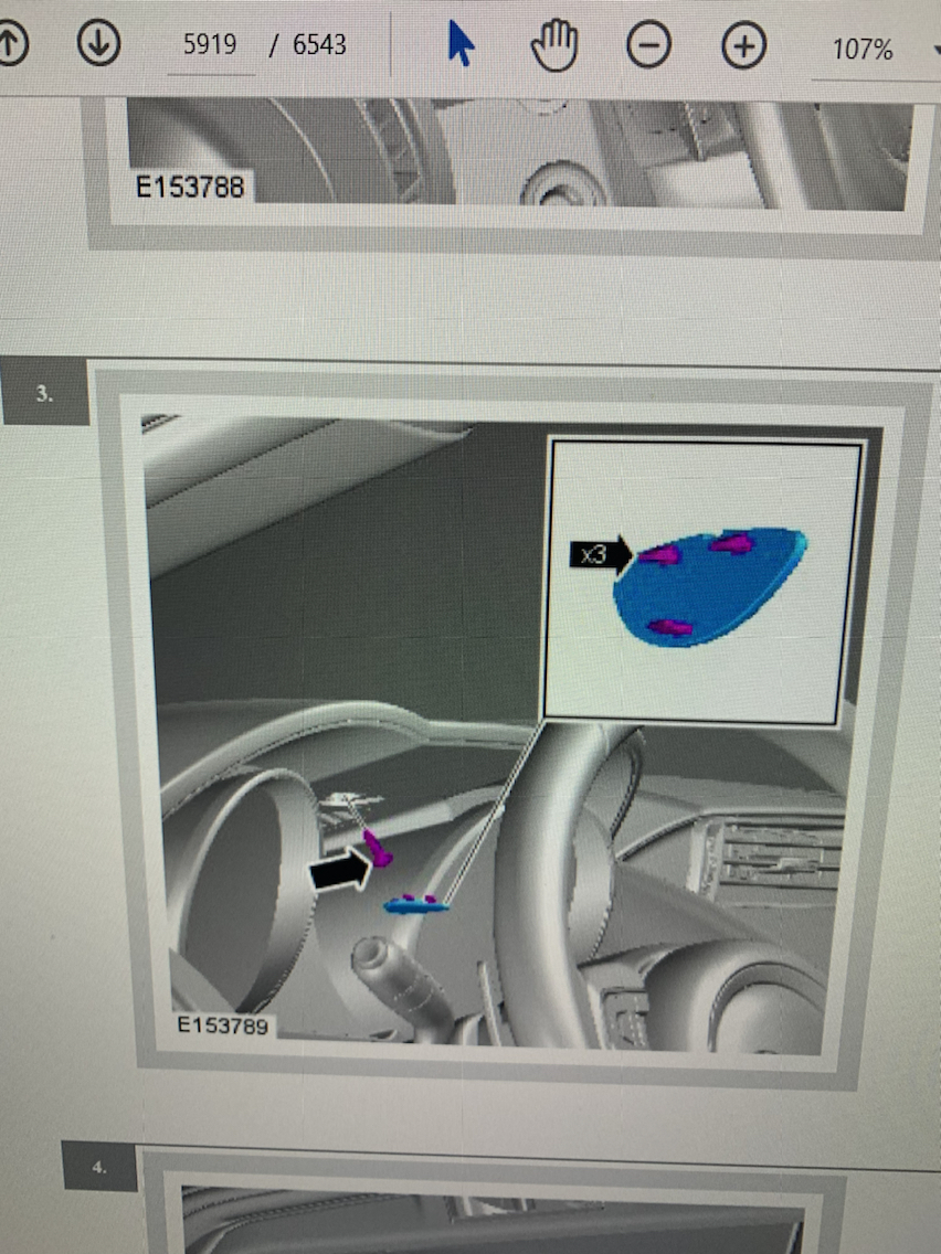

OK - I did some investigating in the workshop manual. Microphone seems to be part number T2H3751
It's attached to the top of the instrument cluster - will send photo below. From the info:
A directional type microphone is fitted on top of the instrument cluster. It is connected to the Integrated Audio Module (IAM) for hands free telephony and DVC (Dynamic Volume Control) systems. The IAM has an integrated noise suppression and echo cancellation system for hands-free phone use.
When the Bluetooth® mobile phone is specified, the IAM supports the Bluetooth™ mobile phone functionality and audio streaming. Bluetooth® mobile phone software and a Bluetooth® antenna are located within the IAM. The software within the IAM processes the Bluetooth® wireless signals from the users Bluetooth® mobile phone and allows audio output, voice input and data display on the TS. The hands free microphone is hardwired to the IAM. The microphone is used for the voice control system and hands free telephone
BLUETOOTH® PHONE SYSTEM
The Bluetooth® mobile phone system is controlled from the TS, via the left steering wheel switchpack. Signals from the steering wheel switchpack are sent via the clockspring to the TS. The TS sends control signals on the MOST ring to the IAM, where these signals are sent via Bluetooth to the connected mobile phone. Speech is picked up by the microphone and sent to the IAM. Audio from the mobile phone is sent from the IAM on the MOST ring to the audio amplifier module and is output on the vehicle speaker system. The hands free profile of the system allows the display of the network signal strength, network operator and phone battery level indication on the vehicle display, where the mobile phone supports this function. Also, if applicable, the mobile phone will show a "car" or "headset" symbol to indicate it is in hands free profile.

F-Type OEM bluetooth microphone issues-photo843.jpgF-Type OEM bluetooth microphone issues-photo912.jpg

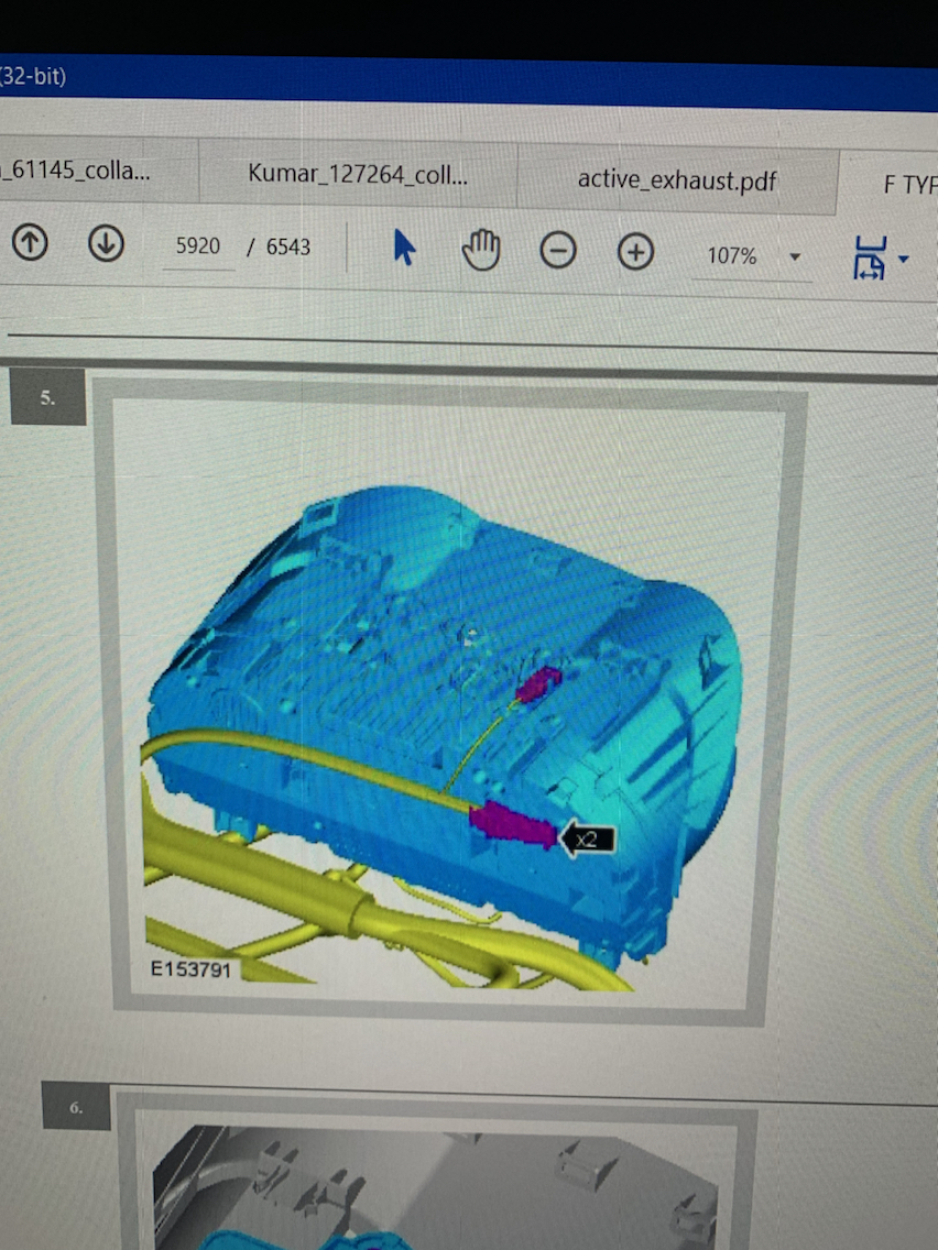

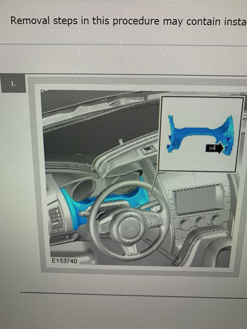

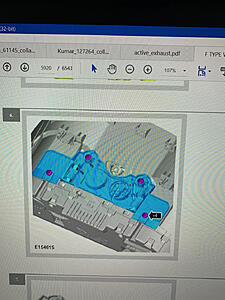

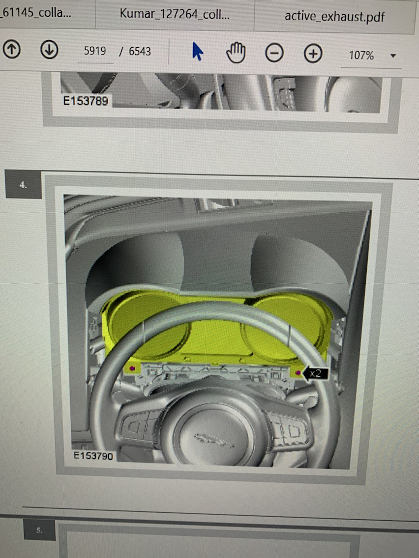

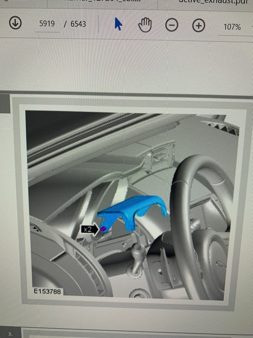

And instructions for removal and refit
F-Type OEM bluetooth microphone issues-photo515.jpgF-Type OEM bluetooth microphone issues-photo877.jpgF-Type OEM bluetooth microphone issues-photo236.jpgF-Type OEM bluetooth microphone issues-photo908.jpgF-Type OEM bluetooth microphone issues-photo706.jpgF-Type OEM bluetooth microphone issues-photo159.jpgF-Type OEM bluetooth microphone issues-photo928.jpg

Thank you for the exceptionally informative post on where to find the microphone and how to replace it. It’s not as simple as I would have hoped! I’m not confident enough to do it myself (I’m terrified at the prospect of breaking a trim fastener) and I’ll probably mandate the dealer to do it.
