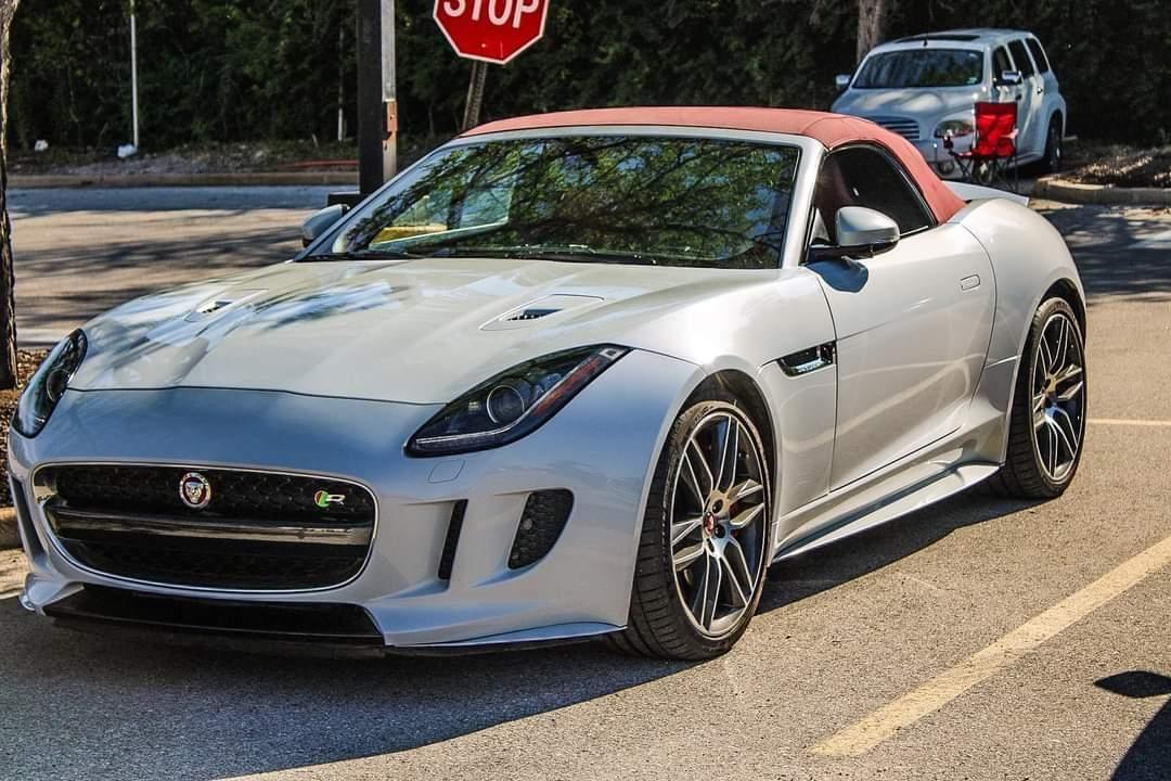

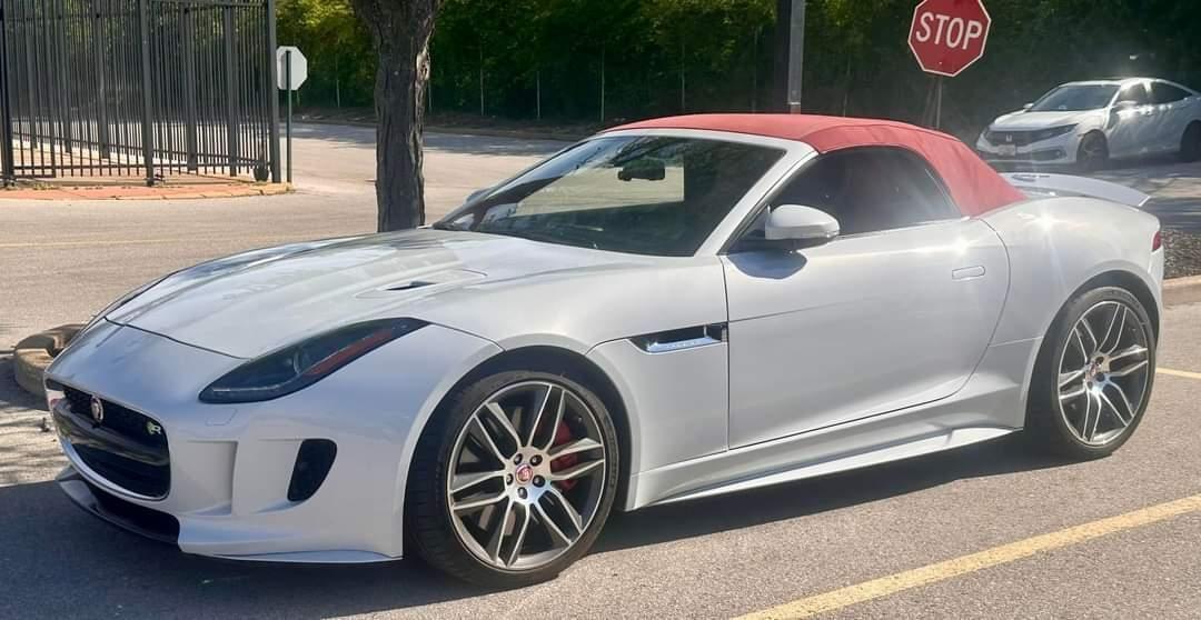

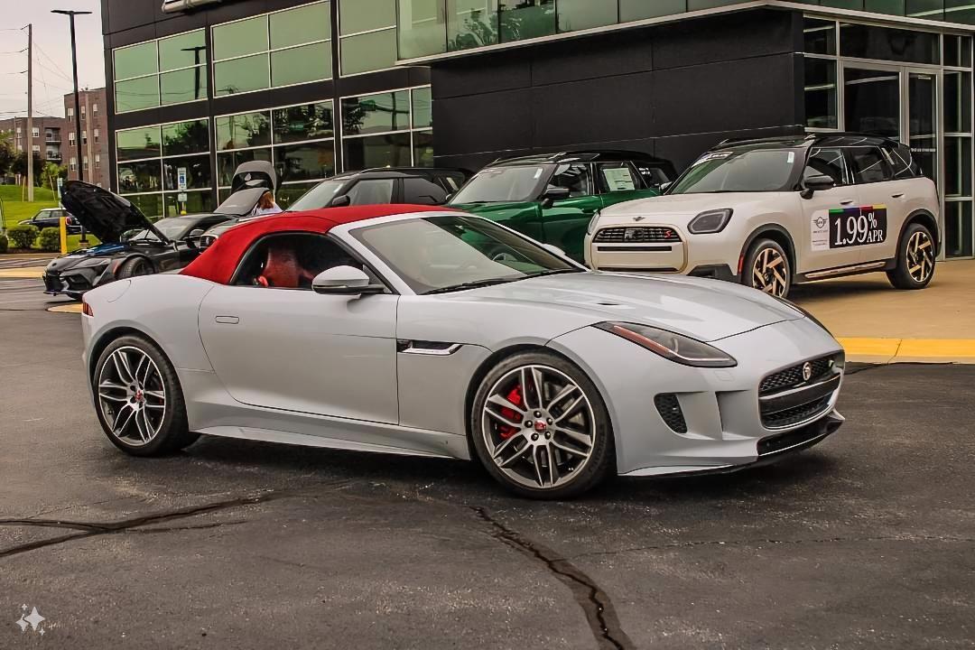

Hi all,
New member to the forums (and the F-Type). I have a 2016 F-Type R AWD convertible; I will attach pictures for reference. I was wondering if I could get some guidance on the type of wheels I have, and ideally part numbers if possible. I had an issue with leaking air on one tire and discovered there was a slight bend on the inner portion of the wheel. I had the wheel repaired by reputable "specialists" in my area and discovered today (after continuous leaking) that their repair job was not good at all (&#128545 and was still the source of the leak. I am concerned that now, after a botched repair attempt, I may have to buy a new wheel. If that is the case, I would like to stick with the same type that I currently have, as I love the look. From doing some research online, I believe they are 20 inch two-tone (silver/grey) gyrodyne wheels (please correct me if I am wrong)? I would appreciate any input/suggestions on a part # and/or where the best place to buy them would be. Any help is greatly appreciated!

Yes those are the Gyrodynes aka Style #6003 when they got rid of the names and went with numerical names.
