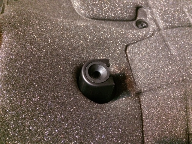

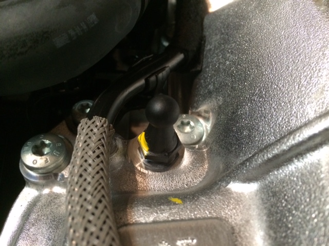

I have always changed the oil in my vehicles. That being said, do you or could you provide pictures/commentary on how to remove the plastic engine cover? I could probably figure it out when the oil filters arrive but I would rather avoid breaking any plastic clips. I will drive the car on ramps and figure out the drain plugs. I see that Walmart carries the Castrol edge 0w-20 in 5 quart containers. Thanks in advance if you can help.
Nothing to taking the cover off and replacing too. "Rubber grommet-over-stud" is a common fitment for engine covers these days. I have the "R," though I would expect to see a similar design for the other motors.
Just place your hands on the cover (on either side), equally spaced apart, and gently lift to release the two grommets on that side. Move over to the other side and repeat to release the other two grommets. Four in total. Cover comes off easily. To reinstall, I simply place my hands around the "J" and the "R" on each side of the cover and gently press to ensure all 4 grommets are properly seated. If you have the cover positioned correctly, you'll feel the grommets reseating themselves.
The pics show the grommet-stud locations. Pretty difficult to break anything. No plastic clips, i.e., no little PITAs to worry about). But, when you replace the cover, be sure you have the cover correctly aligned over the various cover cutouts (especially on the passenger's side) before pressing down on the cover.
