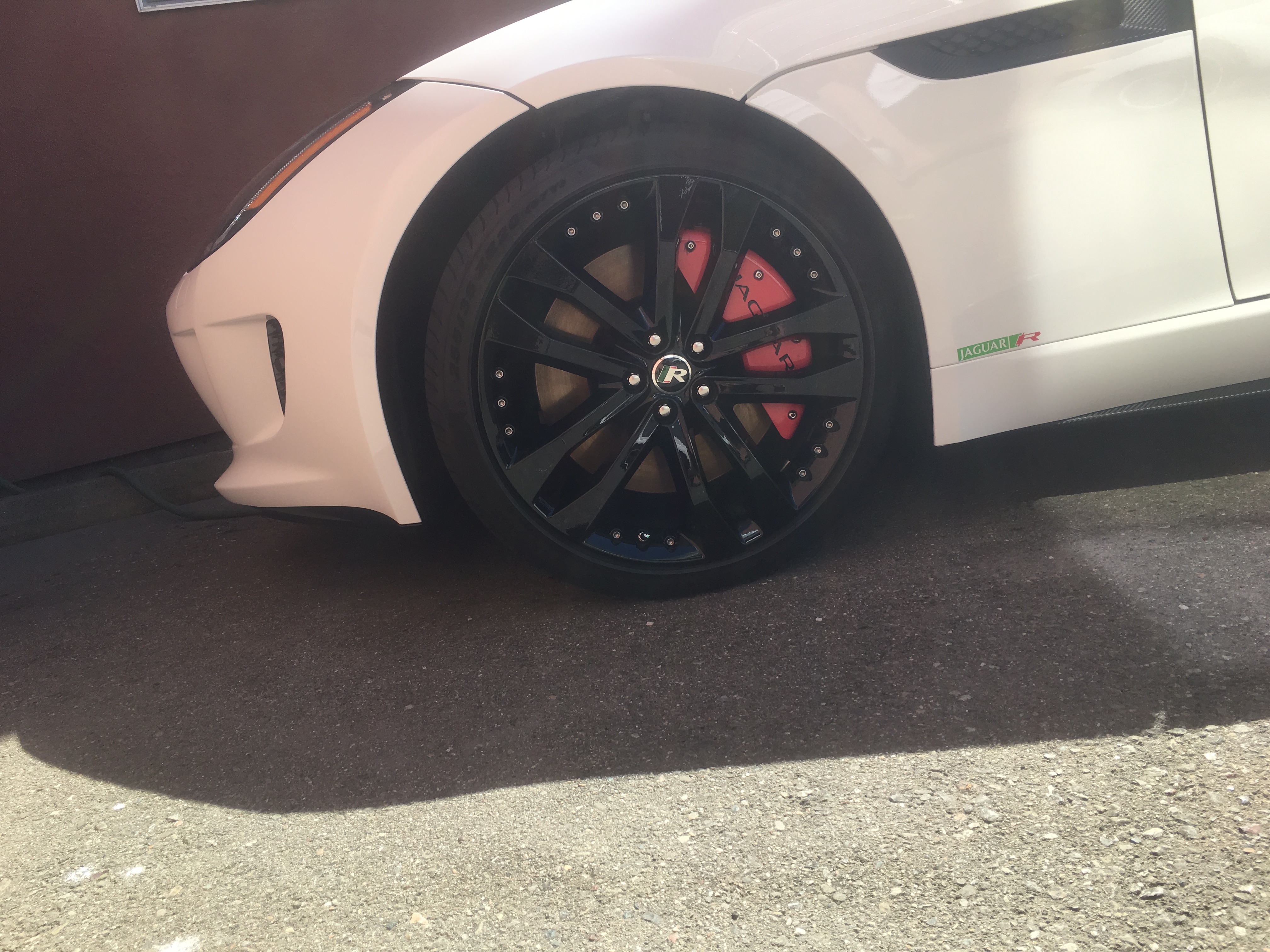

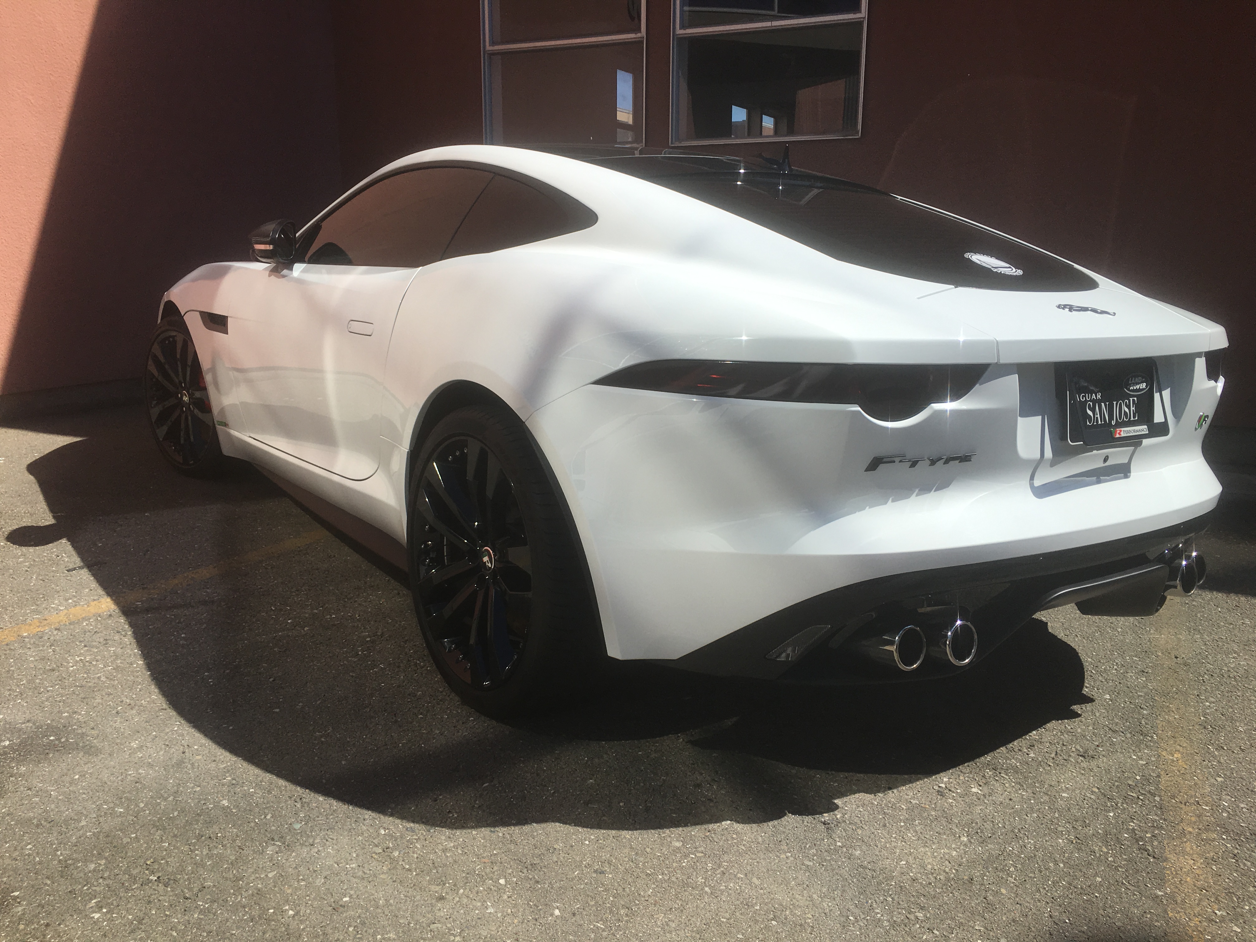

Dwelter, or anyone else who has installed theirs already (mine are still with customs) - could you please take a 2 and 5 o'clock picture from about 10 feet away?
Old Jul 28, 2016 | 06:05 PM
  #183
polarisnavyxj's Avatar
Joined: Jan 2015
Posts: 1,203
Likes: 211
From: SF Bay Area
Default mine on....
Look...
Sweet!

Originally Posted by polarisnavyxj
Thanks for the photo - that has really helped me to visualise what it looks like. I have the same colour car too (not smoked out though).
My set have been released from customs this afternoon, so I'll phone up and pay the charges tomorrow and hopefully get them delivered Monday.
I have the forged storm wheels on mine so I will have to see if they have the same fitment issue. I've got a die grinder handy if needs be. I hope to get the chance next weekend.
