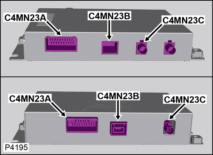

Asian markets don't come with the same satnav (they use an add-on system that may not have been specified from new). Hong Kong may be such a market.
(I recall a member who purchased a Swiss X351 also found it had no satnav. I am unsure why, unless it was originally specified for export?)
The screen is still installed and all the other functions work as normal, but there is no satnav soft button on the screen and no hard button on the surrounding trim.
Your dealer may be able to help you to retrofit the hardware and program it in. I am unsure whether such cars are prewired or not. The add-on satnav modules sit under the spare wheel and look like the attached image (top with 4 connectors is the Japan module, bottom with three (plus SD on the rear) is Asian). You could check to see if you have the connectors present in your car.
