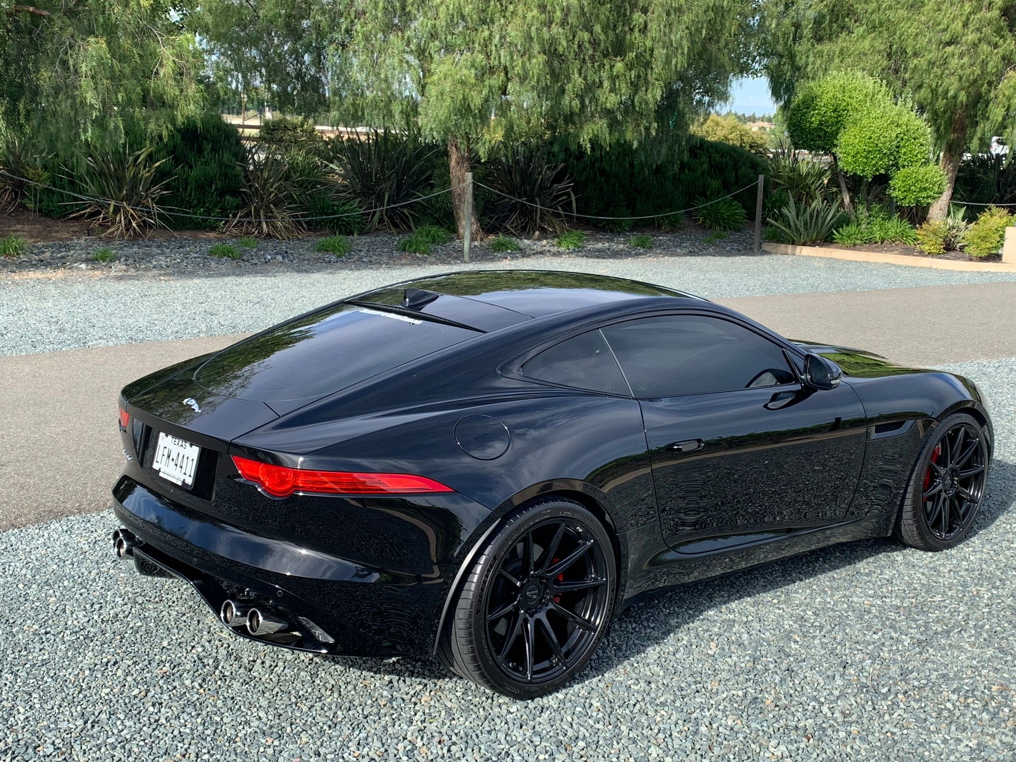

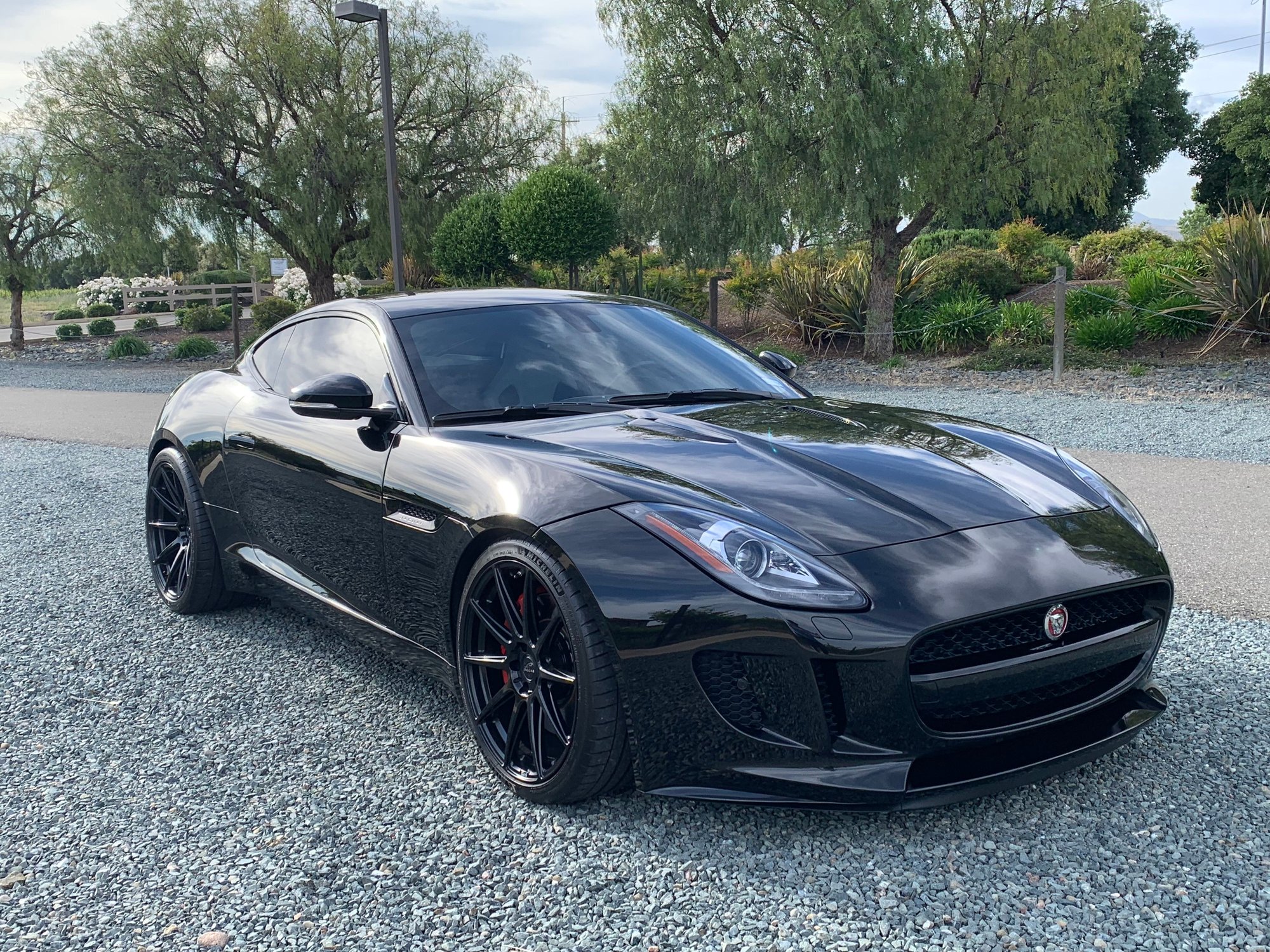

I love the H&R look on mine, the ride does suffer but is also much more stable. It took me roughly 30mins a wheel to install (if i had to guess). easy straightforward install on a lift. does scrub slightly over larger road bumps but not horrible( i also had the 17mm spacers).

thank you!! 20" fronts are 10.5 (265 tire) and the rear are 11.5. (305 tire) i can't remember the offsets but i do have them someplace if you need them.
