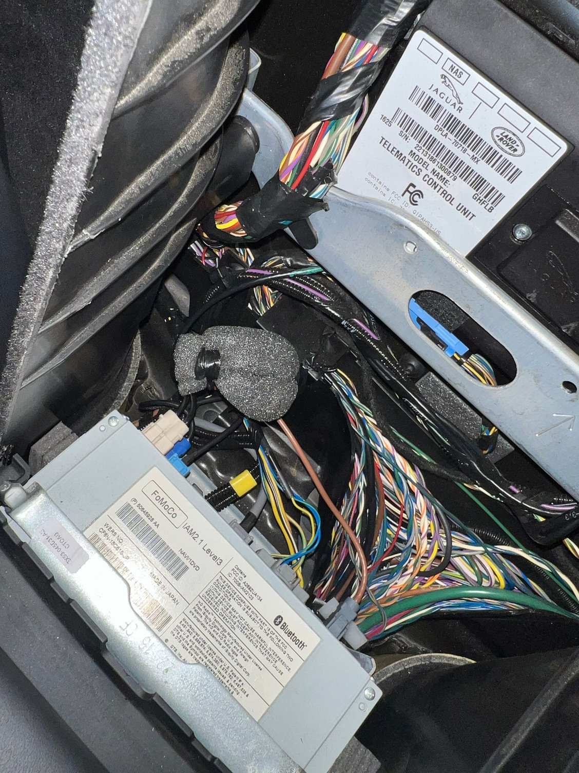

No buzzing on my 2016 coupe with UAD over Aux.

Does this look vaguely like everyone else’s unmodified audio system (IAM 2.1 w/Bosch and Meridian 770W)
Theres a weird looking splice or something on one the yellow wires going into the IAM and I’m pretty sure those are the AUX wires. Potential source of my buzzing audio.
Either way, for now I’m using Phone -> Jaguar bluetooth audio in addition to CarPlay which is a decent solution except for navigation audio doesn’t work. Hopefully soon InCarSolutions will enable the BT audio output on their module for me and all of this will become irrelevant.

Using Bluetooth to send an audio single to the jag OEM input is picking the worse signal path. If you are happy no problems but it’s like choosing SD tv channel when you have the HD available. Hope you can sort out your humming.
