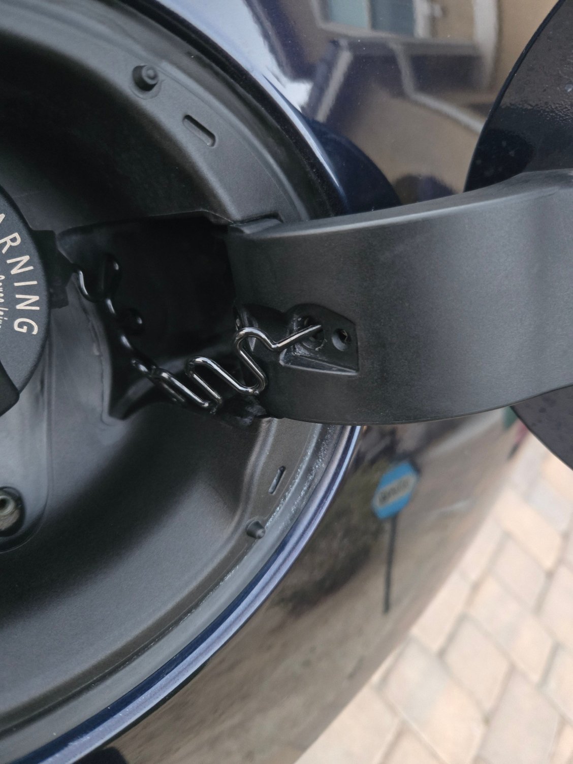

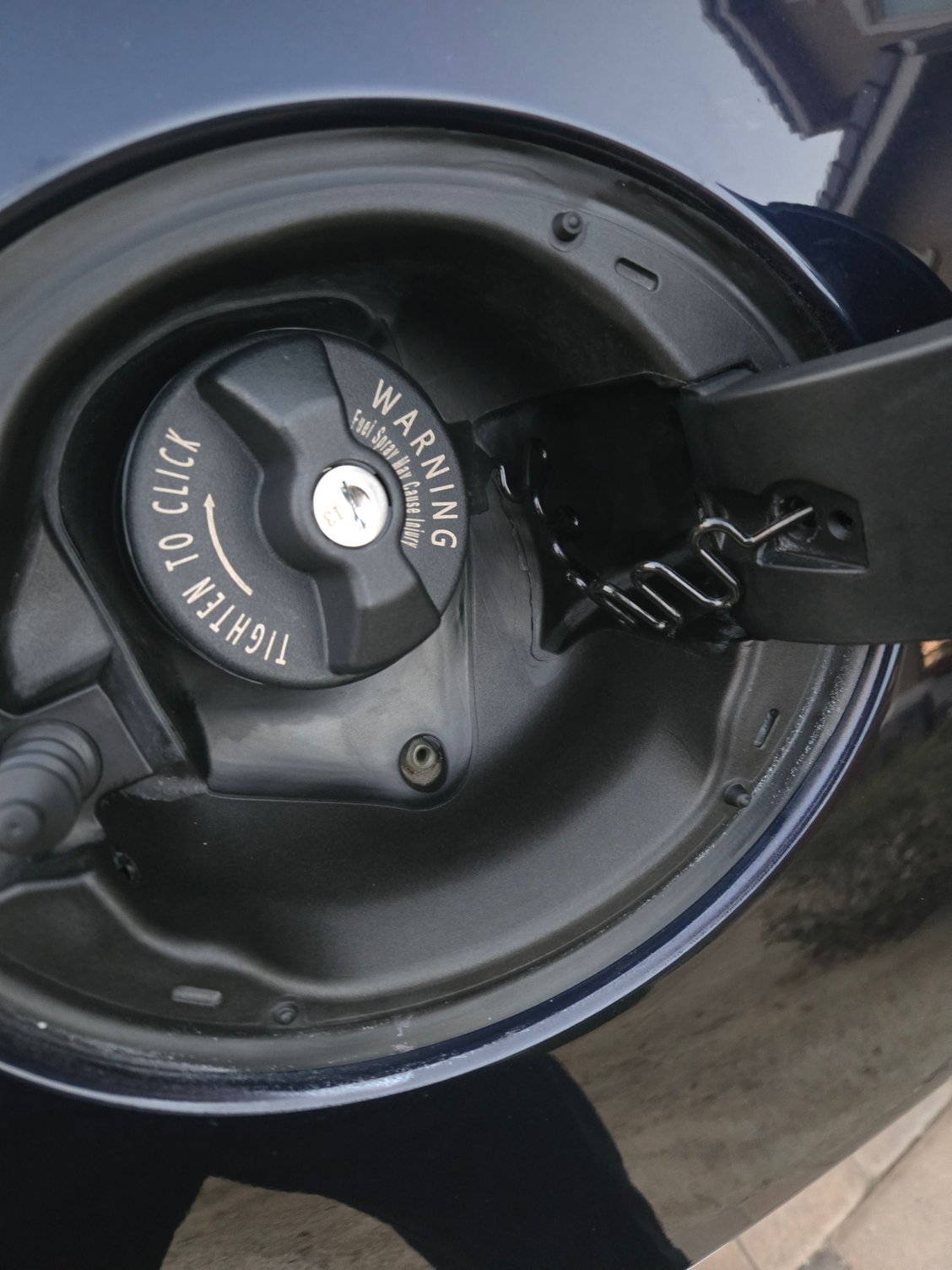

I am going to give this one a try since it looks almost exactly as the one you posted yet it has a leash of sorts. I wonder if the end can somewhat fit in the hole left by the OEM leash.

I just got the Moto Rad 10508, snipped the leash a little, pushed the ends together and into the hole left by the old OEM gas cap and the two ends I made spread open to hold it in place. This is what it looks like now. So far so good, no codes and the leash holds. Will report back if any problems.
