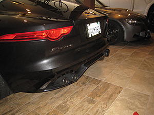

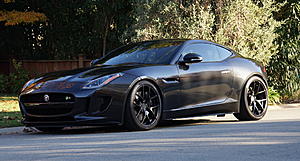

Default These might be close to what you want to do...
Originally Posted by indietor
im looking in all the forum for a pic of stratus gray lowered spacers black wheels and paint black gloss the side vent the window border and front grille
First 4 pics are mine (bronze wheels), the last pic I found online that has black wheels. Might I suggest black or wheel colored emblems and black exhaust tips to complete the look?
Attached Thumbnails my f type mod-jag-f-2-2-.jpg   my f type mod-jaguar-hre-wheels-2-.jpg   my f type mod-jag-f-hre-wheels.jpg   my f type mod-img_5318.jpg   my f type mod-jag-f.jpg

beauty !!
it's what i want do also with black wheels (that i have but propellor 19'' ) at moment and im not sure i love it
i want to do also black the leaper and the f type logo back
so in the pic what is the name of the wheels can i add the jaguar center caps ?
are you on vap springs or h&r ?
295 or 305 back ?
spacers 15 right?
295 or 305 back ?
spacers 15 right?
VAP Springs, 295 rear, 265/30/20's front . No spacers, wheels were made with correct offset. HRE's - crazy expensive, but the previous owner of the car got them at a huge discount for allowing marketing photos. The satin bronze looks great against stratus grey, but a black or graphite wheel would be awesome too. Check around on the forum, there are lots of wheel choices - Ferrada seems to be a good value wheel.
Good luck and have fun....
