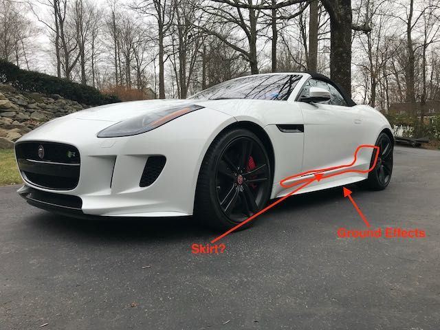

Just picked up a 2017 F-Type R yesterday with 12K miles on it from a Jag dealer 360 miles away from my home. Carfax read clean and the only questionable item on the CPO checklist was the rear brake pads were at 9mm and fronts at 11mm. I already posted another thread asking if this was normal as i've never heard of rears wearing faster. The dealer told me this is common for these cars?

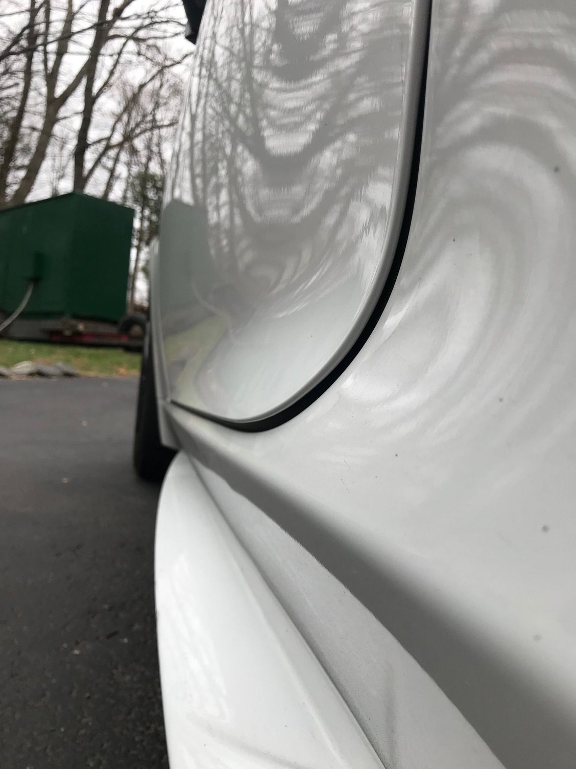

This morning I notice this misalignment on the drivers door. Operation is fine and rest lines up fine. I inspected the underside of the car on a lift before receiving and it honestly looked like a brand new car. Almost spotless! Same goes for rest of car. So far everything else looks and performs great as well. I've sent an email to the dealer and waiting response. I think anyone that has purchased a pre-owned worries about being sold a bad car. Or am I just being paranoid?

I can speak to the mis-aligned door. That is common and easily remedied. Sometimes a mis-aligned door is just that, nothing more.

The misalignment between the door bottom and skirt is so common as to be "normal"...and with regard to the brakes:. The rear pads wearing faster than the front is also "normal" (it was the case also with the XK) and does not indicate any fault.

On the door jamb of each door you will see the door latch retainer, sort of U-shaped with a dent in the middle.
Each one is held on with two Torx T40 bolts.
Loosen those two bolts off a bit, not a lot, just enough so as you can move the retainer up/down in/out a mm or so.
Then push the retainer in (towards the seat) about 2 mm then tighten the bolts up and test.
Pushing the retainer in should bring the bottom edge of the door shut in closer to the panel.
This worked for me but of course YMMV.
You may have to play around with moving the retainer in and out a couple of tenths of a mm at a time to get the best possible fit, and even then you may not achieve perfection.
I suggest you also mark the edges of the retainer (eg with a felt tip pen) before you start so you can set it back to how it was originally if you need to.

I took a quick look and will get more into it tomorrow. But at first glance it seems the flat head bolts sit in countersunk holes in the retainer. So unless its a through-hole with a nut plate on back, it will go back to center as soon as it's re-tightened. No?
I see how the retainer is closer to the bottom 1/3 of the door (where the misalignment is), but would making the adjustment as recommended pull the whole door in creating a misalignment on top? Not trying to question your experience, I just tend to try and think things through before picking up a wrench and getting myself into trouble.

No. It's designed to be adjustable, and will stay where it's tightened.

+1.
Mine definitely stayed where I moved it to and didn't "spring back".
I suspect there is a mounting plate behind which moves with the retainer.

Tried it earlier today. End result is the vertical seam along back edge of door and top horizontal body line gets thrown off a little, with minimal effect to the bottom. Think I'll take it by a body shop and see what they say. I've heard aligning doors can be a bit of an art.

The alignment issue is not with the door - it is with the skirt below which needs to be massaged outward a bit. Your door was probably perfectly aligned with the rear fender, right? It is very, very common - almost the rule, that there is a slight misalignment at the door/skirt area. After examining many, many of these cars I came to the conclusion that it was virtually "normal" if not desirable. It is a non-issue on dark colours but more noticeable on white and silver.
The panel I have marked as skirt? I notice screws holding the ground effects in place, but are you saying the Skirt has screws under sill plate and under car that can be adjusted?

Yes, there is some adjustment for the skirt, apparently. I have not needed or felt the need to do this on my BRG car but I think there was a tgread on this some time ago.
