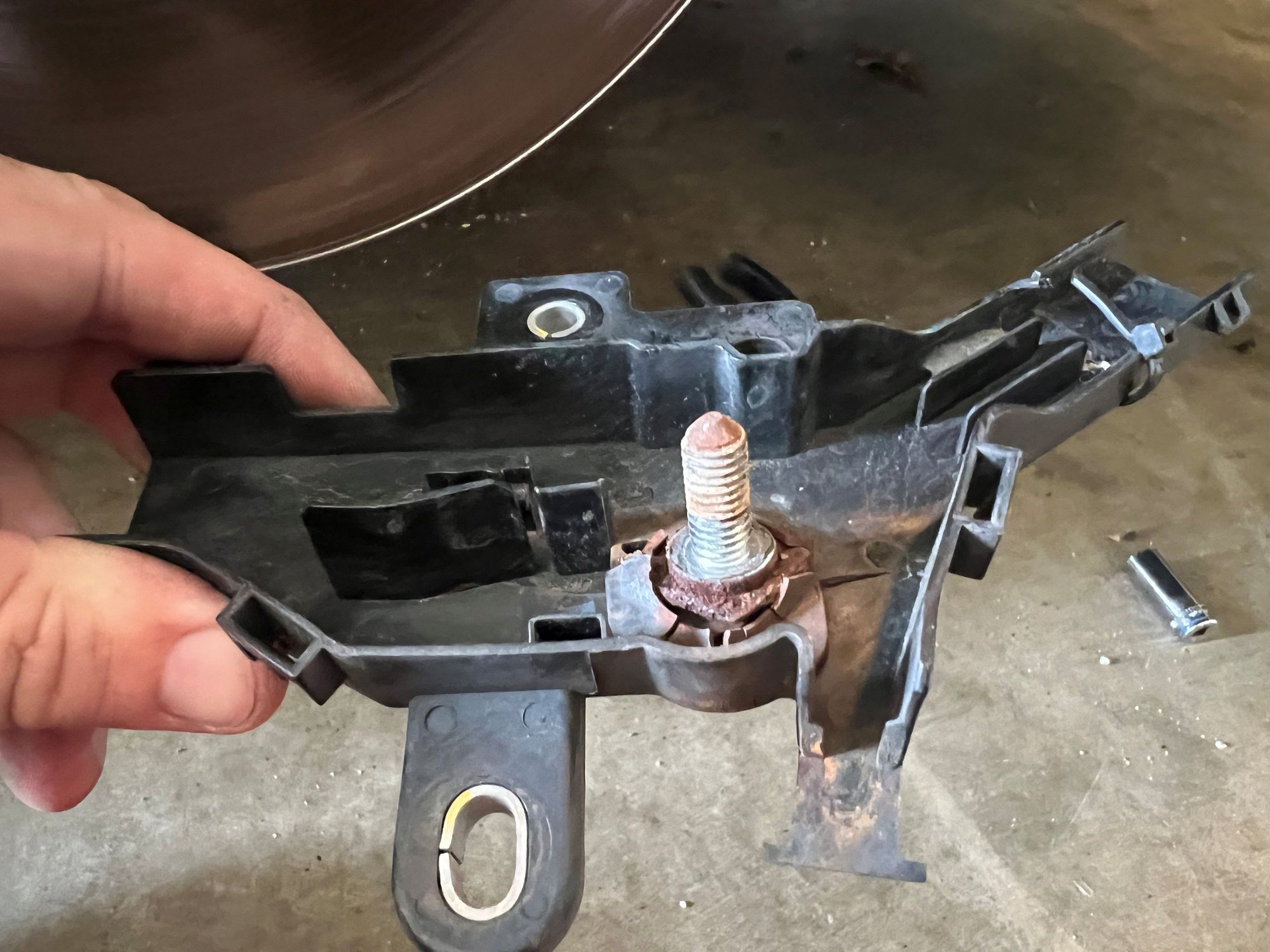

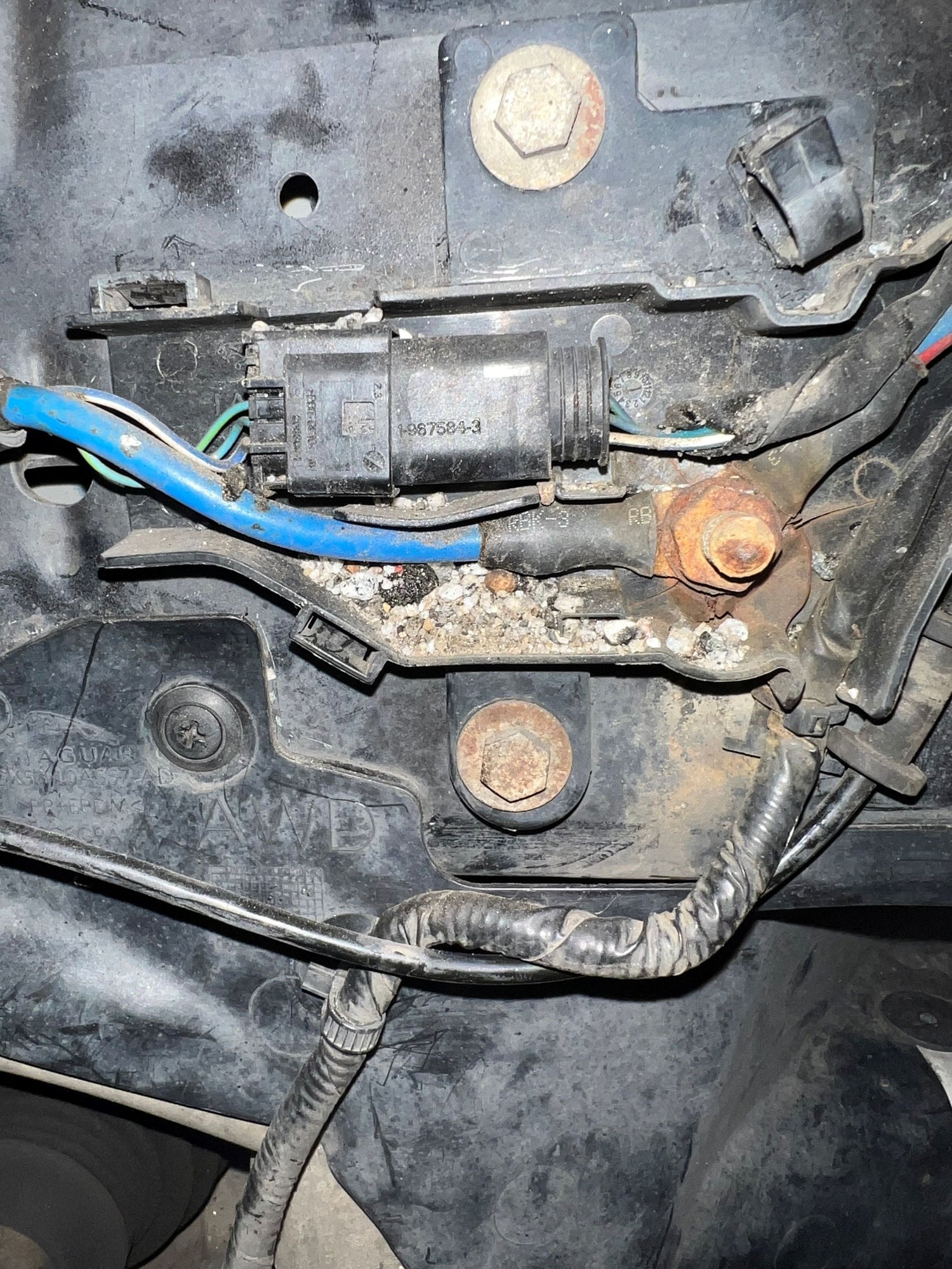

Well, I took the junction box off behind the passenger side (US) tire and this is what I found. The box was cracked and the bolt was completely rusted. The corrosion went all the way through the junction block to the frame and has started to rust the frame. I have to clean all of this and replace the junction box. NOW, just for everyones knowledge. The junction box is not sold separately by Jaguar. It is part of part number T2R14519 and costs around $4,631.00. It is part of the electrical harness that goes from the back of the car to the front. I found one online from a junked car and when it arrives I will install it and see how/if it works. Wish me luck.

Glad you found it, seems like we were in the right area. So glad I don't get cars that corroded down here usually.
