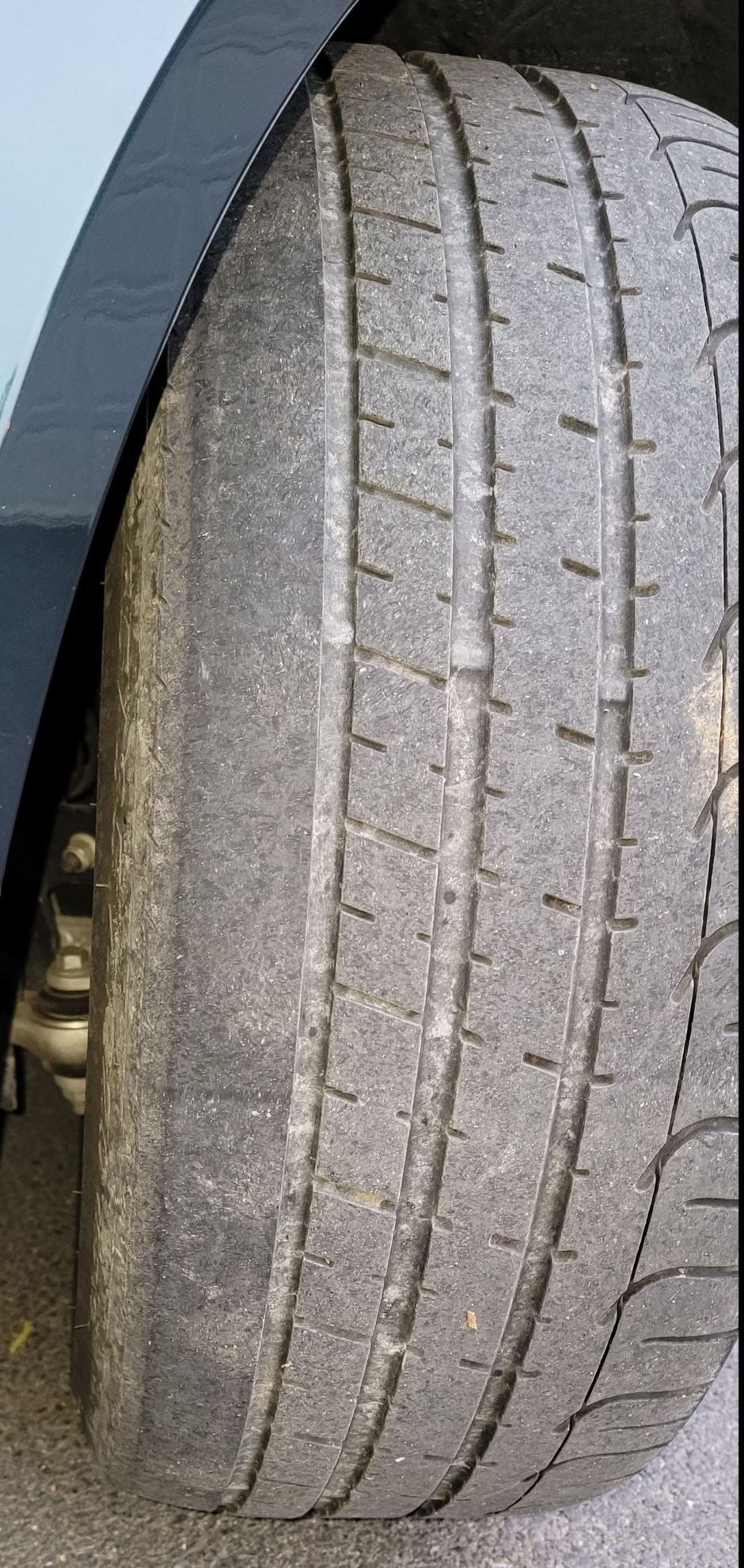

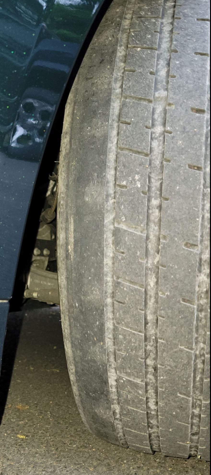

Many tire and tire wear threads on here but since this one is active now, I’ll add my story here. Bought my new-to-me MY18 coupe in March of 2020 with 10,800 miles on it. I am second owner and pretty sure the Pzeros that were on it were the factory originals. Since then, I have only racked up another ~12,000 miles on the car; sitting at 22,700 miles when I had to replace the two front tires due to excessive wear on the insides. (pics attached) One side I had cord showing(!) and that was very concerning.
I was very surprised to discover the wear. The rest of the front tires, and the rear tires, seemed to be wearing just fine – still above the wear bars and otherwise even. I had no negative sensations in the car and no complaints with the handling. It always drives like a dream, although I don’t tend to push the traction limits very often, and I avoid rain/snow at all possible. (the FT is my pleasure car, not a DD) Even so, I eagerly had a set of PS4S installed and had my Jag dealer do a 4 wheel alignment as I didn’t want to chew thru the expensive PS4S as fast as this. The values were basically pretty good, but they did tweak a few numbers in to spec.
Once I rack up some driving time I’ll report back on whether I can tell much of a difference. According to the forum consensus, I should, as the Pzeros are constantly labeled as cr*p here and the PS4S praised.

@Clutch I would look into an alignment, that wear is not normal on the inside like that.
Old May 30, 2023 | 12:13 PM
inmanlanier's Avatar
Joined: Feb 2017
Posts: 315
Likes: 61
From: Palm Beach Gardens, FL
If only the inner edge on the front, the wear is indicative of excessive toe-out OR excessive negative camber. Toe out would reduce your strait line directional stability since the tires would fight each other to be the one tracking strait. Excessive negative camber should be readily observed from the front of the car. Unless you did track time (where you are braking alot), I'd be surprised you'd have so much camber to result in significant asymmetric wear.
Can you share your as-found and as-left alignment numbers with us? I'll be able to opine with a little more basis if so.
On a related note, my original PZeros were gone at ~13,500 miles. I had two track events on them by then. They were greaseballs by the 2nd half of my first track event. They were so greasy the 2nd time I thought grandma was in the front seat (traction control interference).

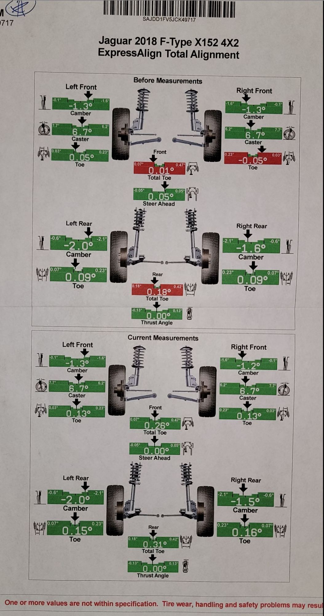

Old May 31, 2023 | 05:56 PM
Clutch's Avatar
Joined: Mar 2020
Posts: 105
Likes: 41
From: Virginia
Hey guys - sorry for the delay. Yep, been meaning to post the before/after spec sheet they gave me. See below. (Don't know how to make it smaller, so sorry for the large image.) Sadly, I have not had a chance to really drive her yet, except home from the dealer.
