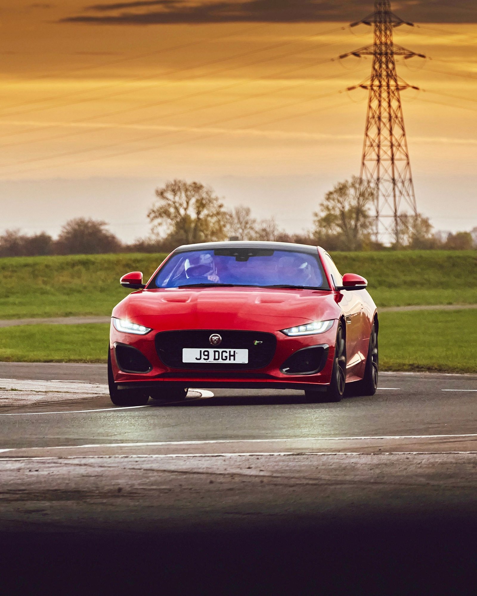

I’ve got a UK October 2019 (date of 1st registration) V8 R AWD which was registered by Jaguar 2 months before the MY21 facelift was announced in early Dec 19, but is officially an MY21 facelift. It’s basically an SVR (that was discontinued when the MY21 was launched) but manages without the titanium exhaust system. The box and 575 engine is mapped as per the SVR, and the suspension is upgraded to SVR spec. The front wing (fender) bodywork from the SVR is not included, or the fixed rear wing, but that not a problem for me.
For the geeks out there, the door tread plates say ‘Jaguar’ rather than ‘R’ which I guess dates it before the public launch, but as far as I can see it’s otherwise an MY21 with all the useful bits of the SVR spec, plus the interior digital upgrades that came with the facelift. And it’s c£15k less than buying an (older and pre facelift) SVR, tho you can find pre facelift SVRs registered in 2020 that must have been hanging around at the factory or on dealers showrooms.
I’ve tried to find what Jag used my car for but with no success yet….
