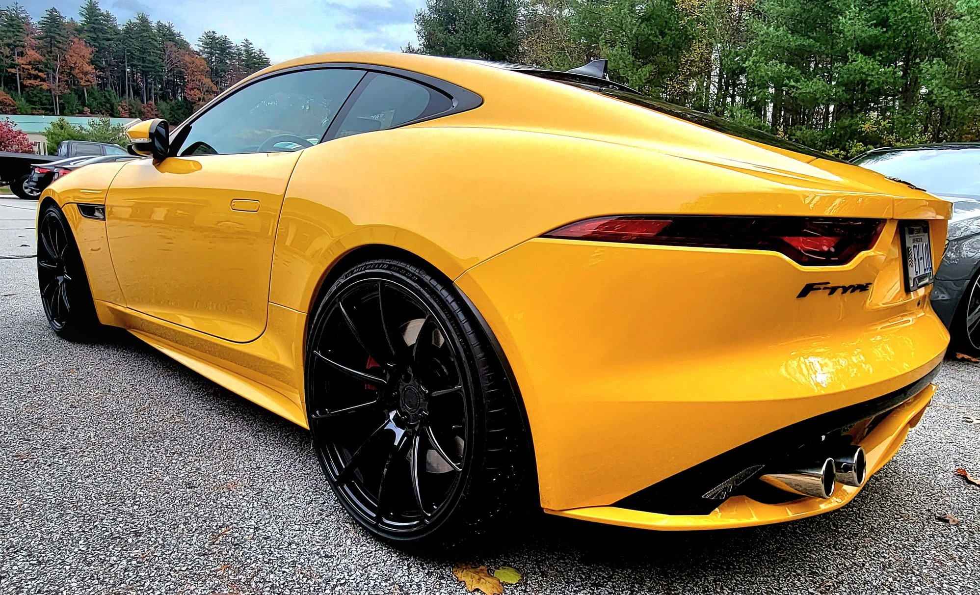

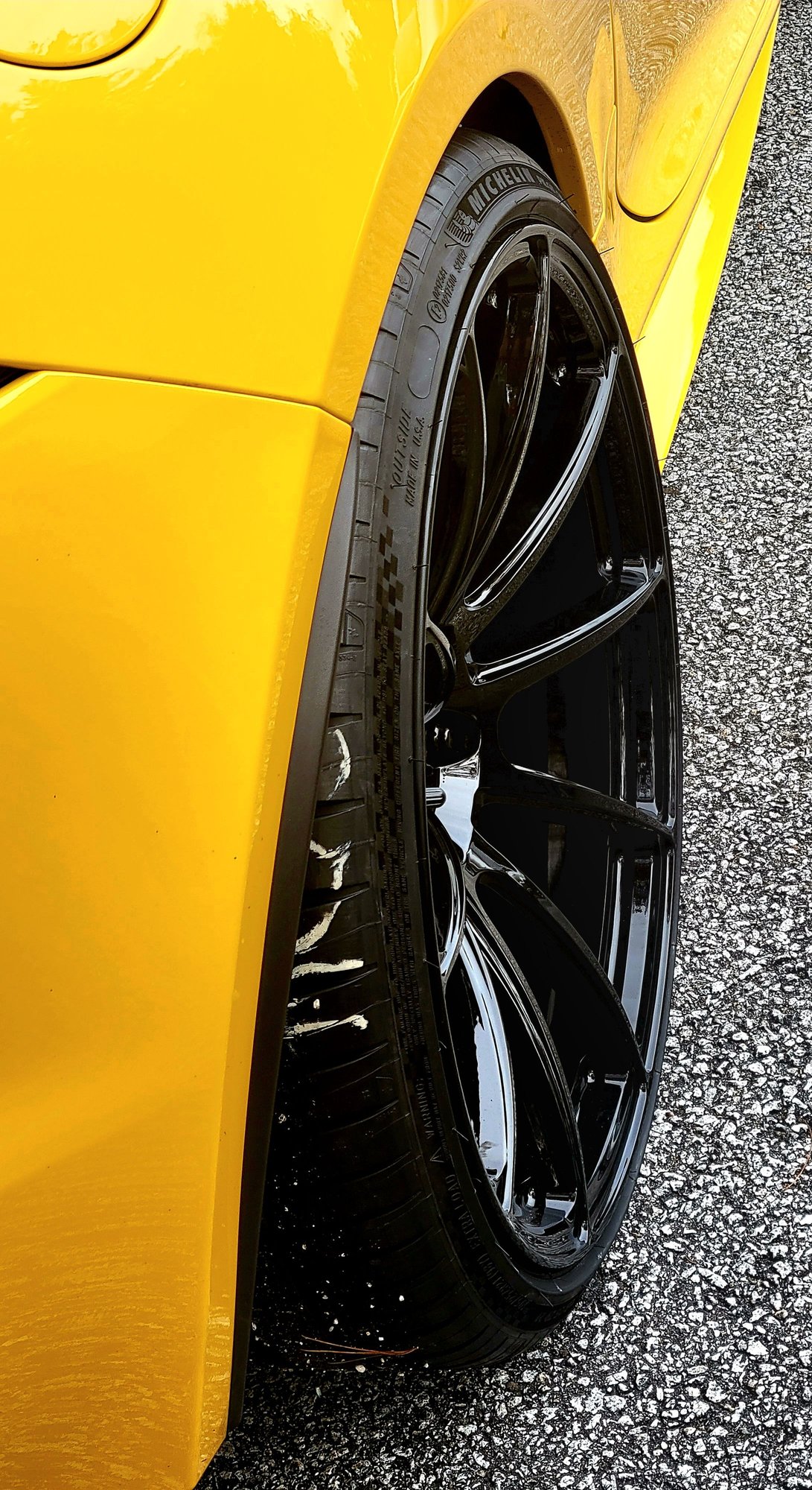

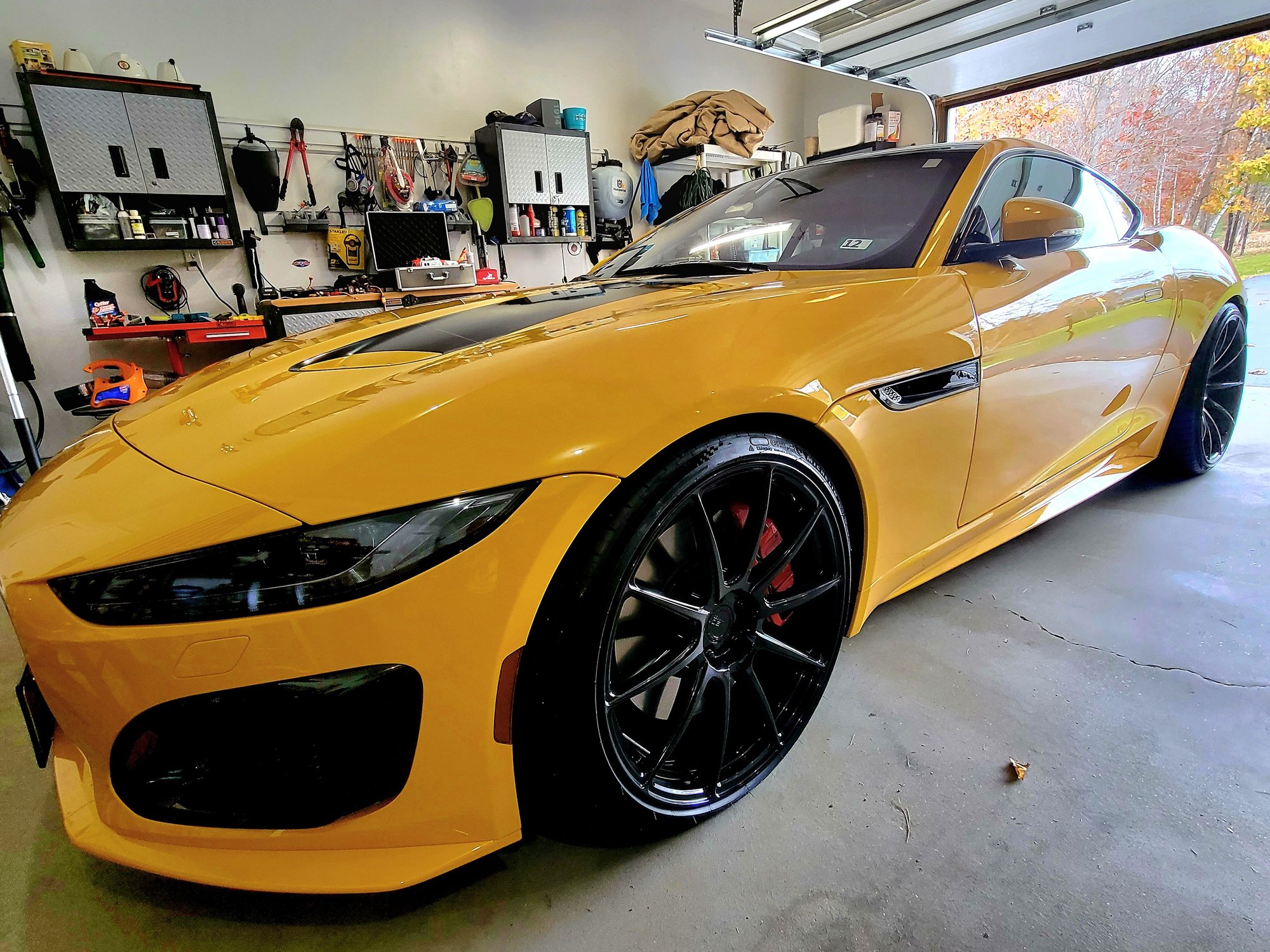

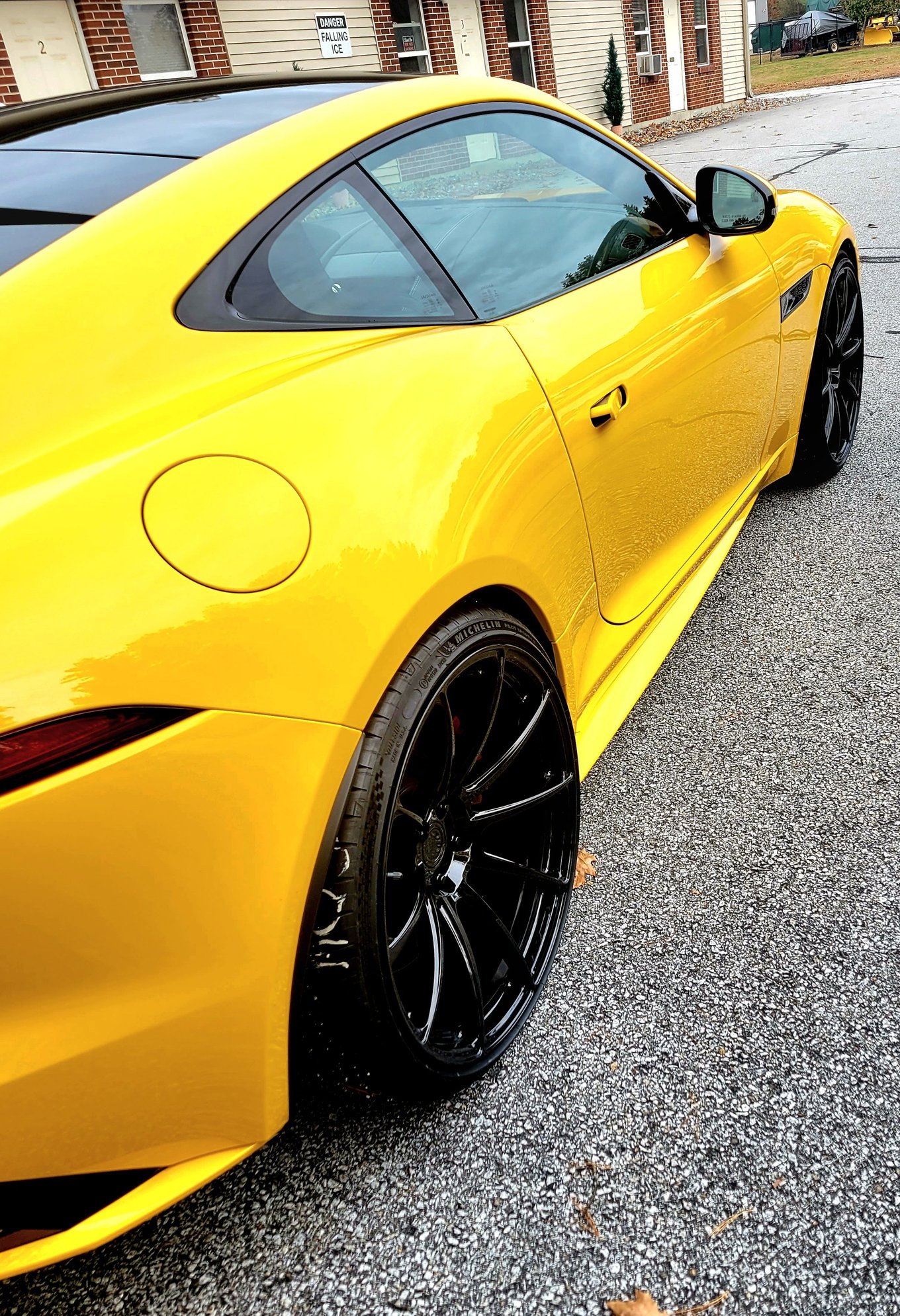

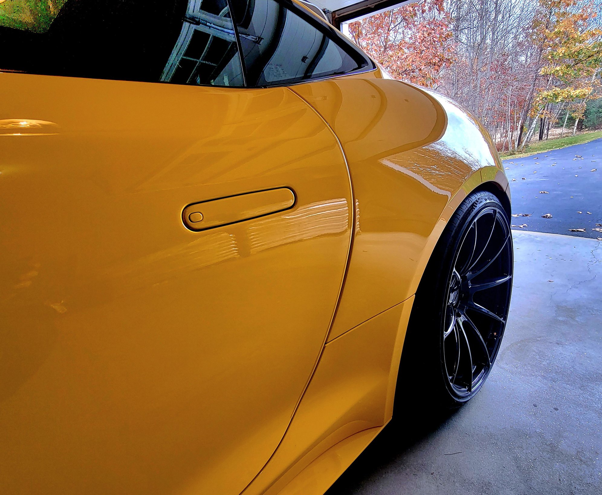

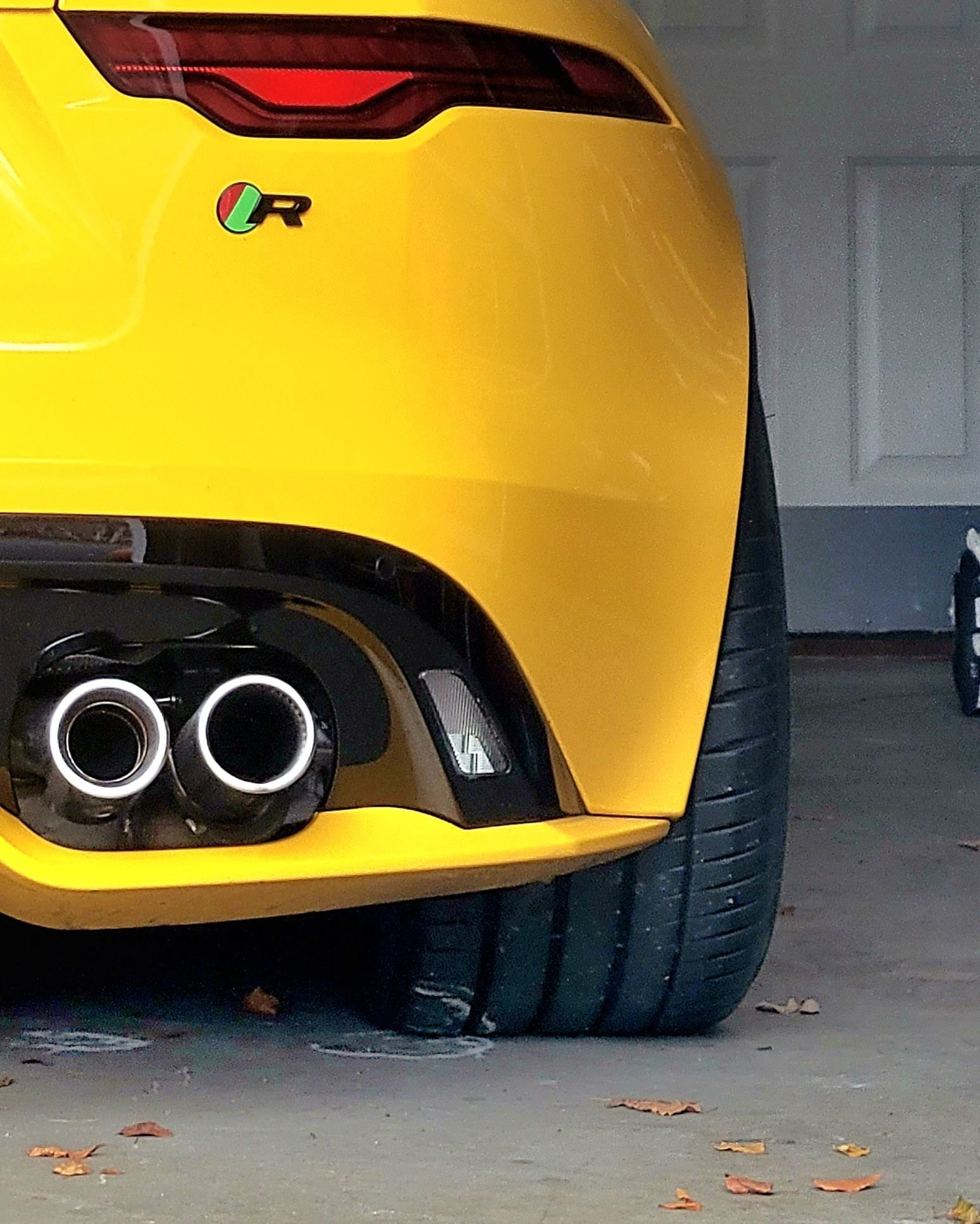

Here are some early, crappy pics of the setup. Winter is here already, so the Jag will be in hibernation for a while unfortunately.
Here are the specs:
KW Height Adjustable coil overs
BC Forged RZ10 monoblock
21 x 9.5 +45, 21 x 11.5 +30
Mich Pilot Sport 4S
265/30/21
305/25/21

For anyone wondering, the ride is firmer from the springs. Not much of a change in ride between the stock 20s and 21s. Handling though is better, flatter cornering and feels grippier with the Michelins.

So the springs are just that, i presume, if you still have the option of dynamic mode.
You have the has spring kit which is adjustable but its not a coilover kit!!
Wheels look great by the way.
