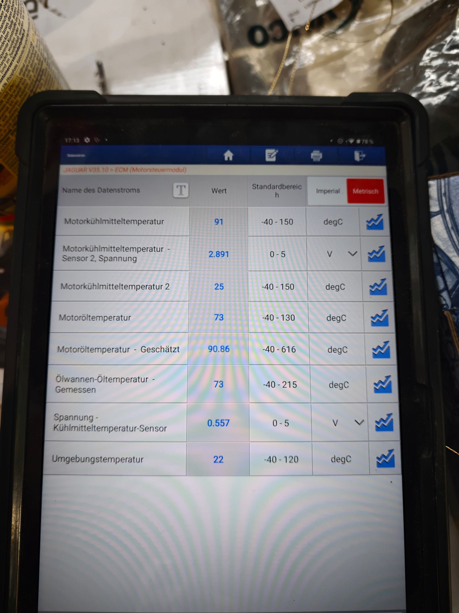

Does anyone have documentation showing the location of ECT sensor 2? I have trouble believing it would be called an Engine Coolant Temperature (ECT) sensor if it was designed to measure ambient air temperature. (The V6 has 2 ECTs plus an Ambient Air Temperature (AAT) sensor.)
For those following along, my phone translated Andi’s pix…

The installation location is crucial: whilst the ECT1 sensor (primary sensor) is usually mounted directly on the engine block or cylinder head and measures the temperature directly
at the source, the ECT2 sensor (secondary sensor) is located at the radiator outlet or in the return hose on many modern vehicles.
The closed thermostat: As long as the engine is running warm and the thermostat is still closed, the coolant circulates only in the ‘small circuit’ within the engine.
The radiator remains ‘cold’, and the coolant at the ECT2 sensor moves little or not at all. The sensor therefore often displays only the ambient temperature or only a very slow rise.
The opening of the thermostat: As soon as the thermostat opens, the ‘large circuit’ is activated. Hot water from the engine now flows abruptly into the radiator. It is only at this
moment that the hot coolant reaches the ECT2 sensor, leading to a rapid rise in the measured values.
The ECT2 Sensor is in my view not defect or bad. Perhaps the thermostat or the relais is the problem when the cooling fan goes in a high run after 10 minutes

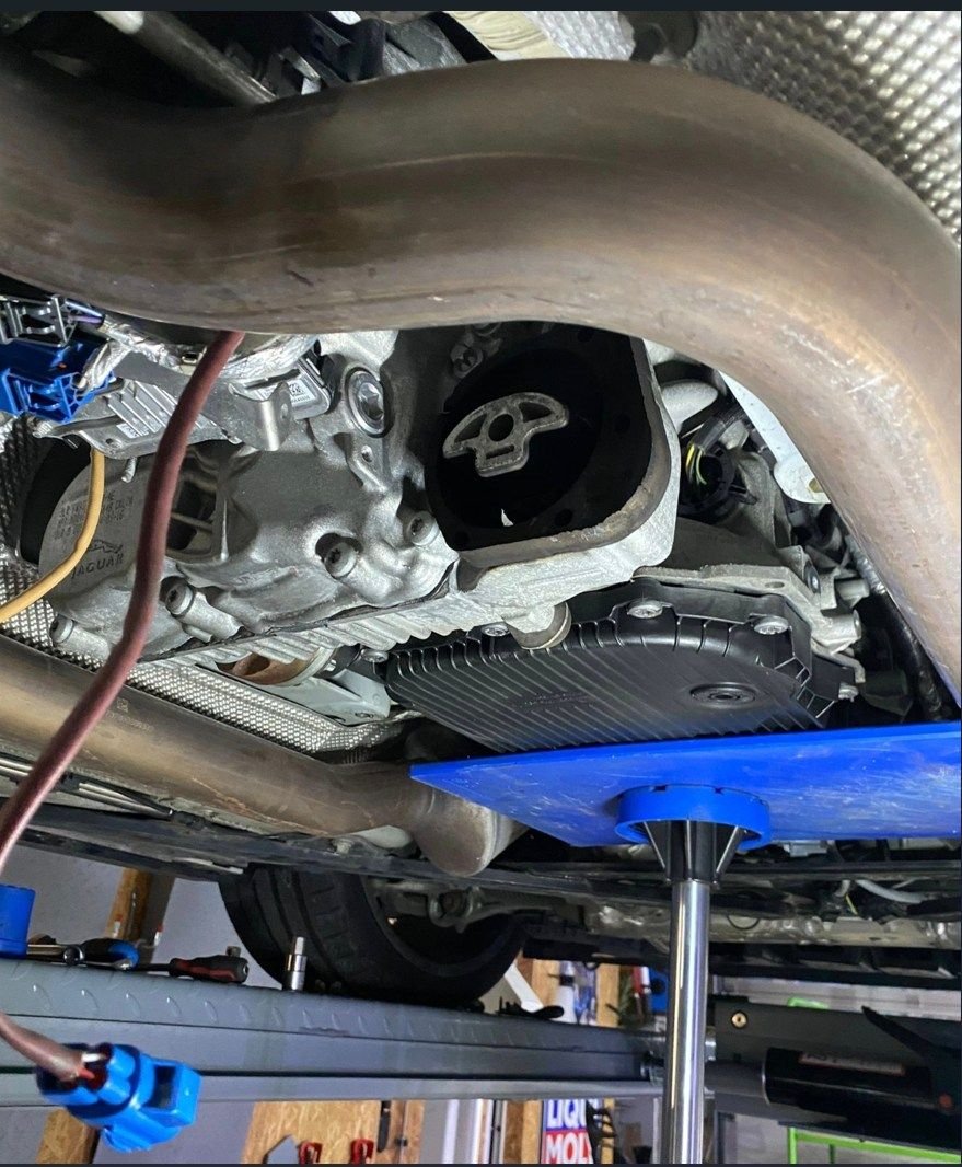

Didn't see this earlier, I will try to see what I can do to help. Was the engine raised/transmission lowered during the fluid change? You mentioned using a telescoping arm on the transmission, I assumed the support crossmember was moved and the trans lowered slightly to drain the oil? This could have pinched or damaged wiring if the engine was tilted too far.
ECT1 is on the rear heater manifold, ECT2 is down by the thermostat housing in the lower radiator hose area. Since your readings are off, I would inspect the wiring going to the sensors, and the values back at the PCM for the matching wires. If the shop you're using has OEM workshop manuals they should have no issue tracing that connection.

So if you lowered the transmission down, it raises the front of the engine. Can cause any sort of issues. I have seen on a Rover with a belt driven engine fan, the fan hit the shroud and caused other issues. Not the case here since it's an electrical fan, just to mention it.
I think you're on the right track with the engine coolant temp sensors, can you log the values of them, also the oil and air temps, from a cold start? Do they all match when cold, and does the coolant temp go up gradually in line with the other temps?

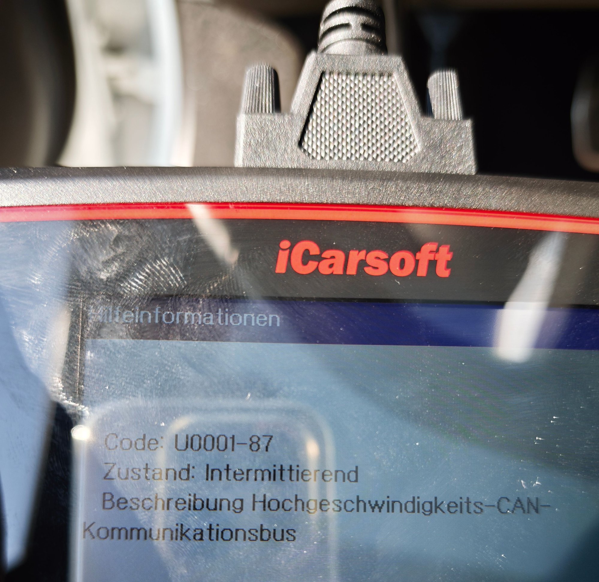

I have an Error Code since one or two years, but no problems with the cooling Fan in this time. Here the Code, sorry in german language.
