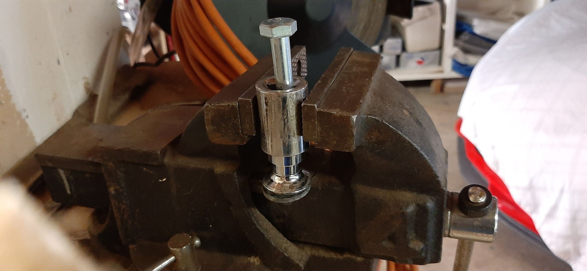

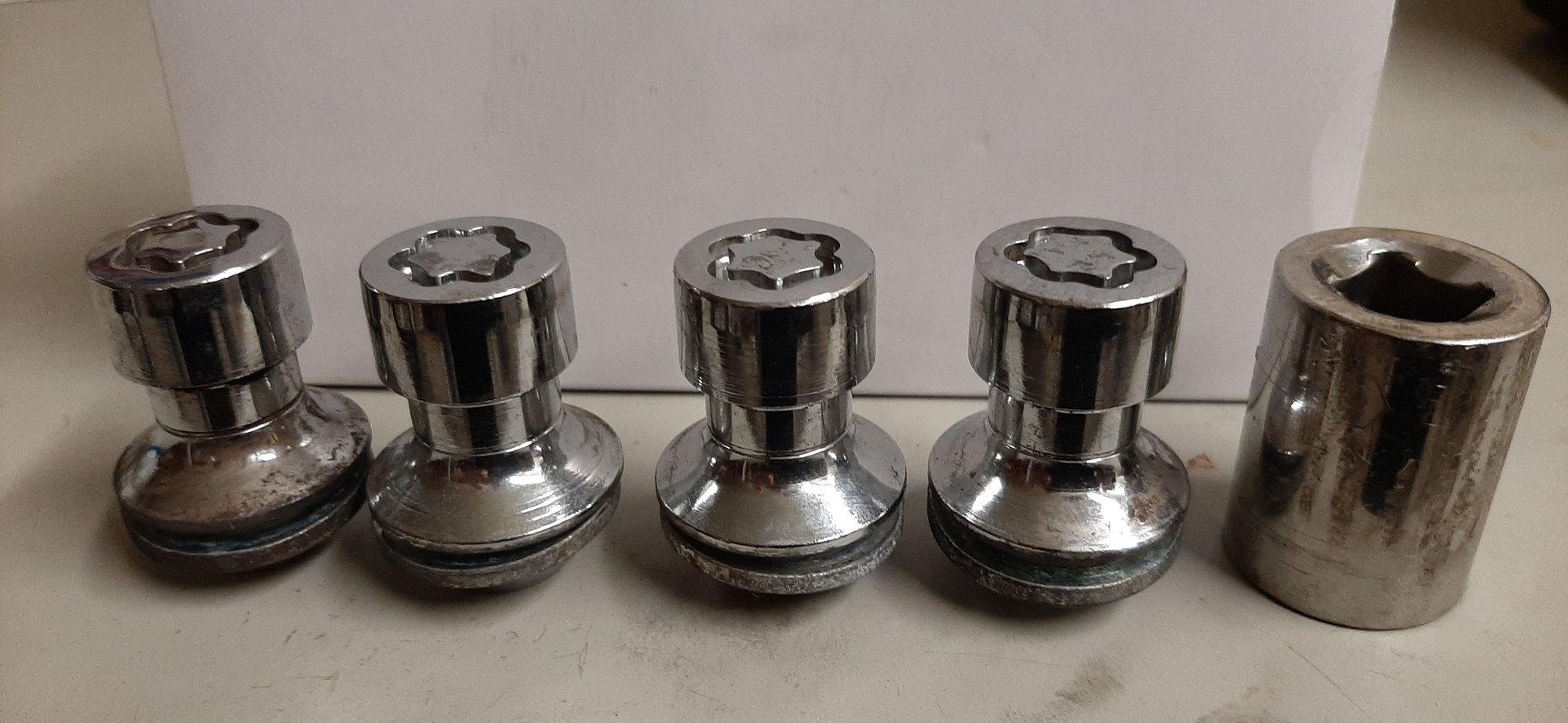

Once I drove my newly purchased F-Type R home all the way from LA (7 hours drive) I realized that the car did not have the key to remove the wheel locking-lugs. A 2 hours round-trip drive to my local dealer was also unsuccessful; the serviceman tried probably 60 different lock keys and none of them fit. Alarmingly, he stated that this happened before in his experiences. I suggested that I was not sure but, likely they were Jaguar installed locking lugs, since the window sticker listed those under the options. Still, I was stuck with wheel locks without the means to remove the wheels.
Once home, I decided to try the removal method that requires a specific size, 12 point socket to be hammered over the smooth, cylindrical lug tightly enough to break that lug loose. I do have extensive sets of tools and the only one socket that was close enough to be hammered over the locking-lug was my Metric, 21mm size. The equivalent closest Standard size would be 13/16 but that fit proved to be too small to go over the locking cylinder.
I tried to hammer the socket only partly over the locking-lug cylinder. No luck, the socket simply spun and came off without breaking the lug loose. I used a 4 lbs hammer to pound it fully over the locking-nut at which point all 4 locking-lugs came loose.
But, that was the easy part! Removing the locking lugs from the socket proved a lot harder. Due to the unusual shape of the Jaguar locking lug, the only way I could try to remove them from the 21mm socket was to place them in the vise super tightly and use a bolt through the socket to beat out the locking lug. This was very difficult, as the locking lugs were now seated very tightly in the socket. The most difficult one took a good 30 minutes of beating with the 4lbs hammer to finally come out.
As the pictures show the Jaguar lugnuts are unique in their mounting. While most other lugnuts use a cone shape surface that mates-up with a similar cone-shape wheel seat, the Jaguar lugnuts use a smaller cone at the end of the lugnut to center the wheel but, the actual mounting surfaces are flat both on the wheels and on the lugnuts. So, no doubt that I had a Jaguar locking nut installed and not sure why the dealer did not have the correct key.
The attached pictures show the locking lug-nut from different angles to show the mounting surfaces, as well as the one picture shows the removed socket/locking nut assembly in my vise with the bolt inserted. On that picture the socket is only part-way inserted, just to show the method of hammering it out with the help of the bolt.

Glad to see the socket actually worked on all 4. I can't believe the socket didn't crack at some point.
Old Sep 6, 2020 | 09:49 PM
axr6's Avatar
Posts: 2,367
Likes: 601
From: California
Thanks for the professional quality sockets!
