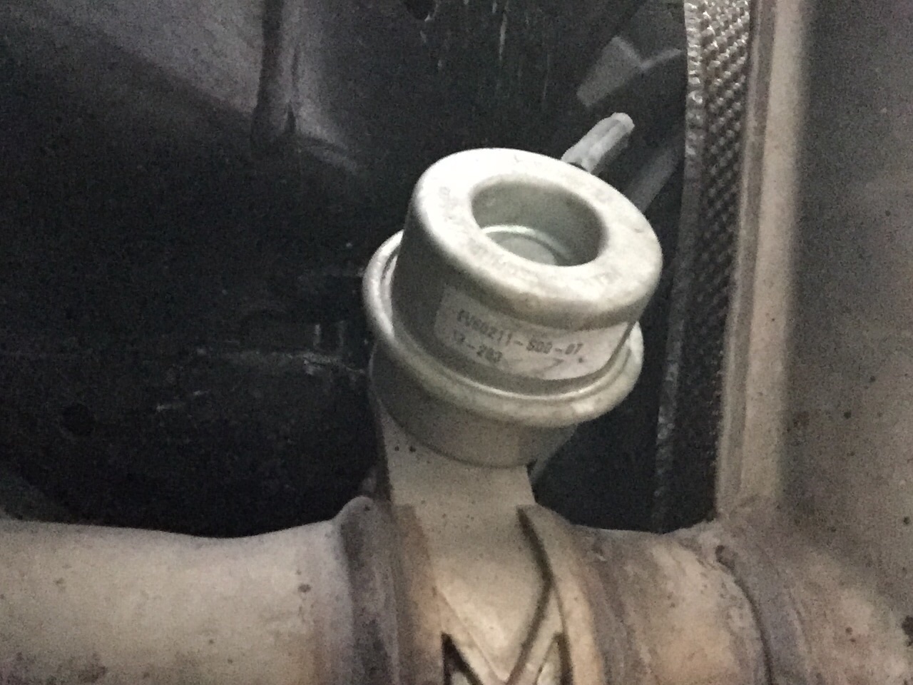

Originally Posted by F-typical
Okay. There may be market-specific differences, but the UK V6S comes with the exhaust as standard and the switch as an option. The price you quote suggests that this is what you have too, but to be sure, you'll need to look just in front of the exhaust back box to see if you have the valves or not.
Thanks for the help. I have been under the car but am just ignorant of what I am looking for. Looks like a bunch of pipes to me! Can you post a photo?
Old Oct 26, 2014 | 05:04 PM
  #50
Foosh's Avatar
Joined: Jul 2014
Posts: 6,176
Likes: 1,039
From: Maryland, USA
Neither F-Typical, nor I have active exhaust on our base cars, so I can't snap a shot for you. However, what you're looking for on the muffler box is a little canister on each side with a rod attached, which opens and closes valves on each side. That will tell you you have active exhaust.
Both U.S. and U.K. cars come with active exhaust standard on all S and R models. However, the switch that allows you to manually open and close the valves is optional on some, depending upon which option packages were ordered. My guess is you have it, but just don't have the manual control switch.
I do recall seeing a picture of the valves on the this website somewhere, but don't have time for a search right now.
Thanks for the information! Is this what you are describing?
Old Oct 27, 2014 | 01:43 PM
  #52
Foosh's Avatar
Joined: Jul 2014
Posts: 6,176
Likes: 1,039
From: Maryland, USA
Yes, that's it.
