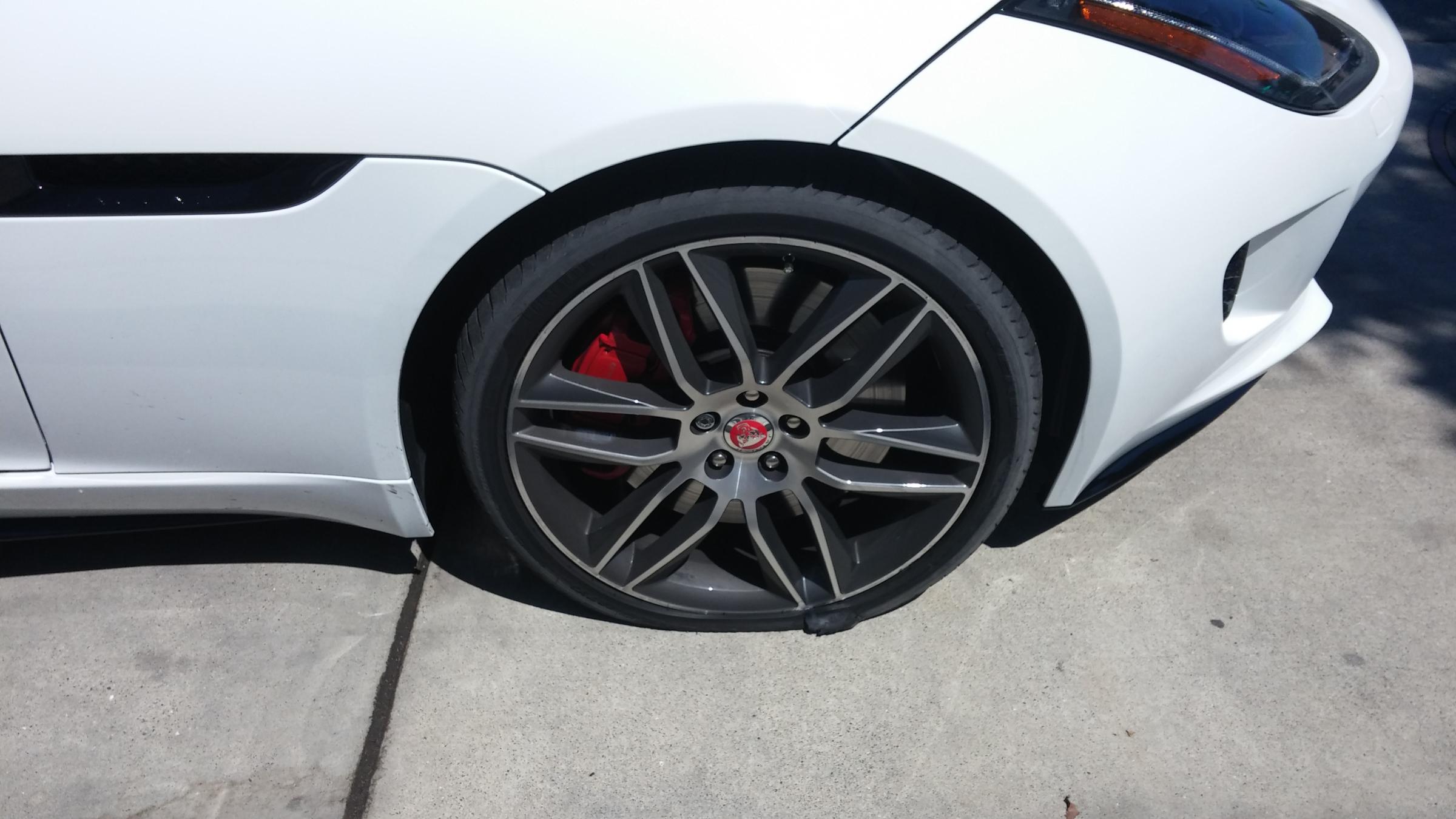

Not my best day. The car was dirty from my track event on Friday. Plan was to get it detailed Monday but I just couldn't stand looking at all the dirt/dust so did a quick hose down. Then took her on the freeway to air dry.
Doing about 60-65mph in the right land as I'm about to merge into another freeway to get back to downtown SF (101/280 merge for those in the Bay Area). See some debris on the left side of the lane. It looked like a large, flat cardboard box. If it was just a flatten cardboard box I could drive over it and no big deal. But I wasn't sure. Maybe it was not cardboard, maybe metal or wood.
Didn't want to damage the front fascia. Didn't want to slam on the brakes, maybe causing guy behind to rear end me. Didn't want to move to the left, getting hit on the left side or swiping across the debris. So I moved half over to the shoulder. I missed the debris, but the shoulder was rough. I think the unevenness of the shoulder or some debris in the shoulder ended up cutting the two right tires. I hear a pop and the tire pressure warning went off. Game over.
Tires are obviously done for. But looks like there's also damage to the front right wheel. The back right wheel looks like it might be OK, at least from cosmetic POV.
Some questions if you've had to deal with this before:
1. Anybody know how much the OEM 20" Gyrodine Black wheels cost?
2. Anybody have experience like this with insurance? I know insurance won't cover flats and cosmetic damages but I view this as basically an accident. Wondering if they'll cover this, whether it's worth the deductible/potential rate increase?
3. Anybody go with different tires than OEM?
Any other thoughts?
The irony, was so worried about damaging the car at the track event...no issues there, didn't need track insurance. Then I hope on the freeway for 10 minutes and this. Well, I suppose the bright side is no bodily injuries or anything serious. And maybe get some aftermarket wheels since I wasn't a huge fan of the Gyrodine in the first place...
Attached Thumbnails tire/wheel questions: 2 blown tires, damaged wheels-2014-08-24-11.52.07.jpg   tire/wheel questions: 2 blown tires, damaged wheels-2014-08-24-11.52.12.jpg

Wheels don't look too bad. A good wheel repair shop should be able to make them good as new.

Sucks, glad you are safe--- OK as mentioned above the front wheel is probably ok- its a one piece cast big hunk of metal that appears to only have sustained cosmetic damage. Most wheel repair shops can fix that.
As for tires since your car is pretty new, I would stick with the same brand to match the left side. But if you are considering a 4 tire swap then personally I would go with Michelin PSS tires and maybe even a 305x30x20 in the rear on the 10.5 wheel. The PSS tire is just so good.
Hope you're right. My fear is the front right, where there's the tear on the sidewall, there's some metal missing. It won't show when new tires are put on but probably not safe.

Glad you're ok man, did you end up having to get a tow? Yea, hopefully you can have your wheels repaired and agree with Vic, I'd go wider (305) with Michelin PSS tire.
You guys don't think a 315 would fit back there? Probably not..
I will probably go with PSS, all the reviews seem to have them much better than the PZero. Will do some more investigation on wider.

315 would fit but you would have sidewall over hang with the 10.5 inch wheel. I changed my M6 tires from the 295x30 to 305x30 (both PSS) on the oem wheels for a short moment (when I had the car) and that worked well.
seems like
255/35-20
305/30-20
is the way to go? Hopefully the dealer has some special supply, because for the life of me I can't understand why they're all backed order/special order at tirerack. kind of silly if I have to wait a coupe of months for tires!

You should look up a wheel repair shop in your area.
There is a company in orlando that I work with very often, they have been able to successfully repair wheels that split in half.
You would be surprised with what can be done with aluminum.
From the photos I would say your wheels will be fine maybe lightly bent with any luck they will balance out perfectly.
