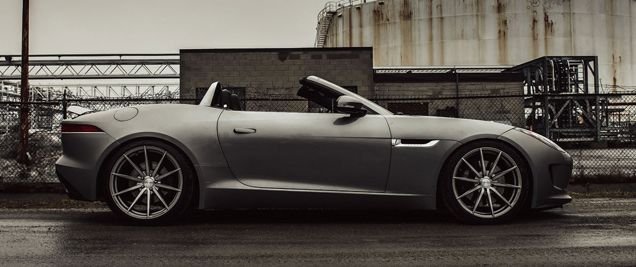

I have a 2017 Premium coupe, and I am want to change my wheels/tires. I have been in contact with Rohana Wheels, and they recommend the following for an F-Type: 20x9 +40 offset and 20x11 +28 offset, with 5x108 holes. The recommended tires are 255/35/20 and 285/30/20. They say that no spacers are needed. Before I buy these, I want to be sure they will fit. Any help is appreciated. I have included a picture from their website with these wheels/tires on an F-Type.

Those sizes and offsets will fit great. However I would run a 295/30 in the rear.

+1 Exactly

those are perfect without spacers, but like he said ^^^^ bigger back tire!
